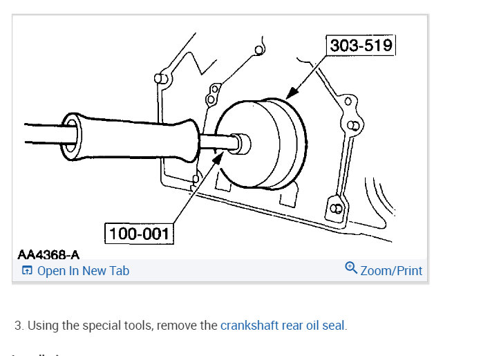

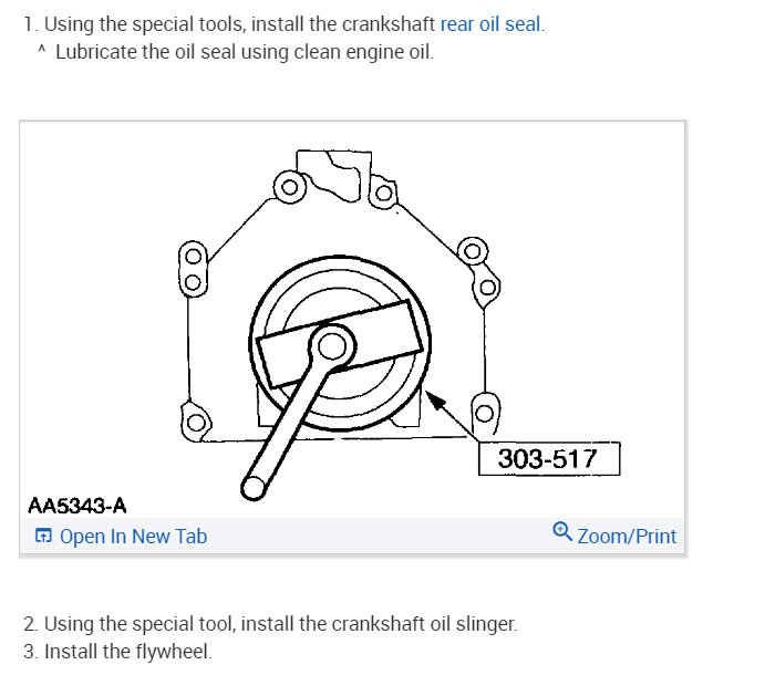

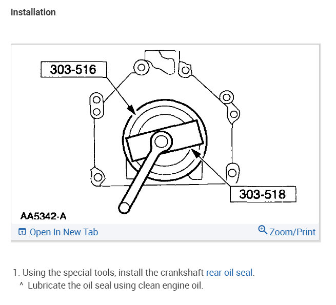

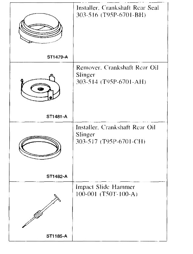

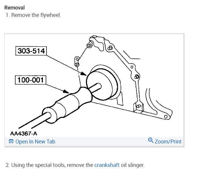

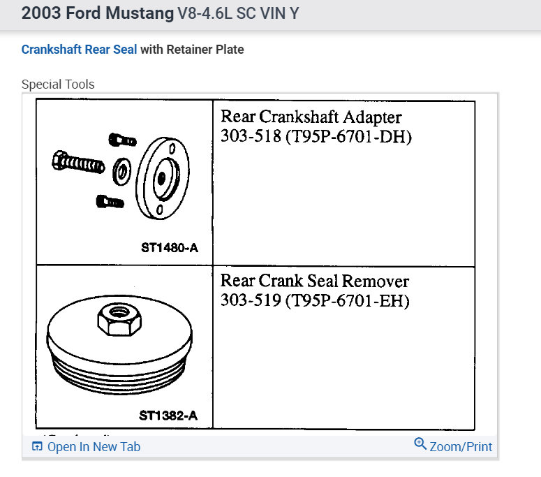

Some seals are designed without an oil seal retainer, which is why you can't find one. Here is a guide that can help you do the repair:
https://www.2carpros.com/articles/crankshaft-main-seal-replacement-rear
and
https://youtu.be/JpzefqEeVGE
Here are the replacement instructions from the repair manual. Check out the diagrams (below). Let us know what happens and please upload pictures or videos of the problem.
