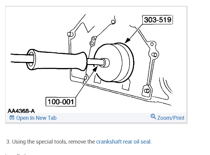

I just replaced my rear main seal and when I bought a new one it didn’t come with the retainer which I removed from the crankshaft when replacing it. The retainer slides on after the rear main seal and I need to know if I can reuse mine or if I have to get a new one, but I can’t find anything for this part online. I was wondering where I could find this part.

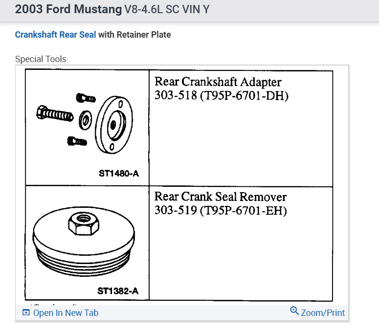

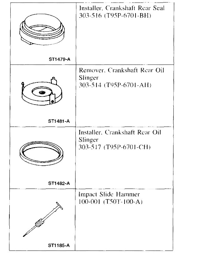

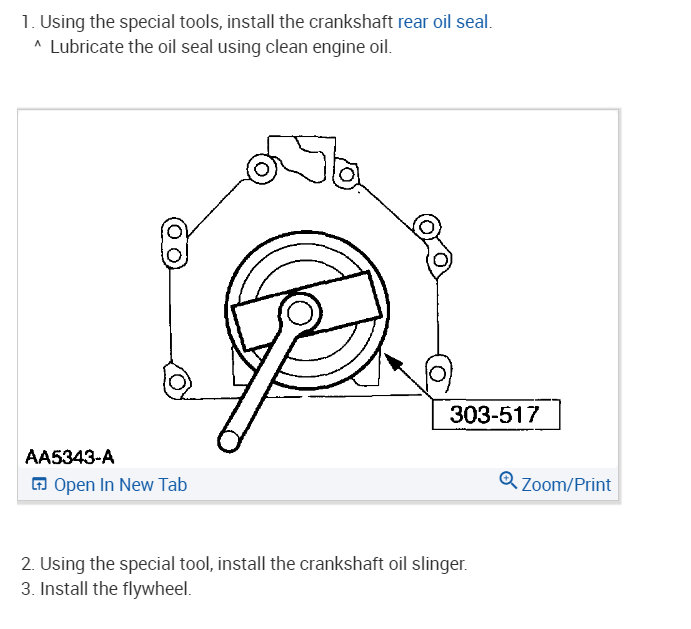

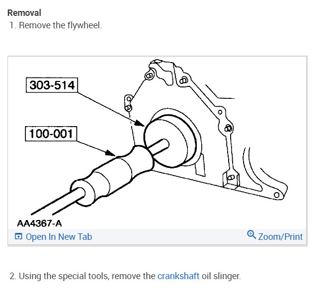

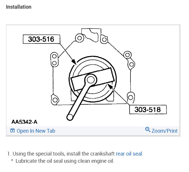

Some seals are designed without an oil seal retainer, which is why you can't find one. Here is a guide that can help you do the repair:
https://www.2carpros.com/articles/crankshaft-main-seal-replacement-rear
and
https://youtu.be/JpzefqEeVGE
Here are the replacement instructions from the repair manual. Check out the diagrams (below). Let us know what happens and please upload pictures or videos of the problem.
