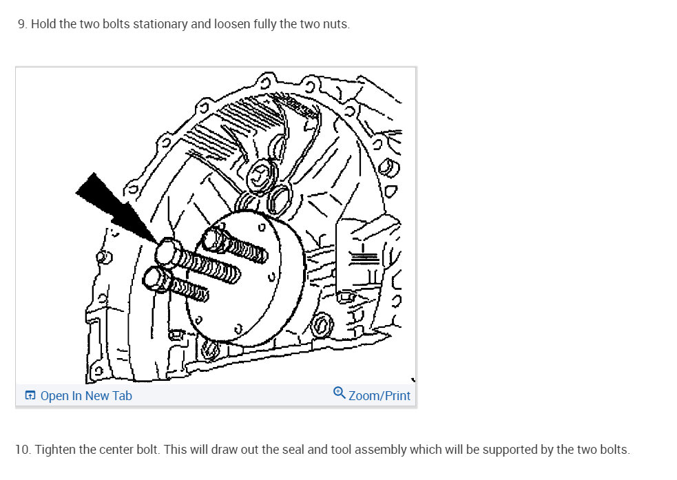

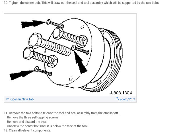

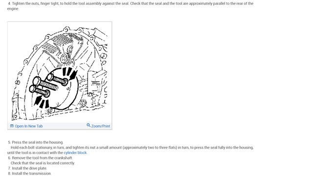

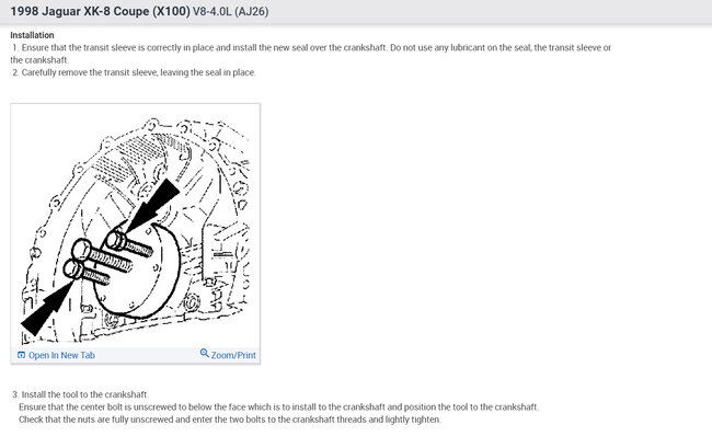

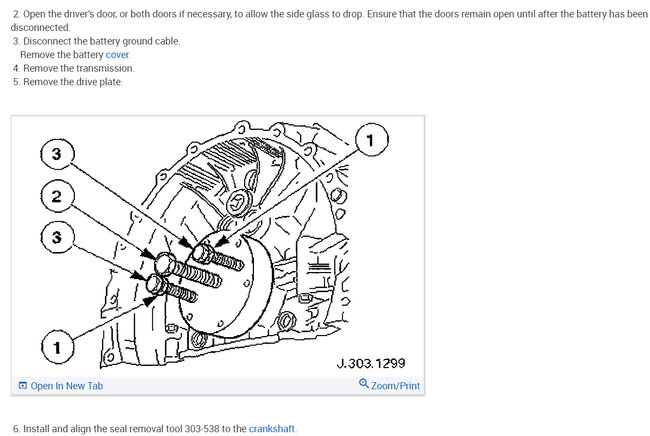

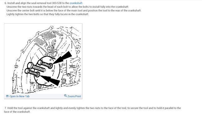

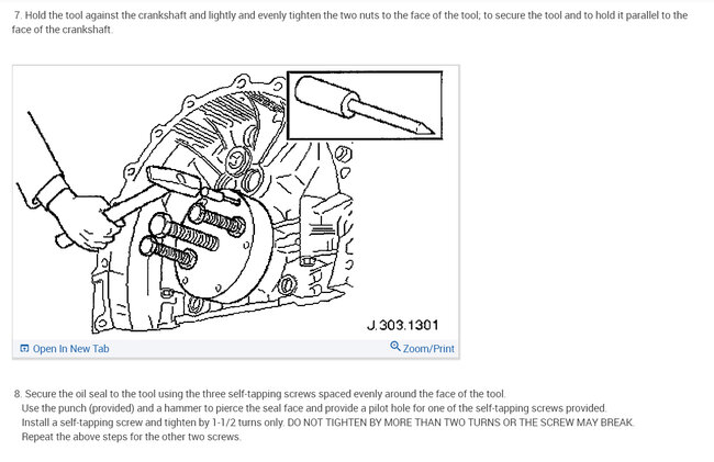

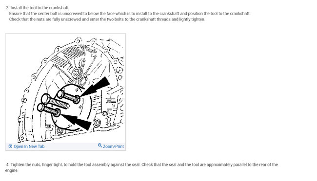

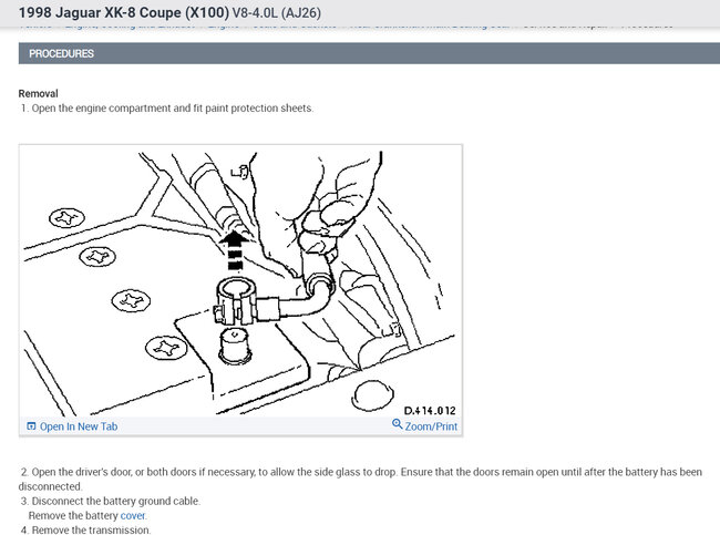

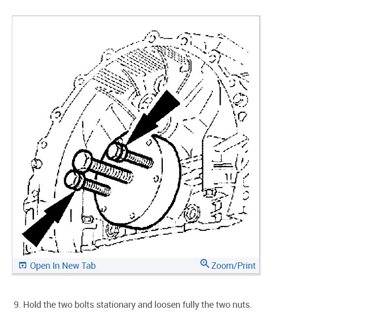

Yep, it sounds like the rear main seal popped out of the housing. Here are the instructions on how to change the rear main seal once the transmission is removed in the images below. Please check out this guide:
https://www.2carpros.com/articles/engine-is-leaking-oil
Let us know what happens and please upload pictures or videos of the problem so we can see what's going on.

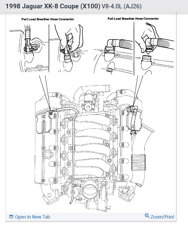

Removed the transmission and saw the seal behind the flywheel barely in, removed it by hand. Looks good still without any tears. Can you think of any reason how this could have happened?
May 13, 2023 at 5:17 AM
  • 55,721 POSTS
Sometimes they just pop out but I would check the crankcase ventilation system. Check out the images (below). Please let us know what happens.
