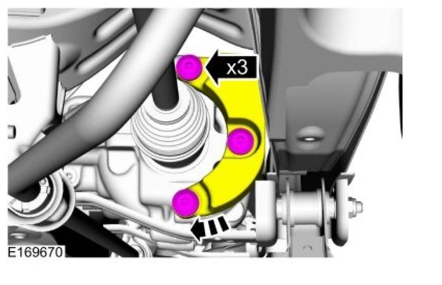

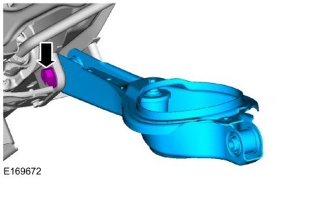

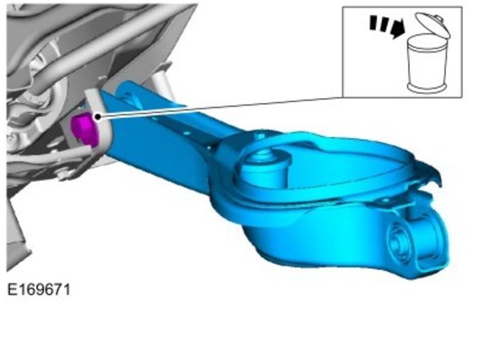

Wife drove off edge of driveway and bent just the rear lower control arm is it straight up removing both end and replacing,with a alignment after, or is there a hitch?
Jul 19, 2017 at 12:17 PM
CARADIODOC
  • 34,377 POSTS
There are two rear lower control arms on each side, and both have rubber bushings on each end. Once you have the new arm installed, do not tighten the bolts until the vehicle is sitting on the tires and at normal ride height. If you tighten the bolts while the car is jacked up and the suspension system is hanging down, the bushings will be clamped in a permanent twist. That will greatly shorten their life.
Jul 19, 2017 at 12:29 PM
CLAIRE STOKES
Thank you, it was the drivers side.
Jul 19, 2017 at 12:51 PM
  • 55,381 POSTS

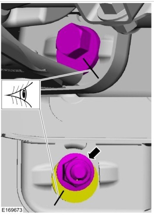

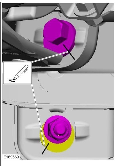

There is an alignment bolt that must be marked and put back in the same place and you should be okay.
Here is a guide and some diagrams (below) that will help you get an idea on what you are in for when doing the job.
You will need to use a jack to lower the tension from the arm.
