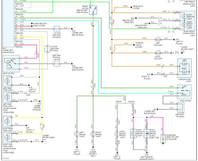

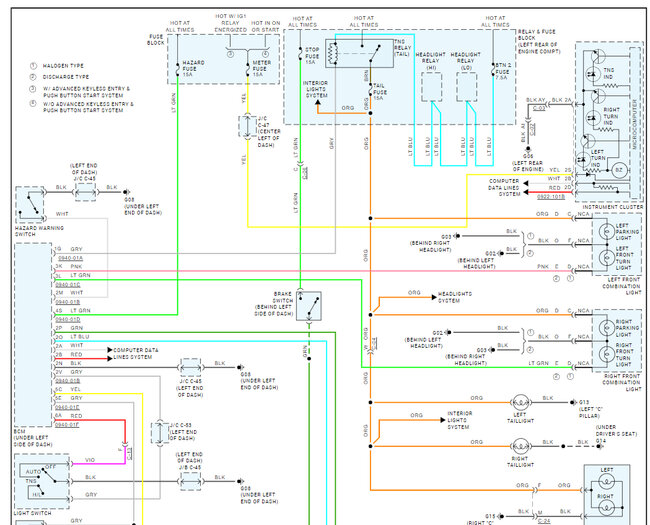

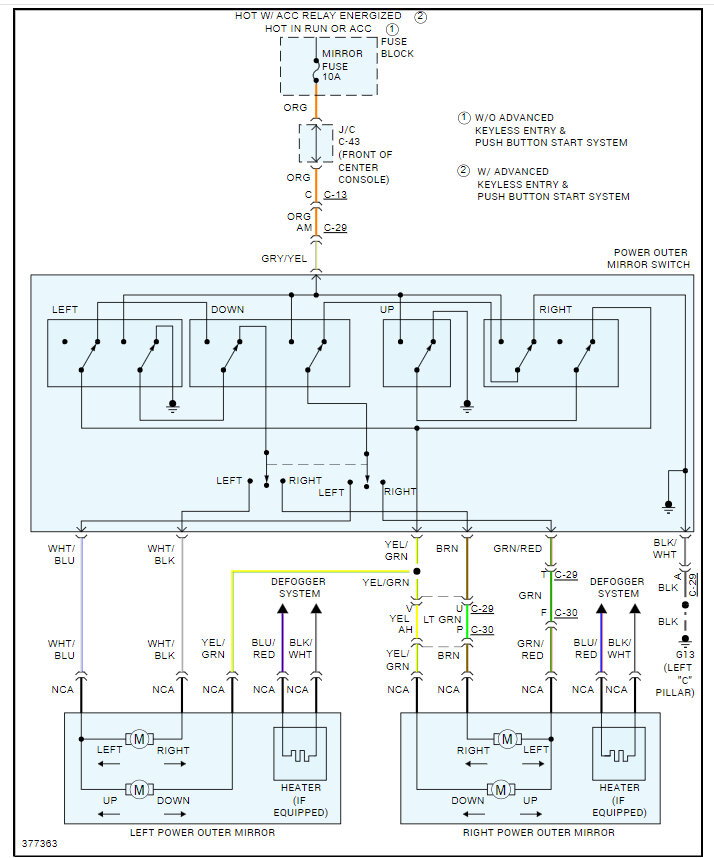

I need an electrical diagram for one project this summer in my 2012 Mazda 3.
Diagram for:
1) Rear lights (the back of the car).
2) Rear viewer mirrors (heated and turn signal lights).
Thank you

Sure, here are the wiring diagrams for the rear tail and brake lights and the side view mirrors, I am not sure what you mean by the heated rear mirror with turn signals? Can you please clarify? Check out the images (below). Let us know if you need anything else.

Thank you very much.
It’s all what I need.
