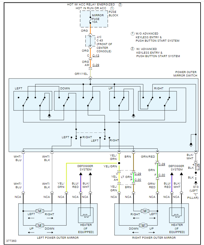

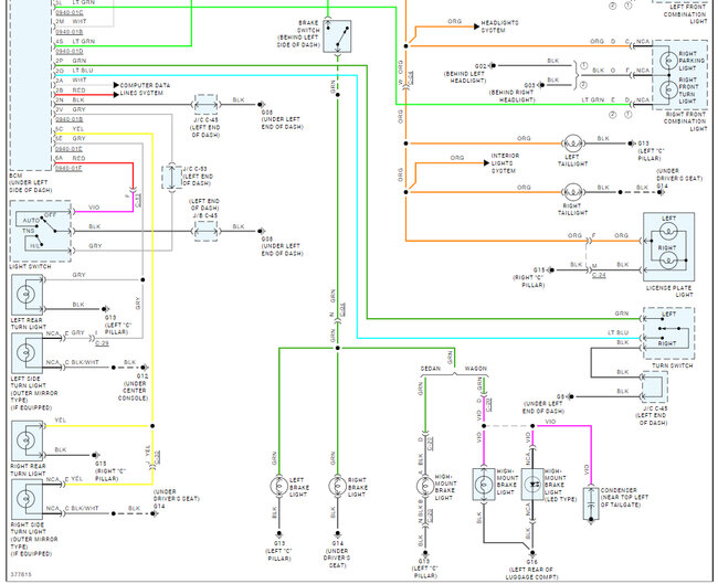

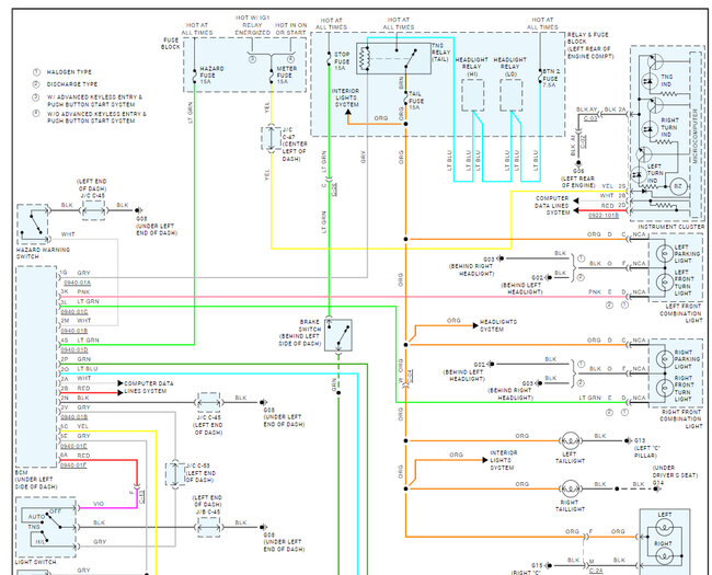

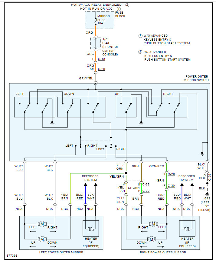

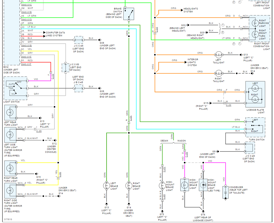

I need an electrical diagram for one project this summer in my 2012 Mazda 3.
Diagram for:
1) Rear lights (the back of the car).
2) Rear viewer mirrors (heated and turn signal lights).
Thank you
Jun 7, 2024 at 4:12 PM
  • 55,423 POSTS
Sure, here are the wiring diagrams for the rear tail and brake lights and the side view mirrors, I am not sure what you mean by the heated rear mirror with turn signals? Can you please clarify? Check out the images (below). Let us know if you need anything else.
