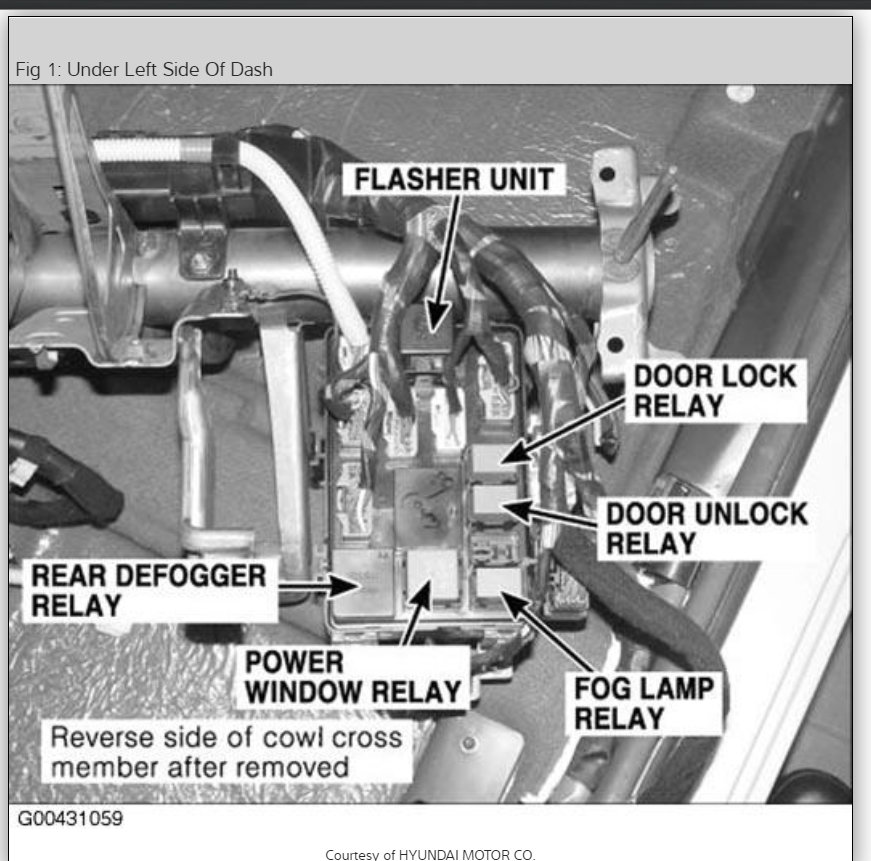

All lights on the rear of car not working, fuses are alright?
May 26, 2019 at 2:16 AM
  • 55,443 POSTS

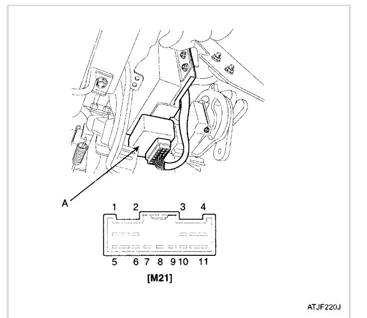

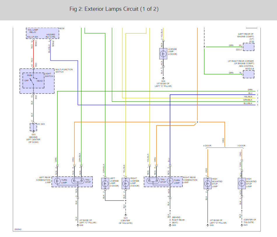

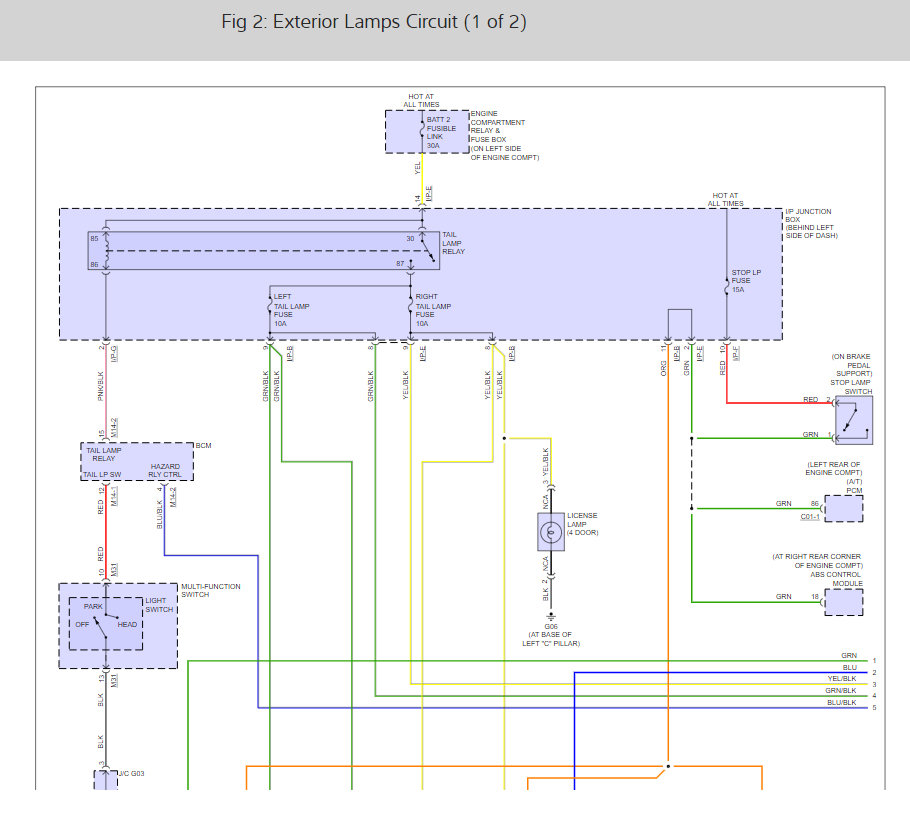

It sounds like you have a tail light relay (flasher) that is not working. To be sure here is a guide to help you and the running light wiring diagrams so you can see how the system works and the relay location as well. There is also a fusible at the battery I would check.
