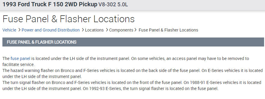

Is your turn signal still functional?
You could have some type of wiring issue.
Have checked to see if your flasher relay functional?
You might have to check the wires to see if there is any type of issues with them.
https://youtu.be/Hlna_kUt7As
https://www.2carpros.com/articles/turn-signals-blink-rapidly

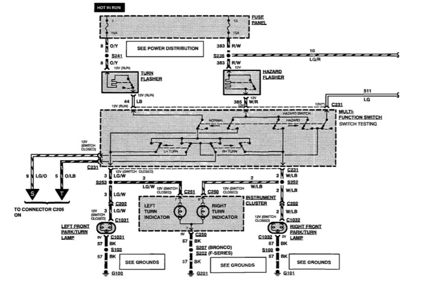

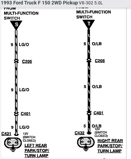

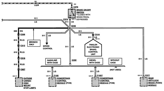

I have attached the complete wiring for the hazard and lights.
Let me know if you have any questions.

Since you have replaced just about all the parts and still nothing it is more than likely a wiring issue.
Finding a bad wire in a car wiring harness often requires testing with a volt ohm meter.
It does take a little bit of time to getting used to. Knowing where to look and what to look for is critical.
