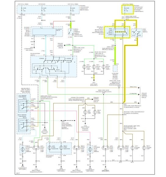

My blinkers are not working but my front ones are. My third light doesn’t work at all.
Jul 29, 2019 at 1:22 AM
Good morning,
I attached a wiring diagram for you to view. You will need to do some checks for power at the turn signal switch and the fuse block.

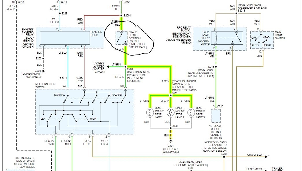

I attached one of the diagrams for the third light. Check for power on both sides of the switch on the brake pedal on the color wires listed.

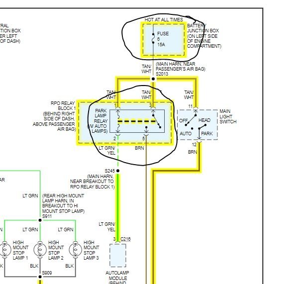

The other is for the running lights. Check the fuse listed for power on both sides. There is a relay for the park lights as well.
