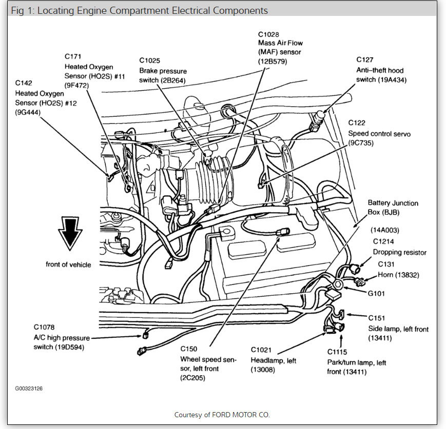

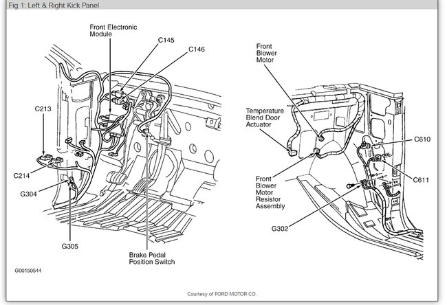

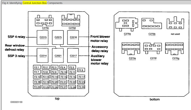

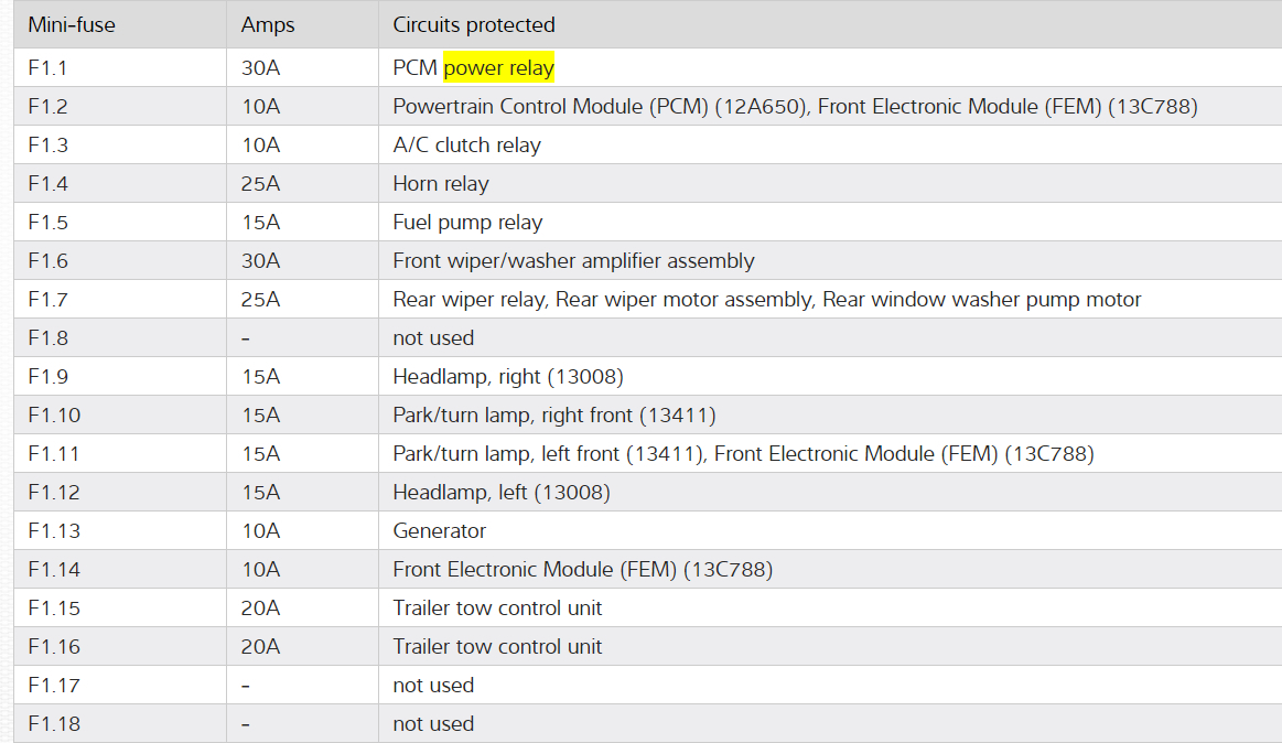

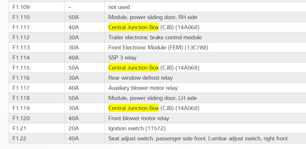

Right rear blinker, left brake light, both replaced bulbs and fuse, still not working. Plus overdrive light flashing an odometer not working. What do I do next?
Dec 19, 2018 at 10:26 AM
  • 55,112 POSTS

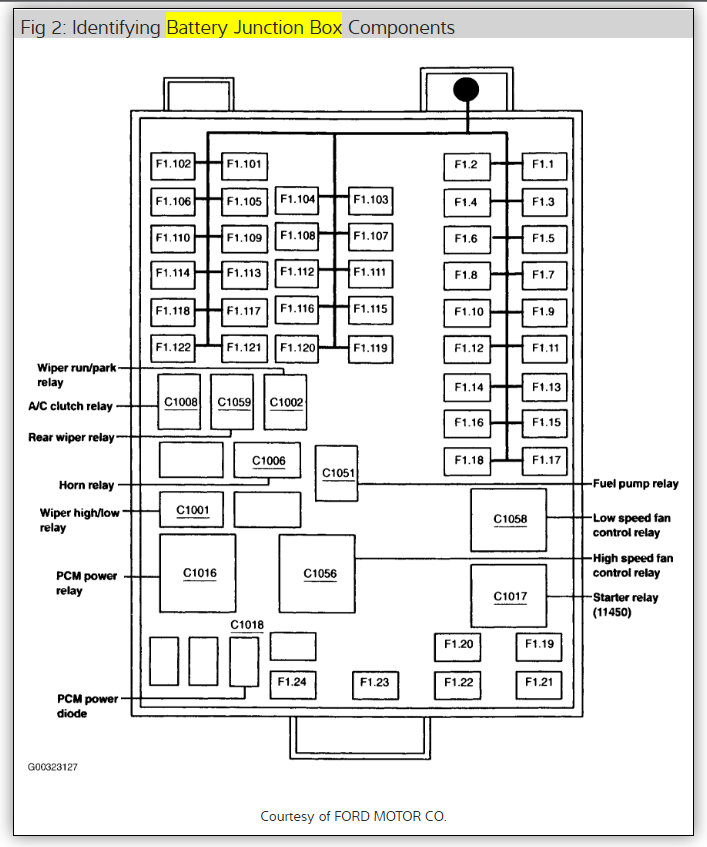

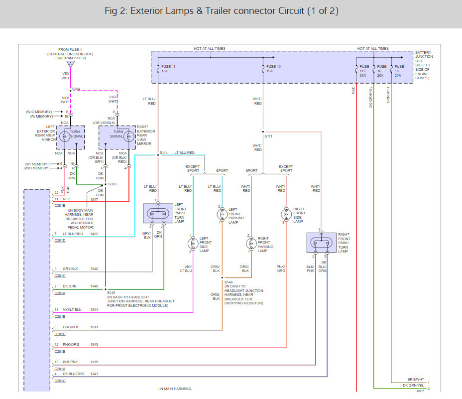

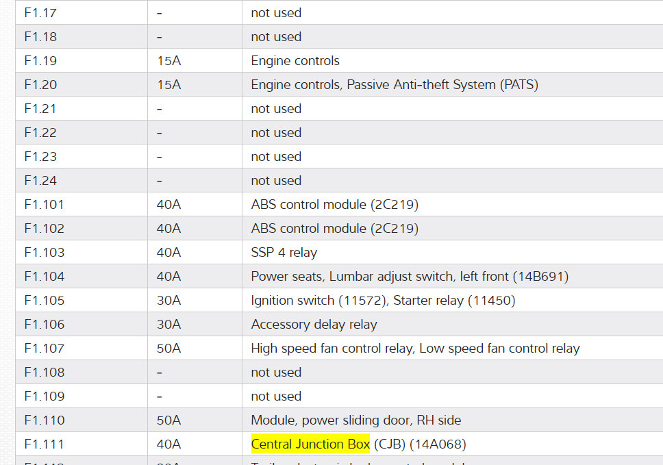

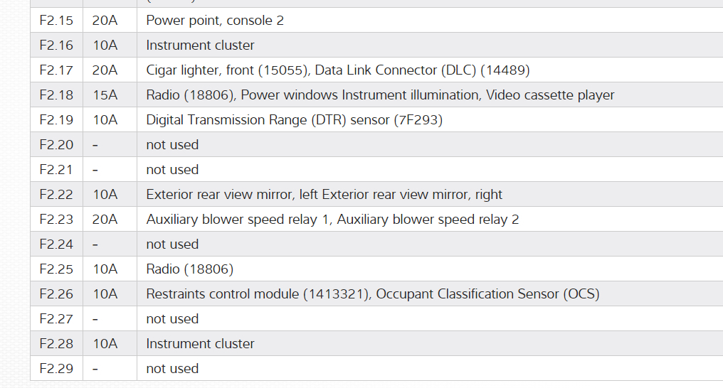

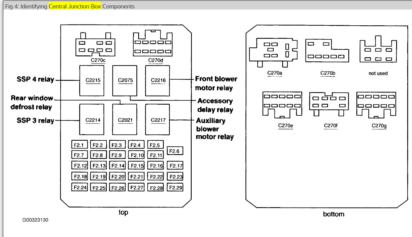

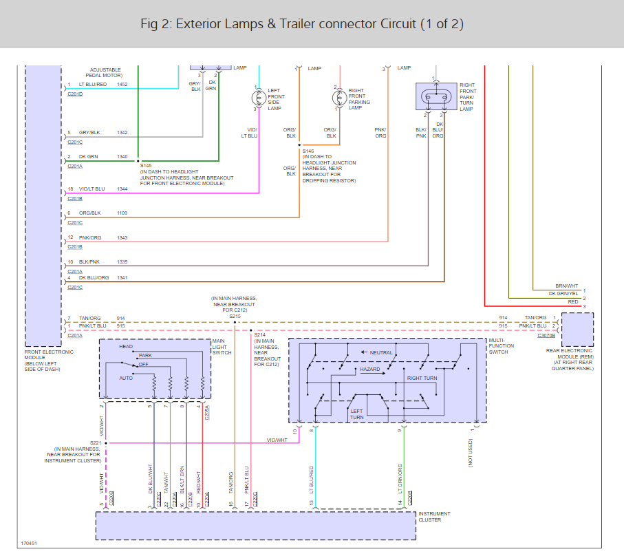

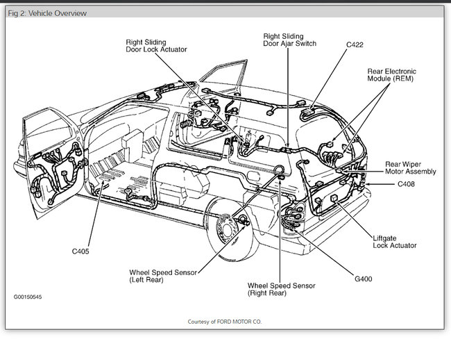

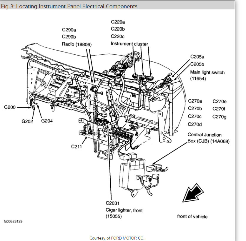

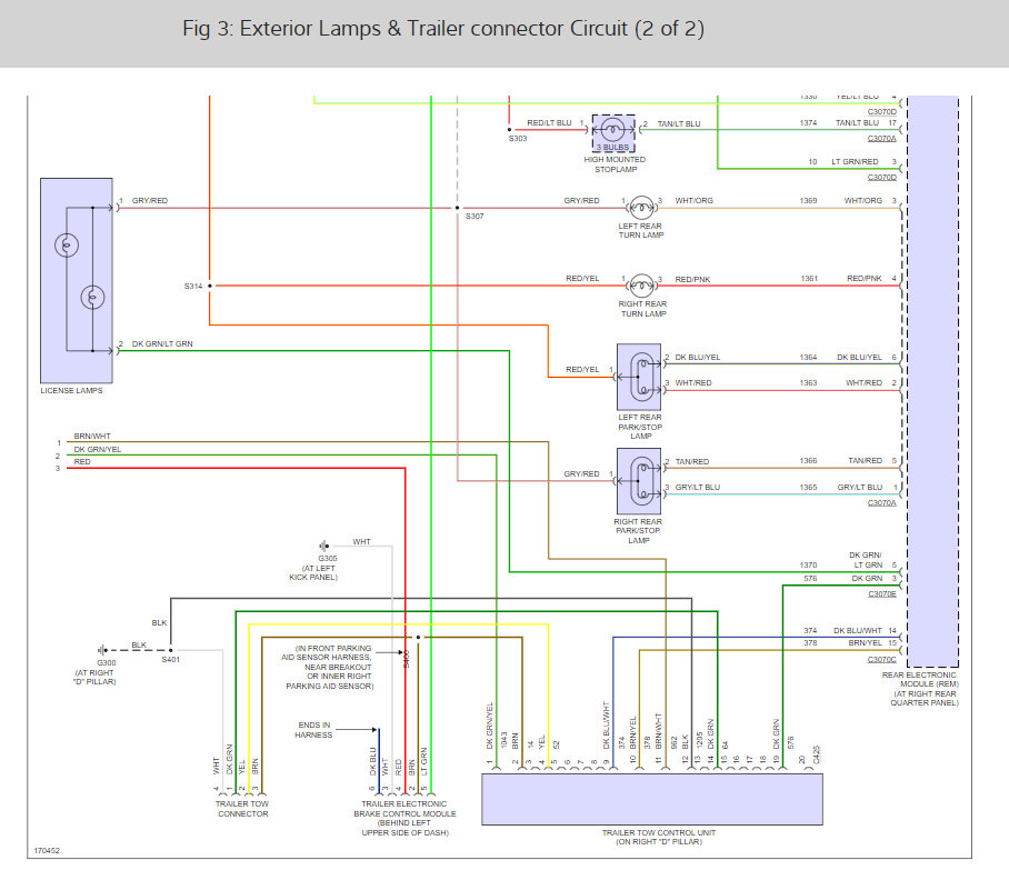

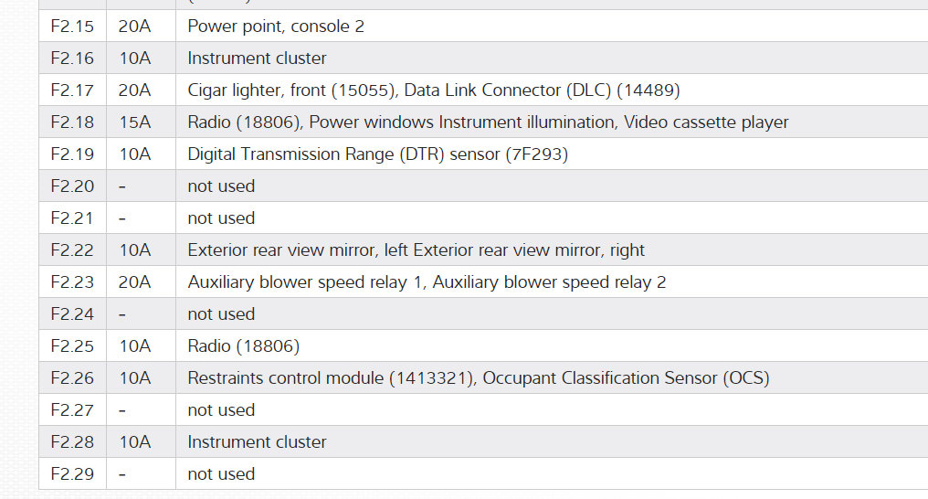

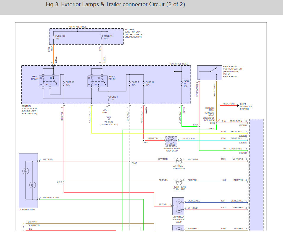

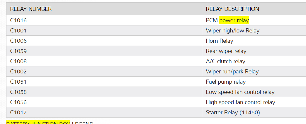

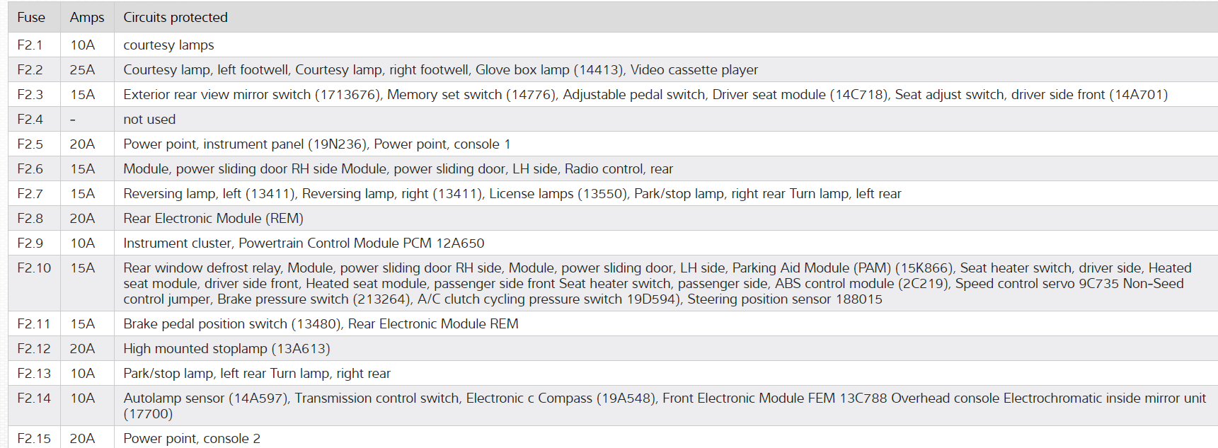

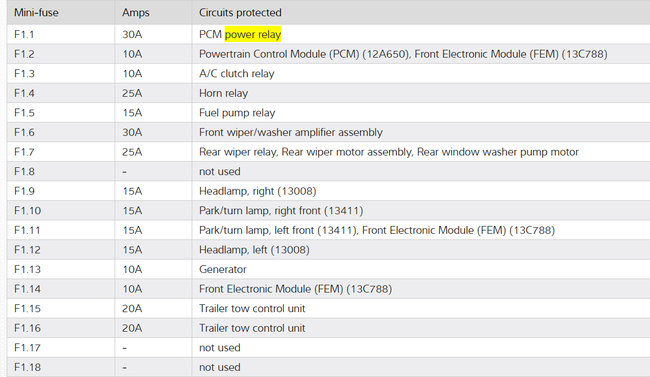

It sounds like either he front or rear electronic module could be out. But let's check the fuses first (11,10,15,16 and 112). Here is a guide to help us check for power and the wiring diagrams for the brake lights so you can see how it works and the fuse and module locations:
Check out the diagrams (below). Please let us know what you find. We are interested to see what it is. Cheers, Ken
