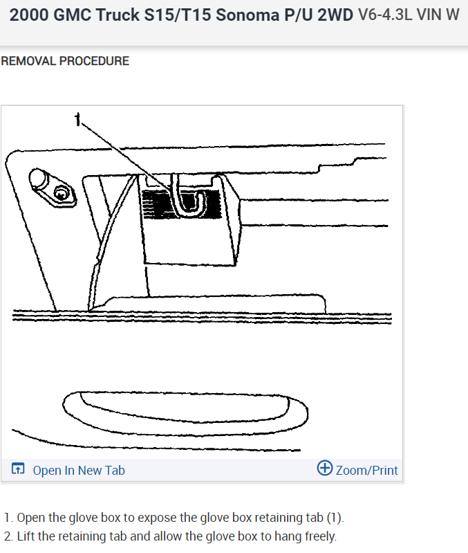

Drivers side brake light doesn't work, blinker flashes fast. All bulbs and fuses are good no loose ground wires and flashers work normal.
Oct 24, 2024 at 3:06 AM
  • 55,711 POSTS

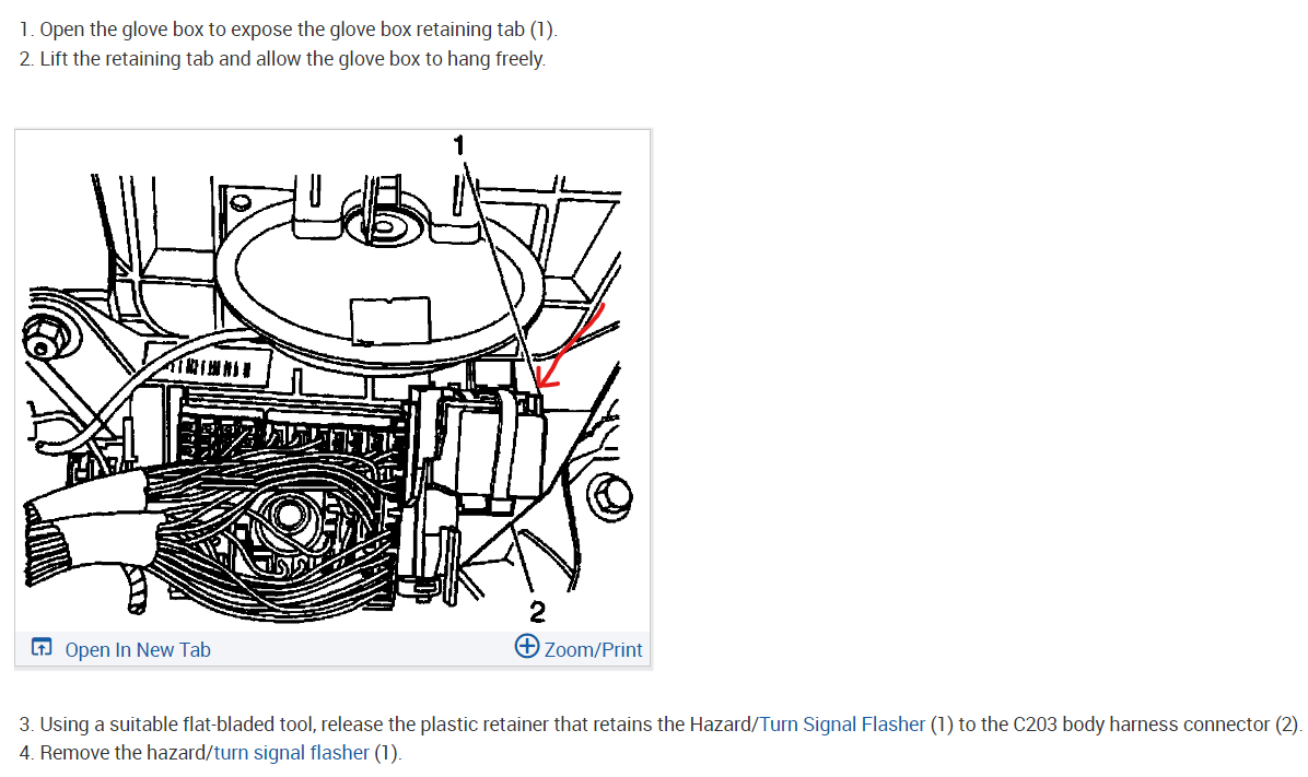

Yep, this happens when the flasher module goes out. here is the location so you can swap it out. Check out the images (below). Please let us know what happens.
Oct 24, 2024 at 4:09 AM
JR. STROHM
Thank you, that fixed it.
