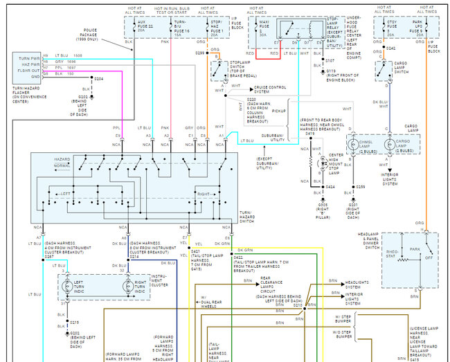

I had installed new headlights about 2 days ago and last night my taillights and brake lights stopped working, I replaced the rear junction box, but it hasn’t fixed the issue. The rear lights work when i use my blinkers and hazards. Any advice?
*Edit*
Pulled the parking light fuse and they started to work again, so I figured it has something to do with the front LED DRLs, still haven’t figured anything else out.

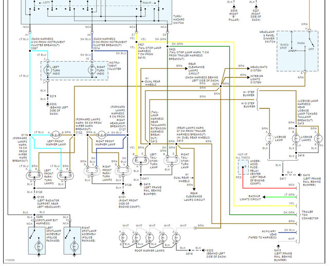

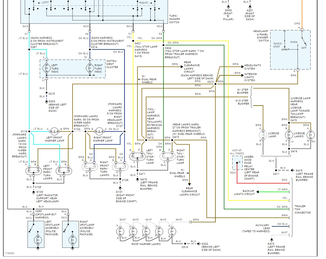

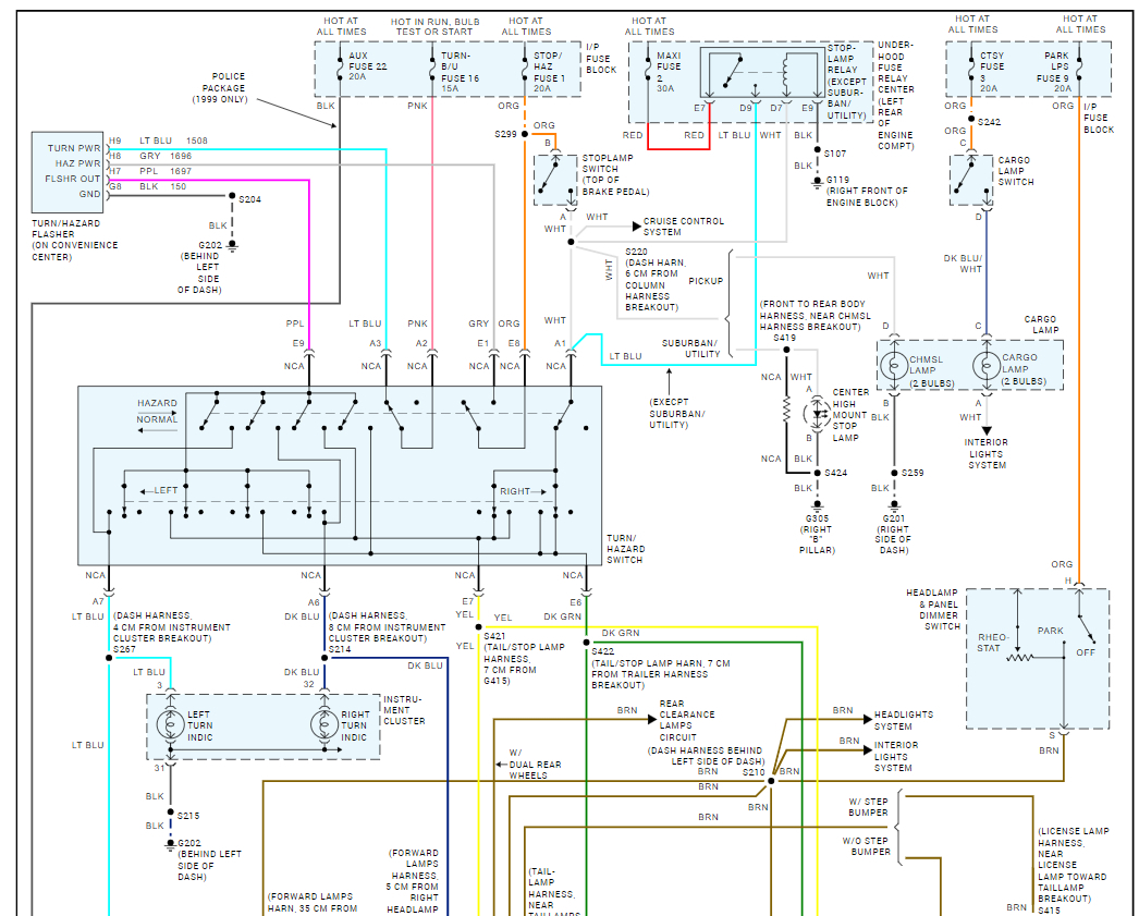

This sounds like the ground at the rear of the truck is bad/off, but we should check the fuses as well. Here is a guide to help you test the fuses and I would check the ground at the left frame rail near the bumper. Here is a guide to help test for power and the tail light and brake light wiring diagrams so you can see how the system works.
These guides can help as well:
https://www.2carpros.com/articles/no-tail-lights-exterior-running-lights-tail-lights-out
and
https://www.2carpros.com/articles/brake-lights-not-working
Check out the images (below). Please upload pictures or videos in your response to the problem so we can see what's going on. You can see what fuses to check with the wiring diagrams below.

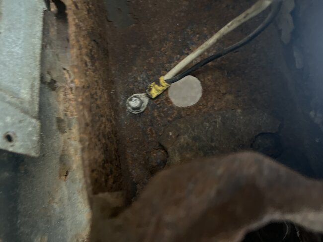

I’ll clean up the mating surfaces good and see if that helps. To me it looks like it’s underpowered or something since my test light lit up on both bulb sockets, one was dim, and the other was bright. I checked all the fuses, and they were all good, for whatever reason the fr park fuse stops them from working.
Feb 22, 2024 at 6:13 AM
  • 55,447 POSTS
That ground looks like it needs to be redone, clean the metal and replace the crimp on connector, also to see if this is the problem use your test light connected to ground on this wire when the brake are depressed, if the test light illuminates the ground is bad.
