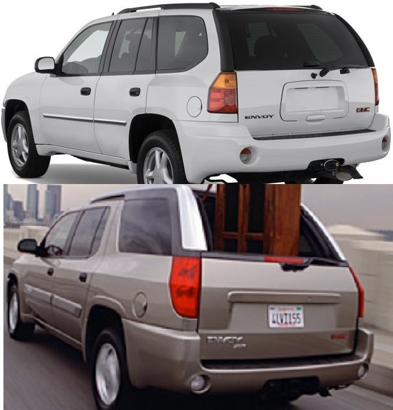

Can I use rear light from Envoy or Trailblazer to Envoy XUV?
it looks similar just turn around 180 degrees and change from right to left.

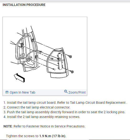

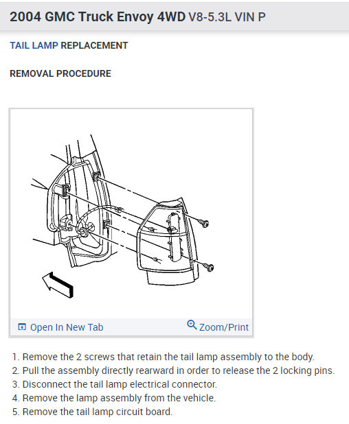

Unfortunately, no they are not interchangeable. You will have to use a replacement taillamp housing for your particular truck. I've attached picture replacement steps below for your GMC. Hope this helps and thanks for using 2CarPros.
