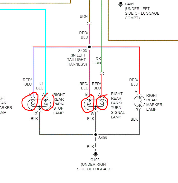

The bulbs are duel element. So, when the parking lights are on, one element is used in the bulb and when you turn the signals or brake lights on, the other element works. As far as the back up lights, that is a separate circuit and bulb system.
If you look at the first pic, I circled the two elements in each light. One is likely burned out in each bulb on the right side.

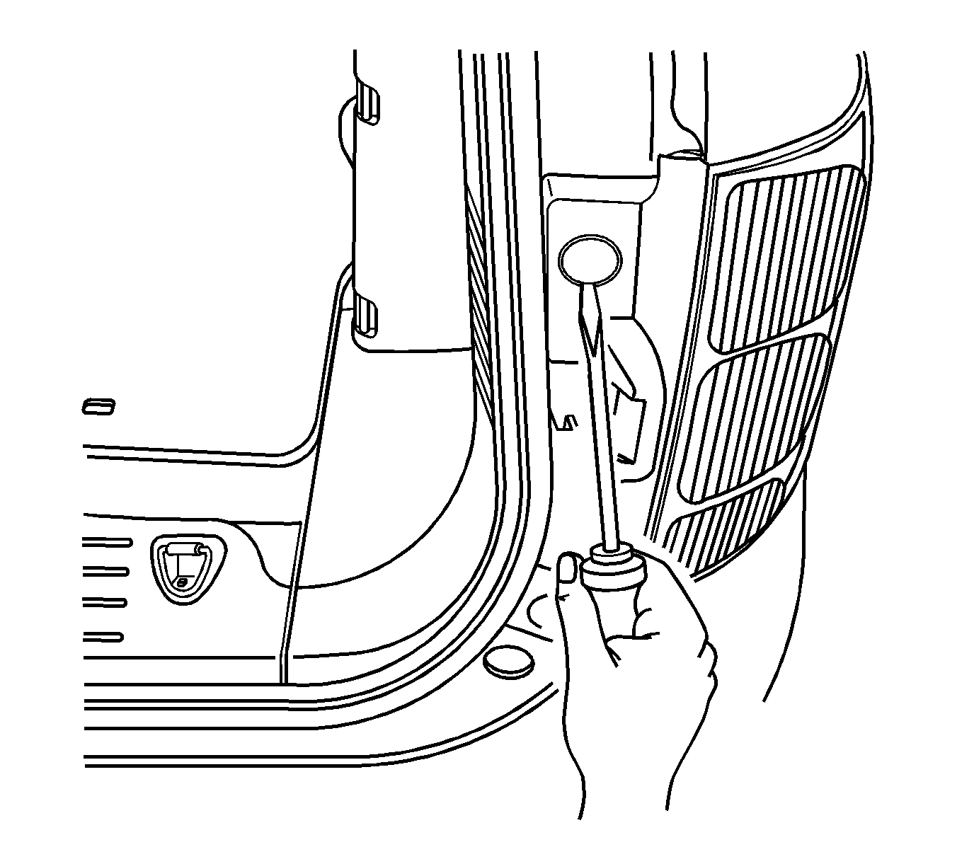

pic 2
1. Remove the tail lamp bolt covers.
pic 3
2. Remove the tail lamp bolts (3).

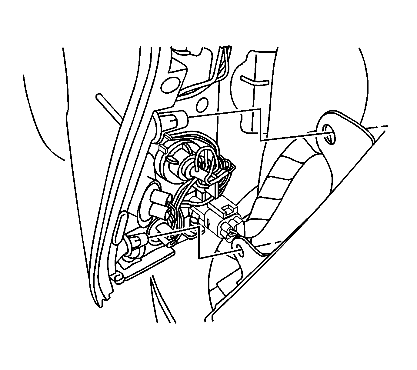

pic 4
3. Pull outward at the front of the tail lamp assembly to disengage the retainers from the body side.
4. Remove the bulbs from the tail lamp assembly.
5. Remove the tail lamp assembly from the vehicle.

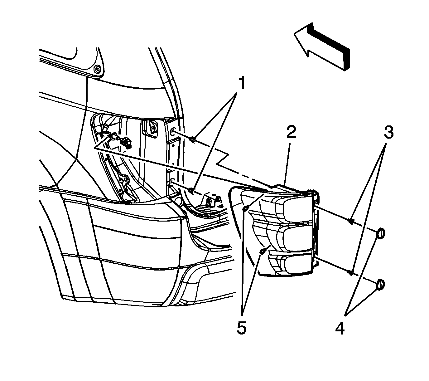

pic 6
4. Install the tail lamp bolts (3).
NOTE: Refer to Fastener Notice in Service Precautions.
Tighten the tail lamp bolts to 2 N.m (18 lb in).
5. Install the tail lamp bolt covers (4).

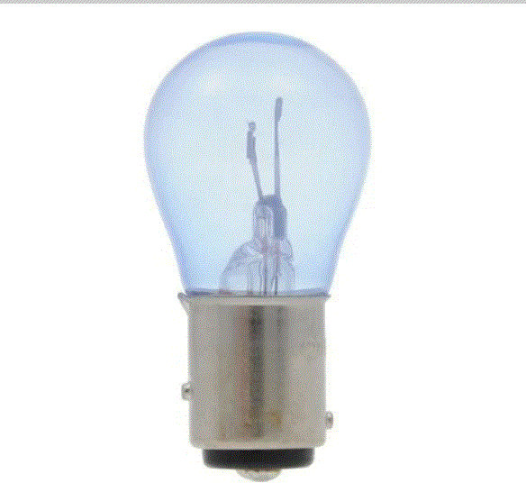

From memory, I believe the bulb you need is a 2057. The last pic shows what it looks like. Take the old one with you to a parts store to get one if your's looks different.
I hope this helps. Let me know if you have questions and if this fixes the issues.

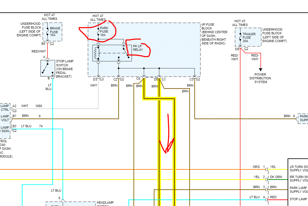

So I double checked all the bulbs and found one bulb to be blown. The bulb that this is would be the side marker bulb. Should this cause the outage on the entire assembly as well?
Apr 14, 2020 at 9:30 AM
  • 110,244 POSTS
It shouldn't. Were you able to check for power to the light sockets or the bulbs themselves? I have to be honest, I have a feeling it is the bulbs. If you look at the attached pic, I circled a fuse, relay and then you will see two wires I highlighted and an arrow pointing down. Note that the fuse and relay send power to both rear parking lights. So, if the fuse or relay was bad, the left side wouldn't work either. The two wires and arrow simply are going to the rear tail lights.
If you can, check to see if there is power to the sockets for the parking lights. If there is, then chances are it is a bulb. If there is no power, then we have to trace the wiring back to the relay.
