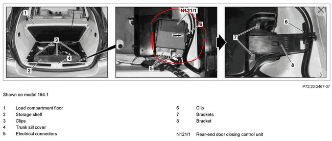

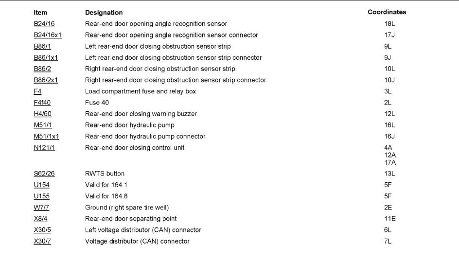

It sounds like the problem could be the rear door control module. I have attached a picture of it. First, locate the component and see if that is where the noise is coming from.
Let me know what you find.

Already looked at that even unplugged everything the noise continued the sound of a relay keeps clicking and lift gate tries to operate even though it is closed.

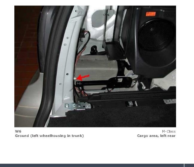

Good afternoon,

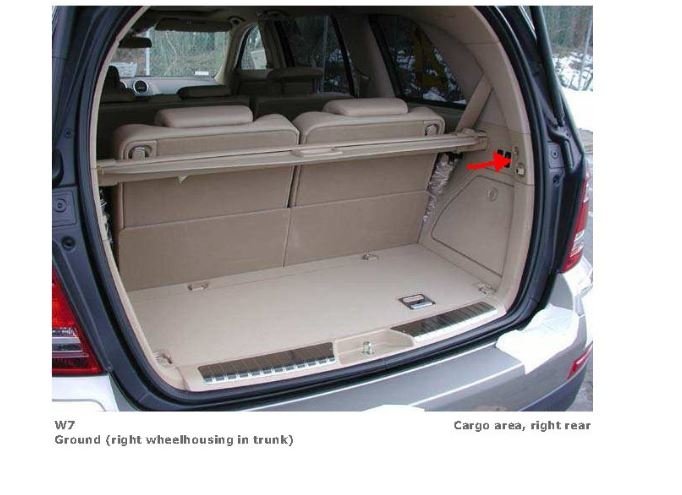

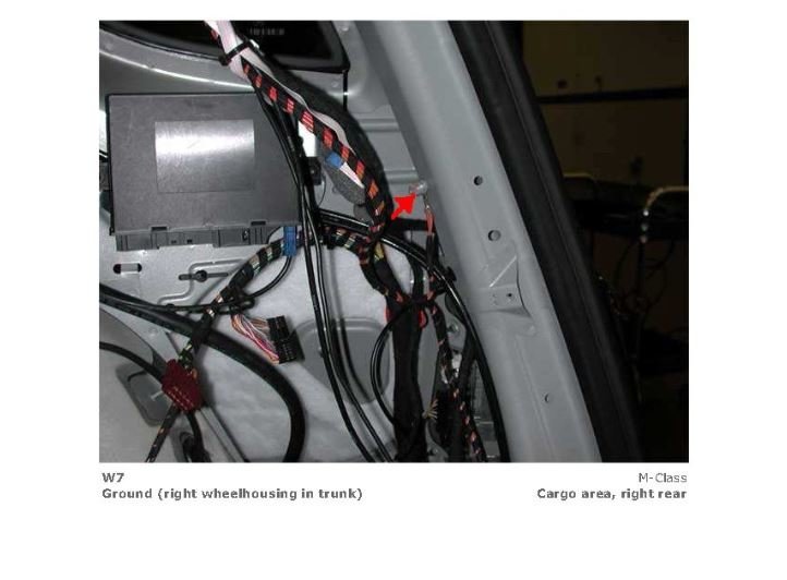

I would start by checking and cleaning up grounds. There are 3 grounds for this system. I attached pictures of them. Clean them with a wire brush and make sure they are tight.
Apr 6, 2020 at 11:47 AM

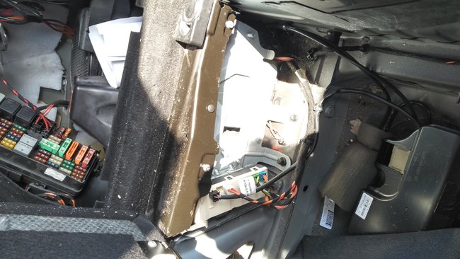

For some reason I have yet to hear it while ripping out the wheel.. hear is a picture of what is by the wheel is that the controller in the middle (white box):
Apr 6, 2020 at 12:35 PM
Yes, that matches the picture Joe posted earlier.
Apr 6, 2020 at 12:40 PM
