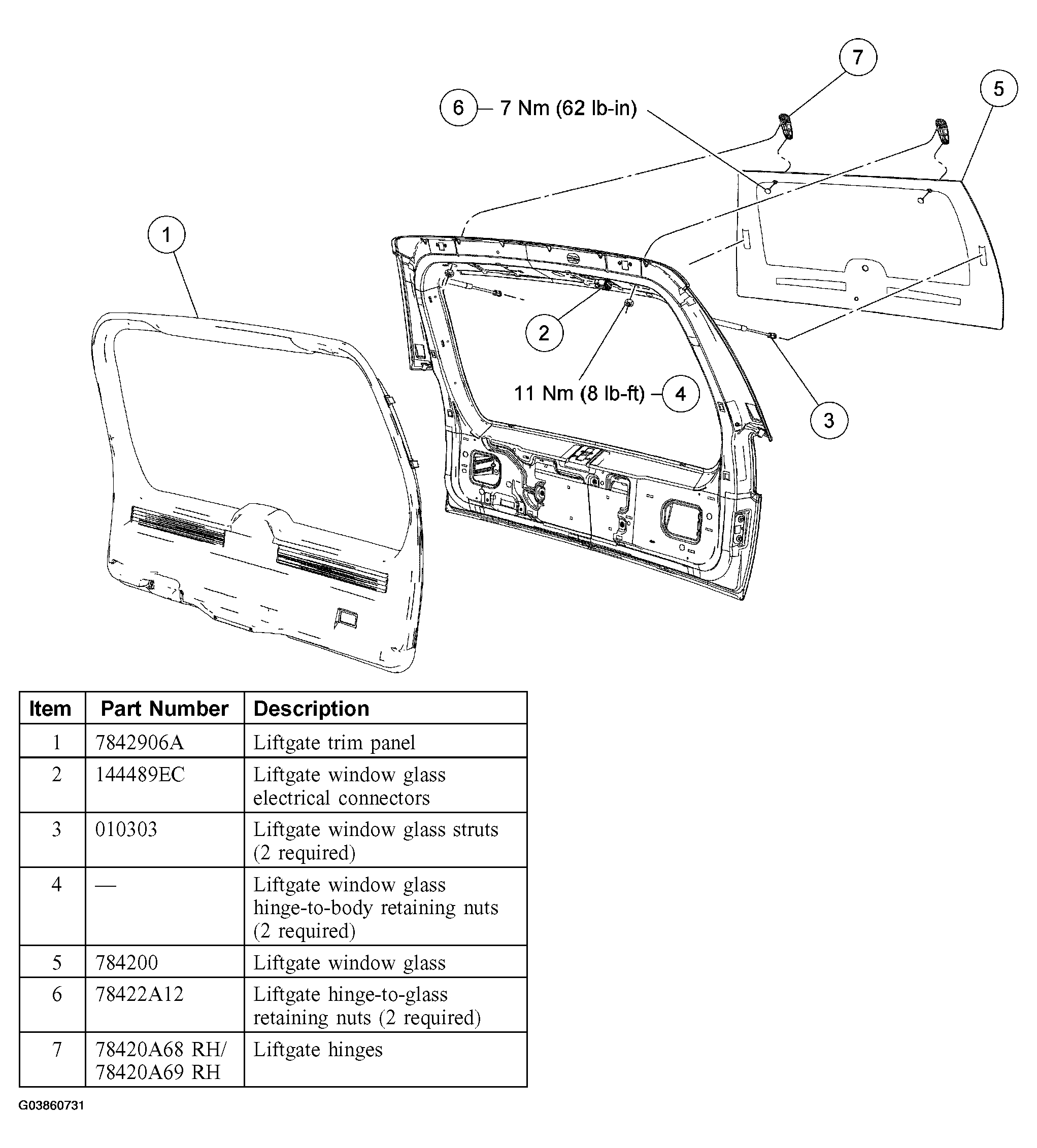

Rear liftgate glass hinge
130,000 MILES • 4.8L • V8 • AWD • AUTOMATIC
LEVIB0530
How is it removed? I do not see a nut or access hole for a socket like they showed in the Explorer video.
Jan 20, 2017 at 6:35 PM
LEVIB0530
It does not have a nut underneath like the Explorer or Mountaineer. It simply unscrews from the top with a socket and the underside of the glass is a T-20 torx bit.
Jan 21, 2017 at 9:00 AM
DOCFIXIT
  • 18,828 POSTS
Bolts are on inside hinge. You need to remove glass or liftgate
Jan 22, 2017 at 5:43 AM
DOCFIXIT
  • 18,828 POSTS
See pic
