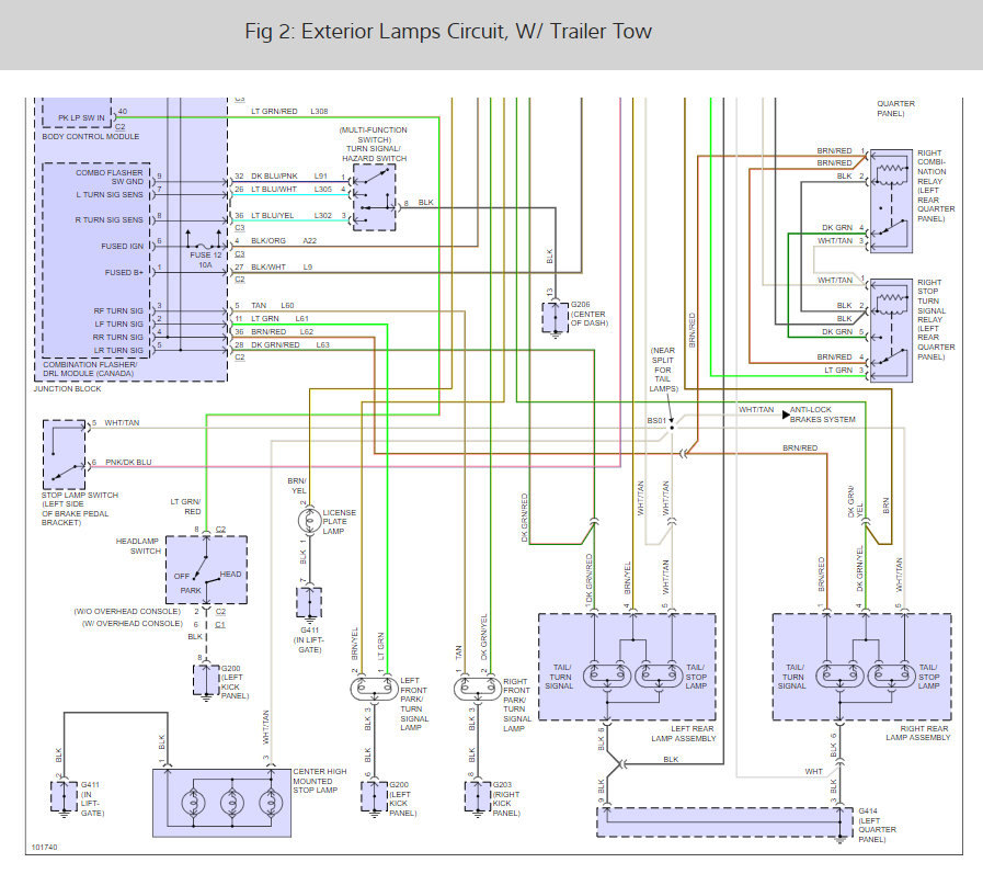

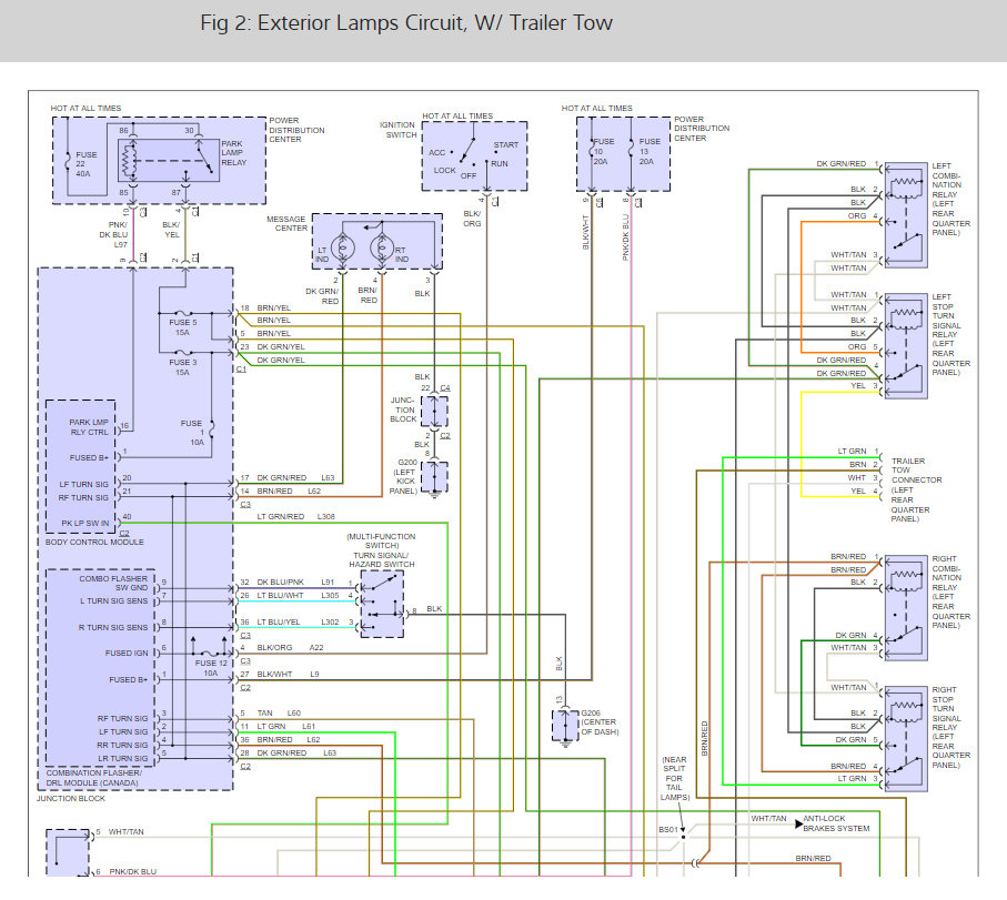

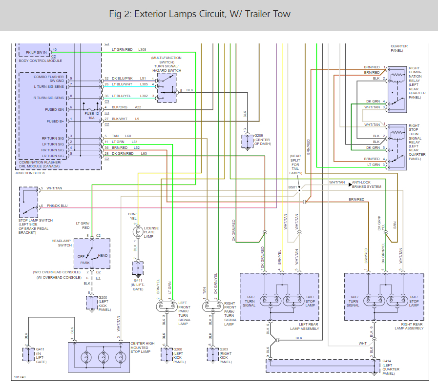

Right turn signal works, hazards work, running lights work. I replaced the bulb, and relay at junction box works. We can hear a relay for the right blinker somewhere behind the left rear light, and hear nothing for the left stop/turn relay. Guessing it is bad, but cannot find anything to show how to access it. Chassis diagram shows this relay is specific to vehicles with tow packages, and is different from the combination relay at the junction box.

There are blinker relays in the rear of the car which sounds like one of them has gone bad. Here is a guide to help you test the relays and wiring diagrams and relay location below:
The relay says it is back by the tail light let me know. Check out the diagrams (below). Please let us know what happens.
