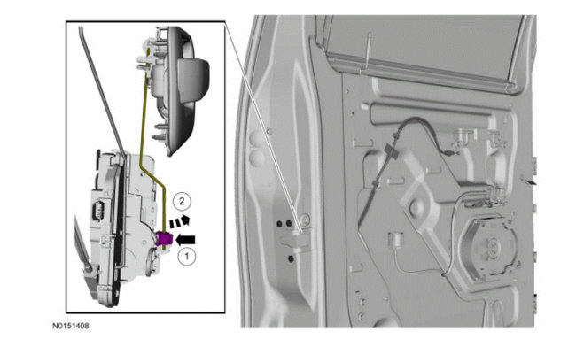

There is a door ajar switch on the latch assembly. Make sure it is connected and tight. I attached a pic of what you are looking for.
Note that the switch may be bad. Confirm by disconnecting the switch and checking continuity through it while actuating it on and off.

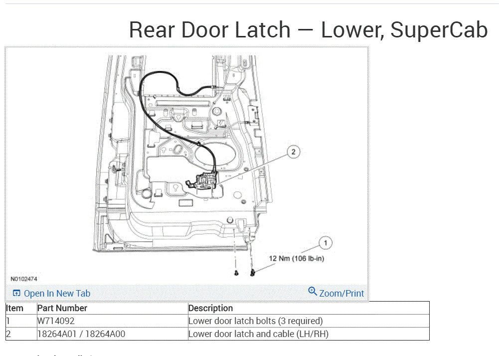

You will need to remove the lower rear door latch assembly. Here are directions for doing it:
________________________
2010 Ford Truck F 150 2WD V8-4.6L VIN 8
Rear Door Latch - Lower, Super Cab
REAR DOOR LATCH - LOWER, SUPER CAB
501-14 Handles, Locks, Latches and Entry Systems 2010 F-150
REMOVAL AND INSTALLATION
Rear Door Latch — Lower, SuperCab
pic 2
Item Part Number Description
1 W714092 Lower door latch bolts (3 required)
2 18264A01 / 18264A00 Lower door latch and cable (LH/RH)
Removal and Installation
Remove the rear door trim panel. For additional information, refer to Section 501-05 .
Position the water shield aside.
Disconnect the door ajar switch electrical connector.
Disconnect the lower door latch actuating cable from the interior door handle.
Remove the interior door handle actuating cable from the guide clips.
Remove the 3 lower door latch bolts and the lower door latch.
To install, tighten to 12 Nm (106 lb-in).
To install, reverse the removal procedure.

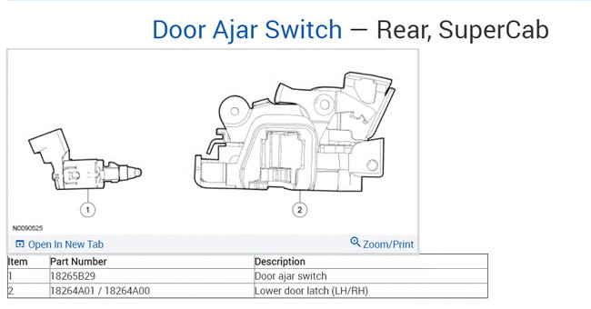

Here are the directions for removal of the door ajar switch:
Door Ajar Switch - Rear, Super Cab
Vehicle Sensors and Switches Sensors and Switches - Lighting and Horns Door Switch Service and Repair Removal and Replacement Door Ajar Switch - Rear, Super Cab
DOOR AJAR SWITCH - REAR, SUPER CAB
Door Ajar Switch — Rear, SuperCab
pic 3
1 18265B29 Door ajar switch
2 18264A01 / 18264A00 Lower door latch (LH/RH)

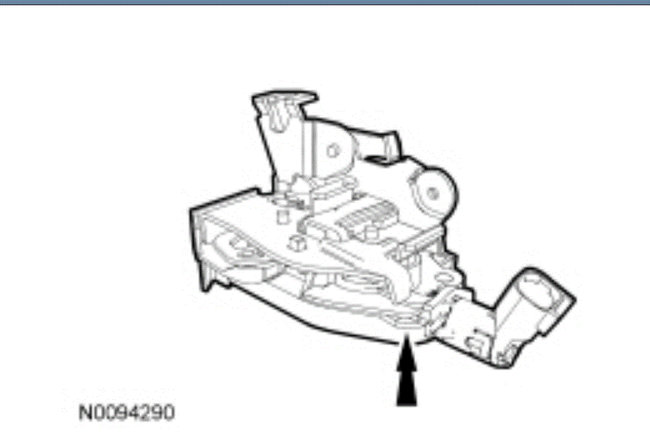

Remove the lower rear door latch. For additional information, refer to Rear Door Latch — Lower, SuperCab in this section.
Insert a screwdriver or suitable tool into the opening on the door latch and push up on the tab.
pic 4
Rotate the door ajar switch and remove from the door latch.

I might be wrong with this latch assembly. Reading through what you said I must have the wrong latch. The latch assembly for a 2010 F-150 XLT 4.6 is one part. The sensor is built into the latch. And that latch is brand new from AutoZone. It may be a bad part they sold me but I don’t see a separate ajar sensor.

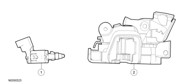

I'm not sure. The info I sent was straight from Alldata. They are usually very reliable. Your truck is a super cab, correct? Or, is it a super crew cab? Also, can you take a pic of what you have so I can see it? Does it look like the pic below?
Jun 28, 2020 at 3:23 PM
TBARRY1989
It is a super crew cab. Yes, it looks like the image you posted in your last reply.
Jun 28, 2020 at 10:57 PM
  • 110,248 POSTS

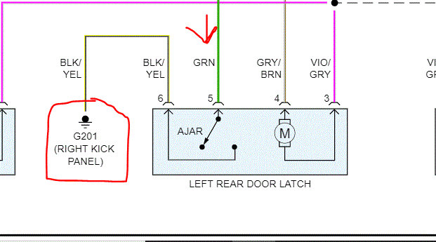

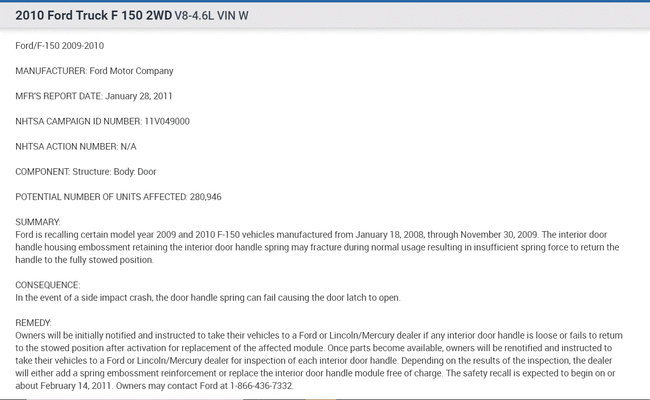

Okay, that makes a difference. The door ajar switch is integral in the door latch assembly. At this point, I suspect that the new latch assembly is faulty. Is the door closing tightly? This is a really simple set up. If you look at the attached pic, it shows power to the switch and the ground. If the circuit closes, it completes the circuit and the light comes on. So, either we have a bad switch or the door isn't closing fully.
I also found a recall dealing with the door that may be relevant. I don't know if this was already taken care of or not, but maybe the return spring in the handle isn't fully allowing the door to latch. Take a look through pic 2.
