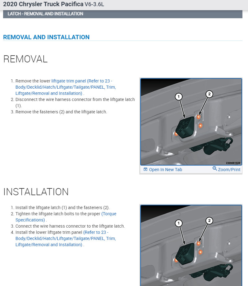

How do you get the old one out to put in a new latch?
Apr 17, 2022 at 4:25 AM
SQM
Experienced Mechanic
6,383 POSTS

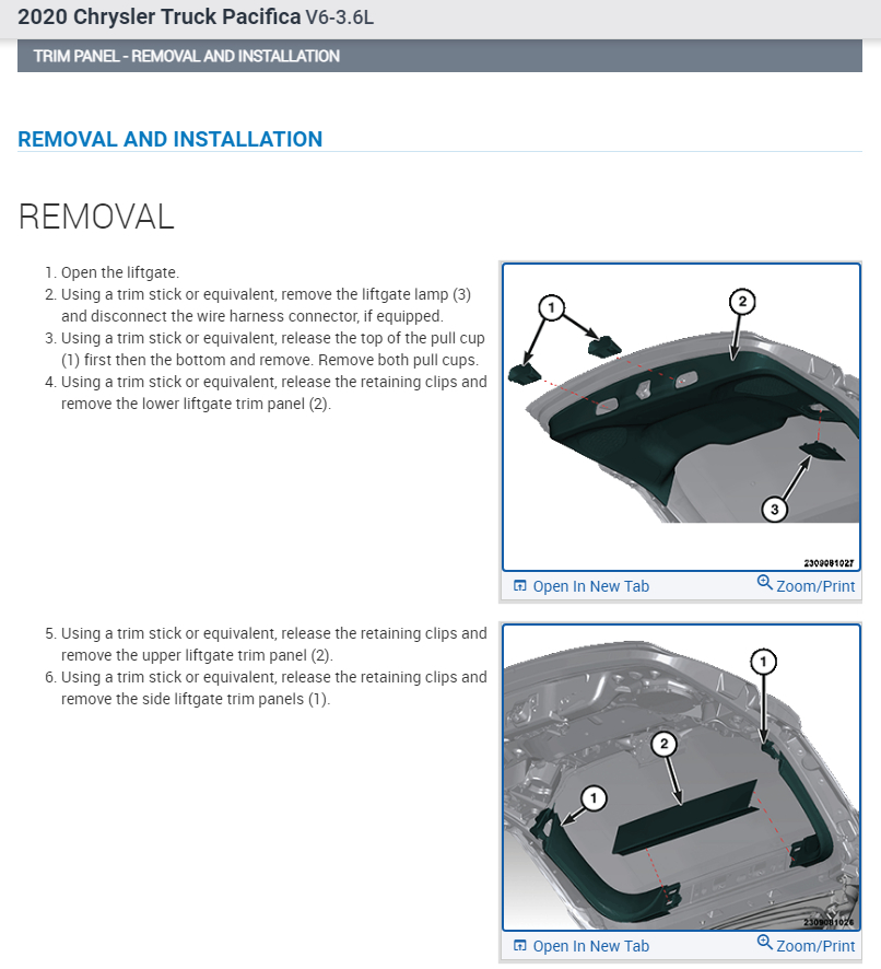

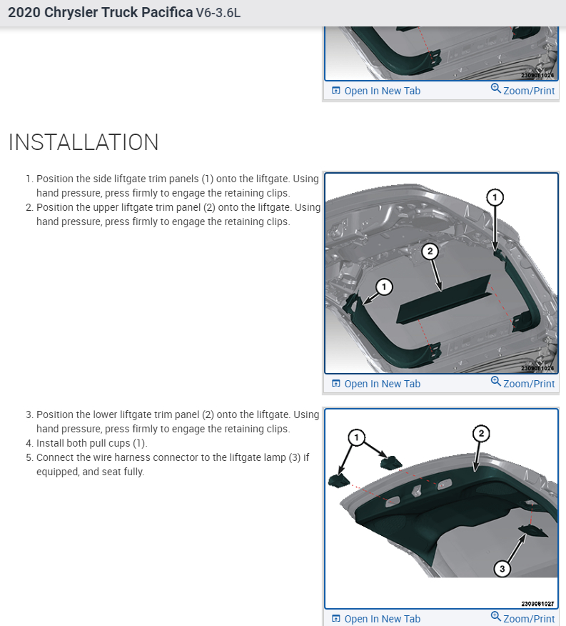

In order to replace the rear latch, you will first have to remove the inner trim panel.
I have attached are the instructions below.
Let me know of any questions.
