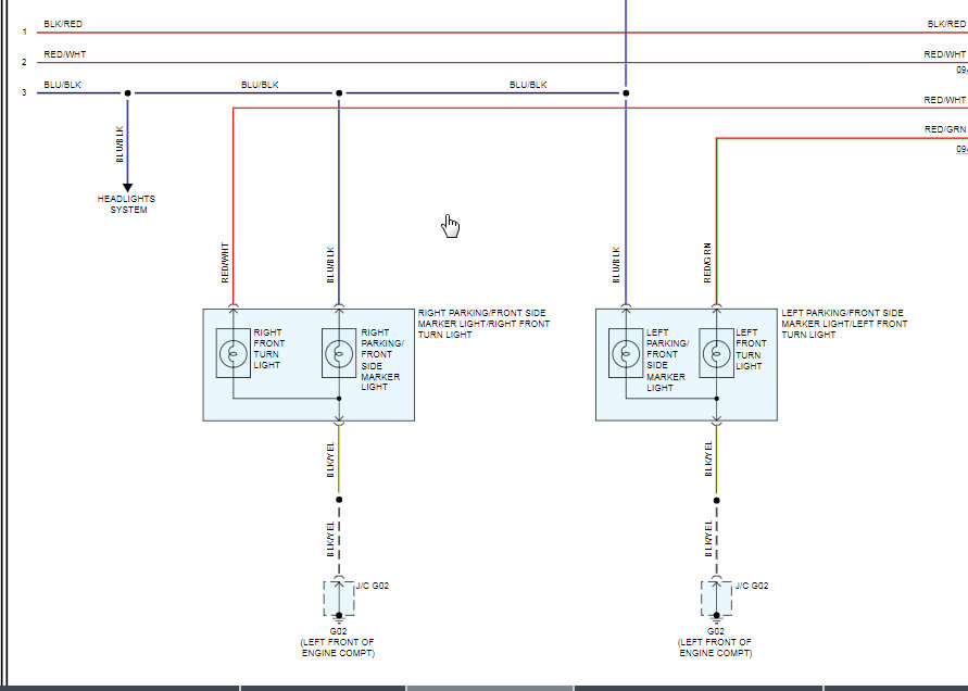

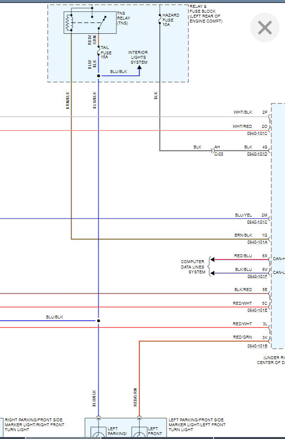

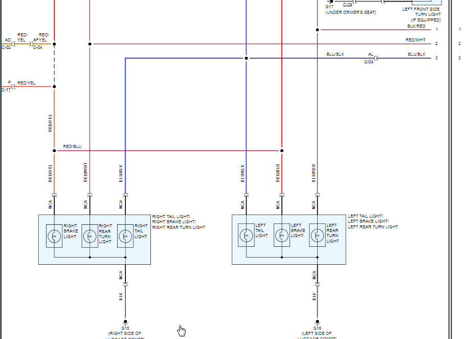

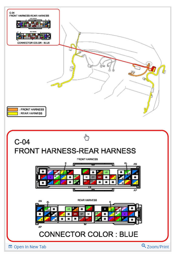

If you don't have power at either of the bulbs and your ground is good then you just need to trace the wiring backwards until you have power. The attached wiring diagrams shows that the same feed wire for the tail lights is used for the license plate bulbs. Are they working? If not, then you can jump to an inline connector C-04. If they do work then I would suspect the splice that splits the feed from the single blue/black wire to where it brings in the license plate bulbs. Unfortunately, there is no location for this splice so you will need to trace the wiring but I assume it will be close the the rear of the vehicle.

Okay. Then trace the blue black wire from both bulbs and find where they come together. There should be a splice. Make sure that is okay. Then start following that wire up through the vehicle and find where you have power. Then repair the damage and you should restore the power. If the plate lights work, then you have power somewhere on that circuit because they use the same feed wire.
