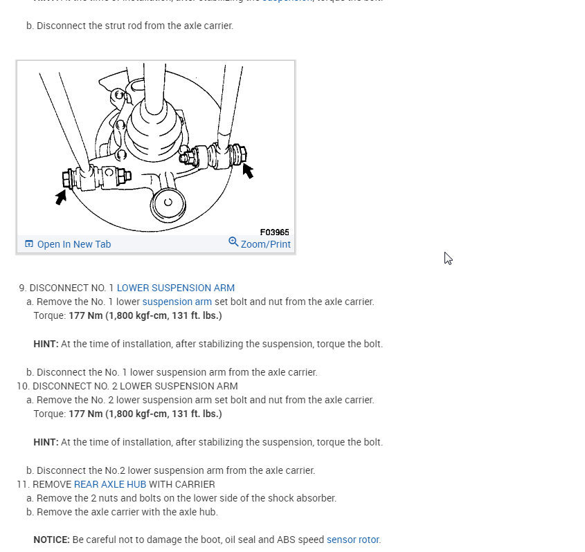

Making a roaring noise in the back driver rear. how do you replace?
Feb 24, 2020 at 9:02 AM

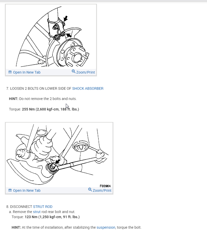

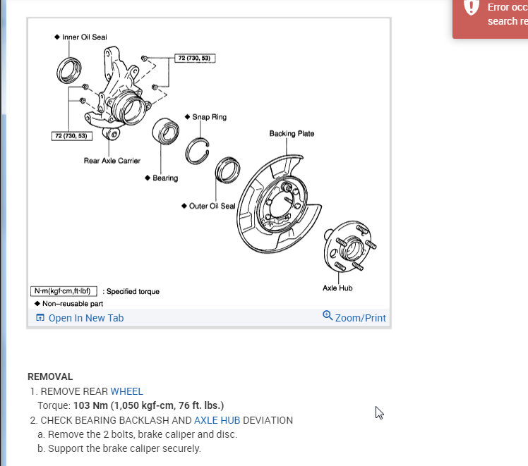

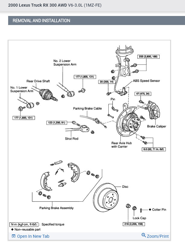

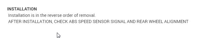

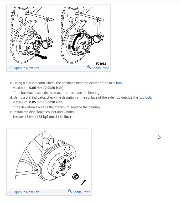

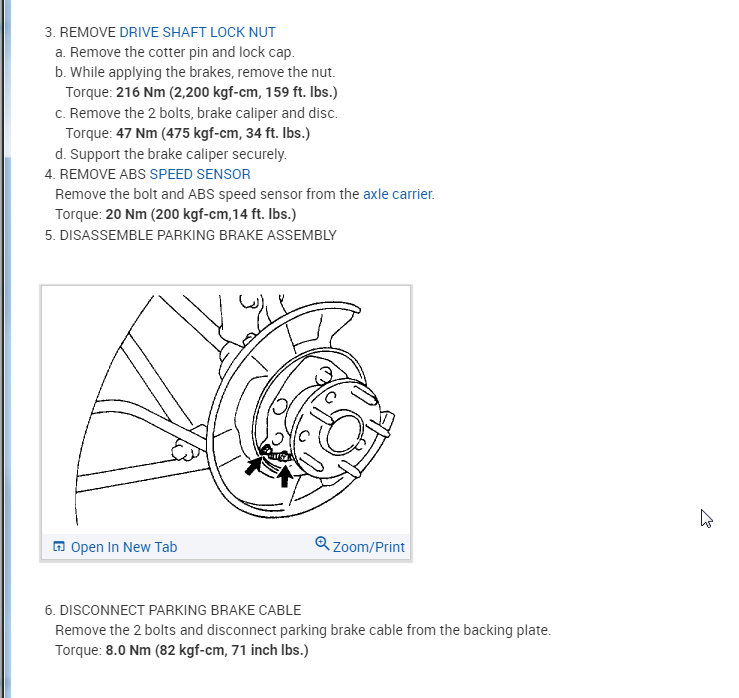

Please see the attachments and let me know if you have questions. Please notice that you will need an alignment after you complete the installation. Thanks

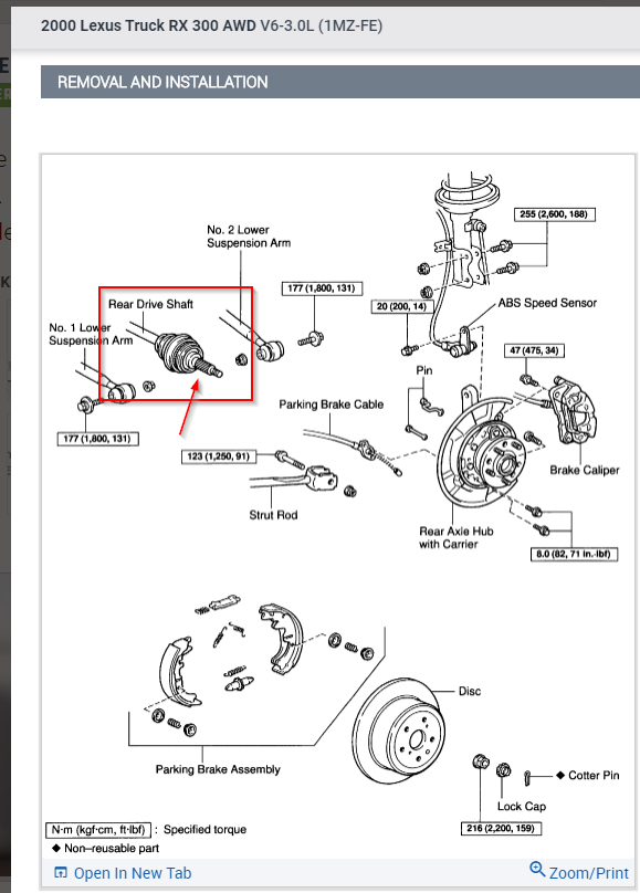

Sir, one other question. do you remove the spindle along with the hub and bearing,being it has too be pressed in?The pictorial is great.
Feb 24, 2020 at 7:54 PM
Spindle? I am not sure I follow which part you are talking about. Do you mean the axle shaft? I attached a picture pointing at the part I am talking about.
If this is what you are talking about, you do not have to remove the axle but the spline part at the end of it that has a nut holding it on the hub needs to be pushed out when removing the hub.
If this is not the part you are talking about, take a picture of it and I will get on the same page with you. Thanks
