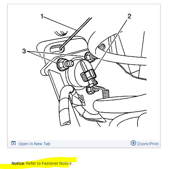

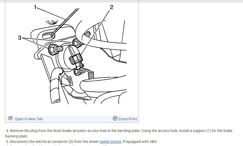

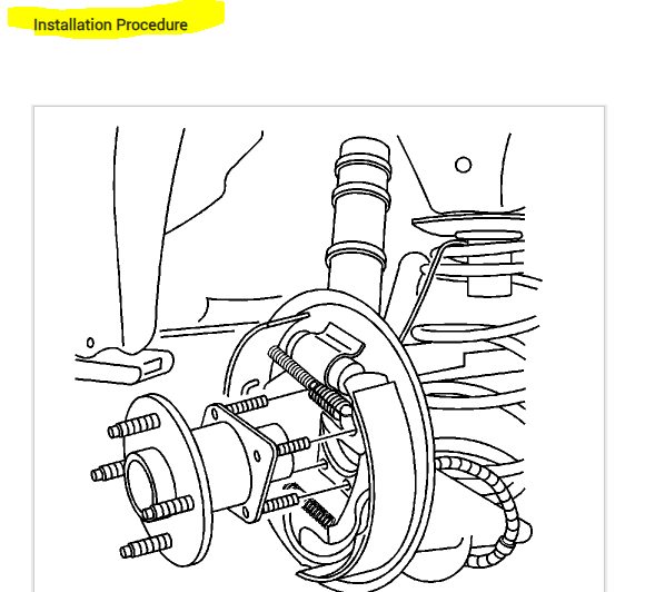

Changing out the Rear hubs and wheel studs for the lug nuts. My rear brakes are drums.
Nov 16, 2023 at 6:04 PM
  • 110,194 POSTS

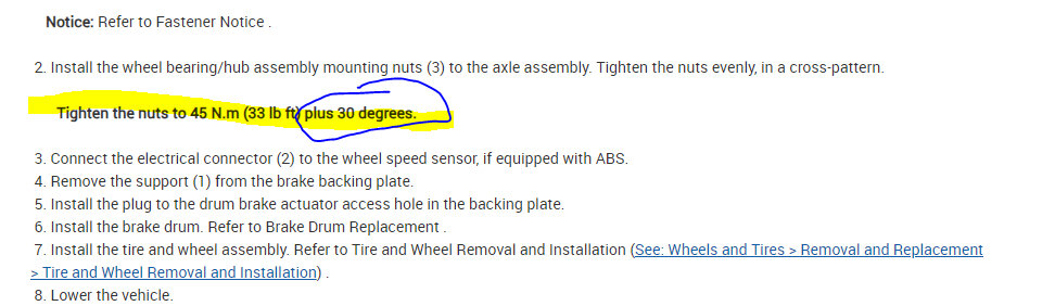

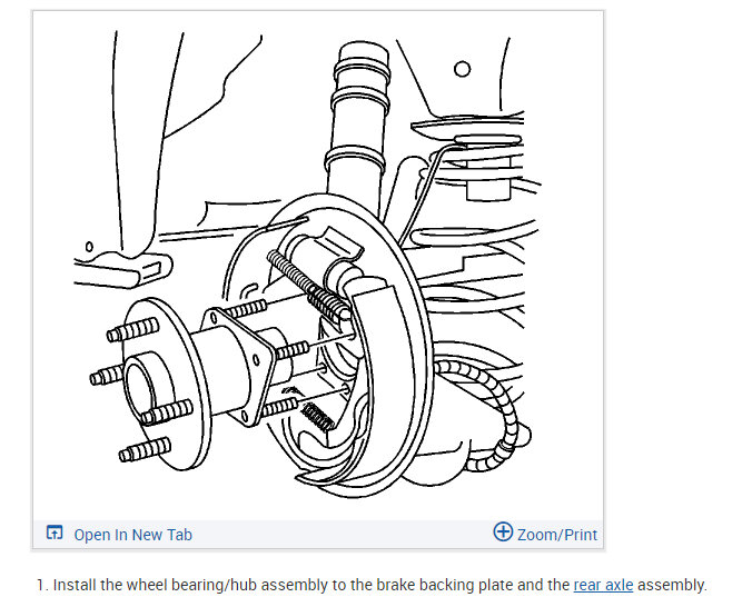

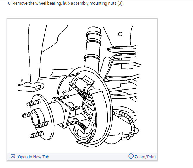

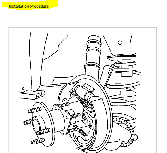

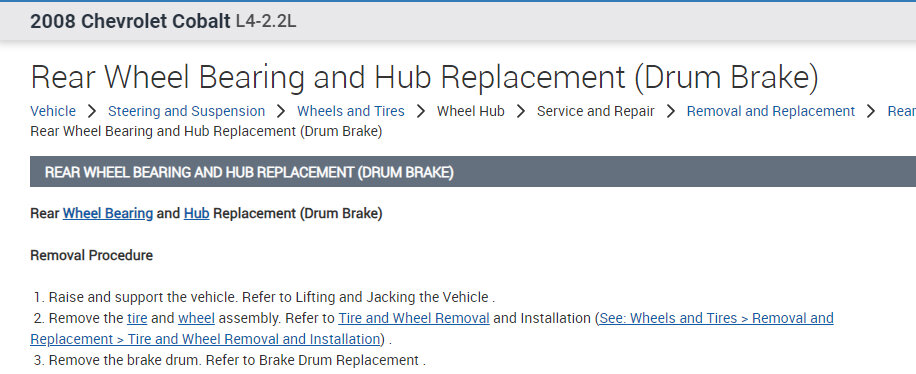

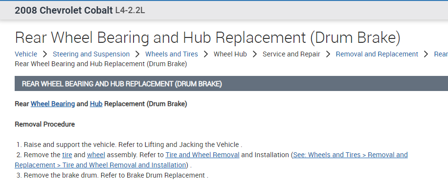

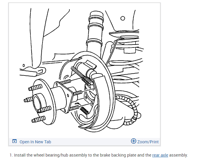

The new hub assembly should already have the new wheel studs installed. Let me know if that isn't the case.
As far as replacing the hub assemblies, I attached the directions below specific to this vehicle. Take a look through them and let me know if you have any questions.
