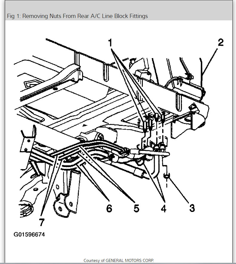

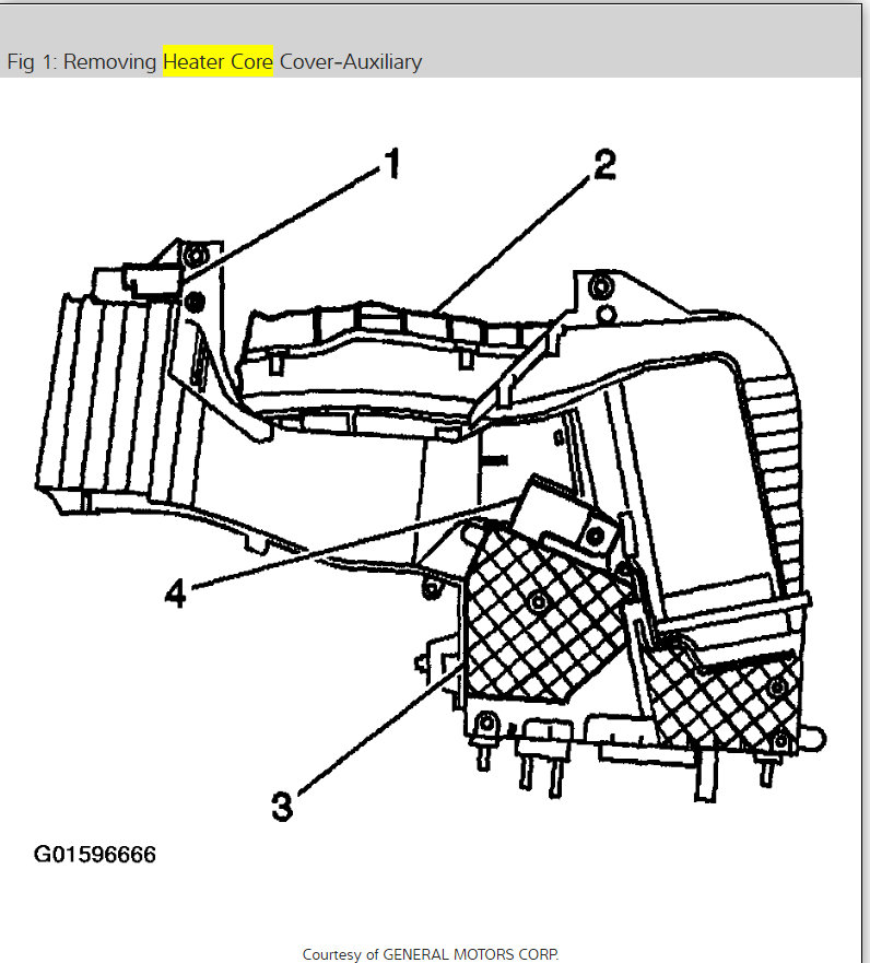

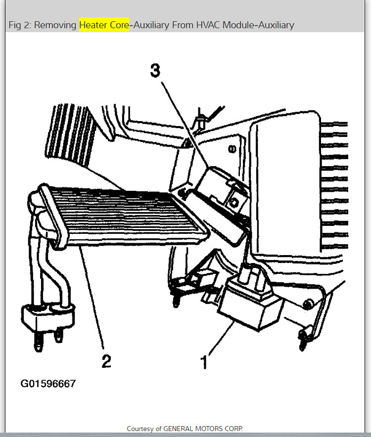

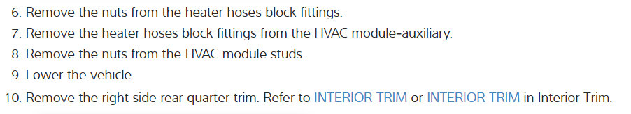

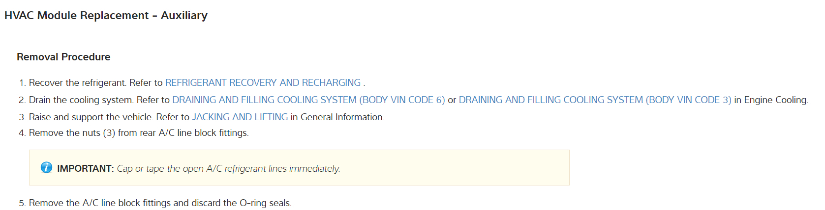

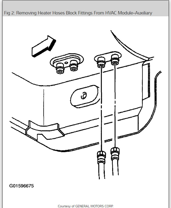

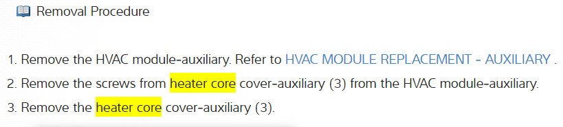

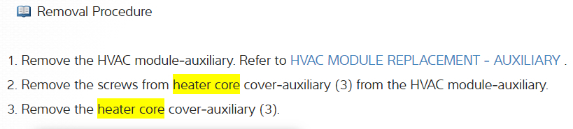

Need to replace rear heater core
Feb 2, 2019 at 3:52 AM
SCGRANTURISMO
Experienced Mechanic
4,897 POSTS
I have included step by step instructions on how to remove your auxiliary heater core. Installation is the reverse of the removal instructions.
Hope this helps and thank you for using 2carpros.
Alex
