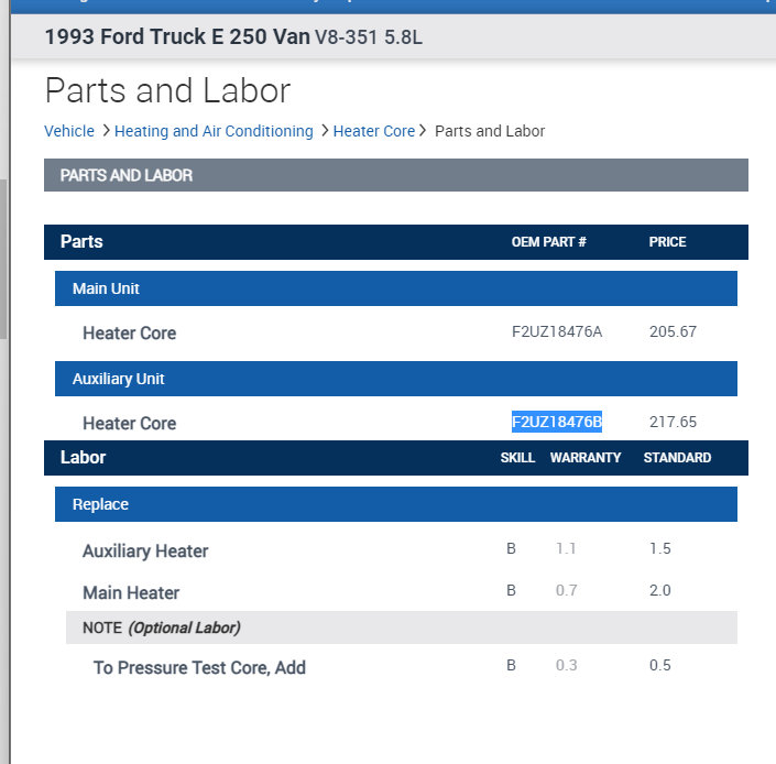

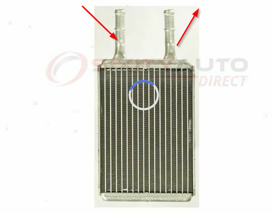

There is no heat coming out of the rear vents. I can feel along the side of the heater core and one of the hoses is very hot (thus, I think hot fluid is getting to the heater core). In addition, the fins along the front are warm to the touch. I'm wondering what the next step is diagnosing where the problem is. As this is a conversion van and there is lots of custom paneling, I would like to leave taking apart that paneling until absolutely necessary.

I suspect you have a restriction in the heater core which is preventing the air from heating because the coolant is not flowing freely through the heater core.
So, what we need to do is check the temperature of each of the lines running to the heater core and they should be pretty much the same temperature.
Let's use a laser temperature meter to find out what they are, and we can go from there.

Once we know this we will know if we need to replace the heater core. However, the next thing we will need to check is the coolant level. If it is low, then it can cause this as well.

So, I have found out the following. It seems the rear only blows warm if the mode is set to "floor". When set to "vent" the rear air blows about 73 F, when in "floor" is blows about 87 F. When checking the two hoses at the heater core, one reads about 126 F and the other about 102 F.
Nov 18, 2021 at 1:08 AM
So, you may have two issues. The heater core may be starting to clog but the fact that you have a large difference in air temperature between the mode's points to a blend door issue on the rear unit.
