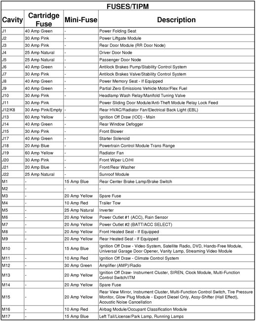

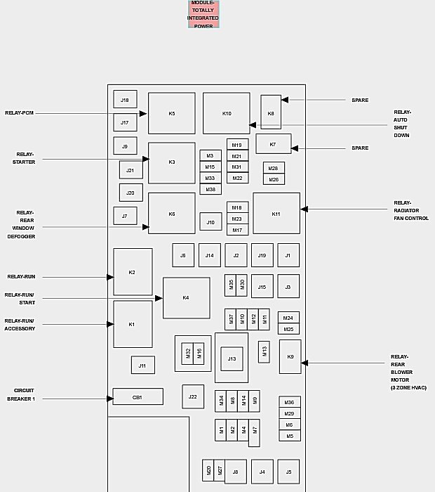

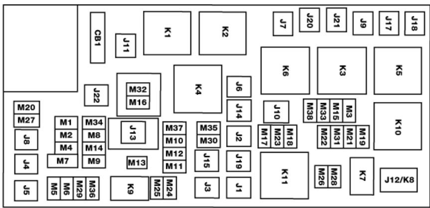

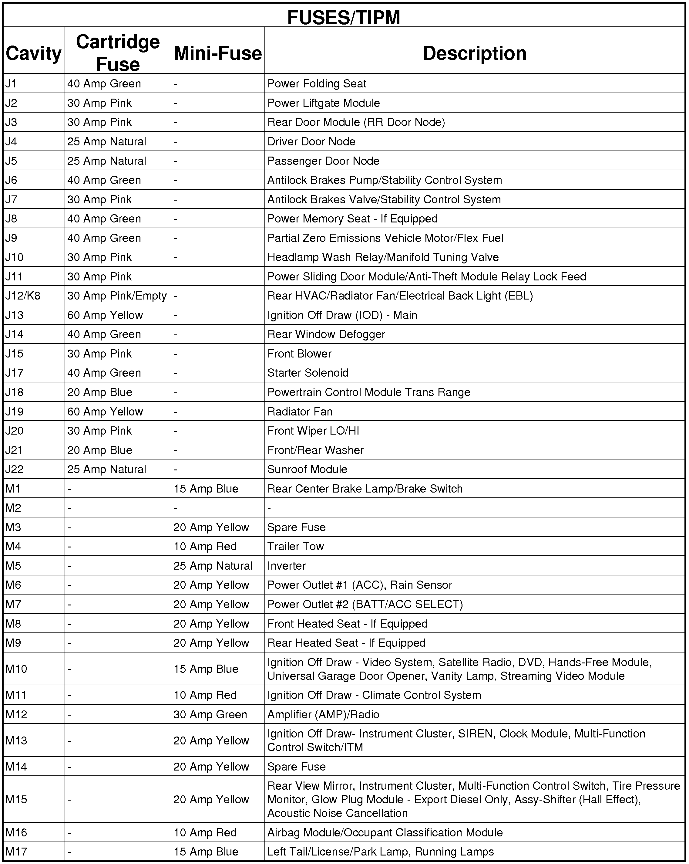

First, check to make sure the fuse for the rear fan motor is good. It is located in the power distribution box under the hood of the vehicle. It is J12. See the attached pictures.

I did check the fuse for the blower (J15) I believe, it was still good.

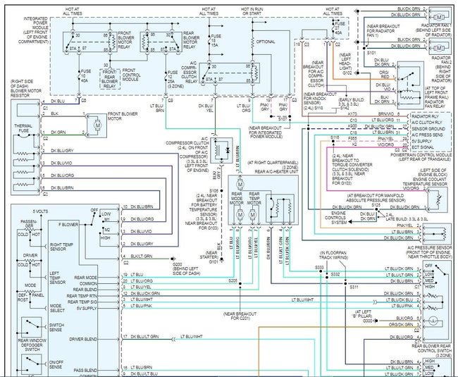

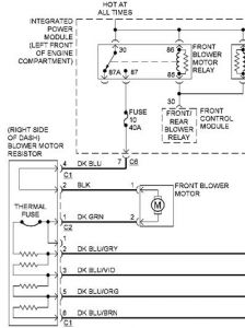

When I unplug the motor, the dark blue wire has twelve volt on it when the car is in the on position, and the fan selector is in any position other than off. with it plug in I do not see any voltage on the dark blue wire until the fan selector switch is in the off position.
I have even tried to jumper the blower fan out. I found the dark blue wire with yellow strip on the blow fan went to the resistor module. I unplug the resistor module and jumper the dark blue with yellow strip wire to ground and still nothing.

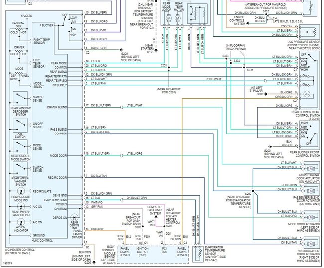

the only other thing that has me confused is that all of the wire diagrams show the resistor module with five wires. Mine has only four, both old and new resistor module.

First, do the following to check the resister.
Disconnect and isolate the negative battery cable.
Disconnect the wire harness connector from the blower motor resistor.
Using an ohmmeter, check for continuity between all of the blower motor resistor terminals. In each case there should be continuity. If okay, repair the wire harness circuits between the blower motor switch and the blower motor resistor or blower motor as required. If not okay, replace the inoperative blower motor resistor.
If that checks out fine, check the blower motor relay. Simply switch it with another relay with the same part number. I have attached a picture of the relay block.
If that checks good, check wiring to and from the switch. If that is good, then I suggest the following. Your vehicle is equipped with a TIPM, totally integrated power module. These units nearly control everything electronic on the vehicle. You will need to have that checked at a dealer who has the proper test equipment.

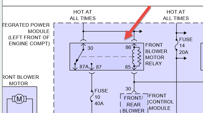

Quick question, where is the relay for the front blower motor? I only see a rear blower motor relay K9. The rear blower is working right now.

(Solved) So I ran a new hot wire from the battery to the fan motor positive to test the assumption that the wire or TIPM was bad. The blower fan worked and I was able to control the fan speed with the HVAC controls. I then removed the TIPM module and removed the connector C7 (the front left most connector) and found that the terminal and connector had some corrosion build up. After cleaning up both connector and socket and applying some Die-electric grease to prevent it from happen again, the fan now works correctly! I believe that the connection was corroded enough to not supply enough amps to spin the motor but not so bad as to prevent a voltage reading.

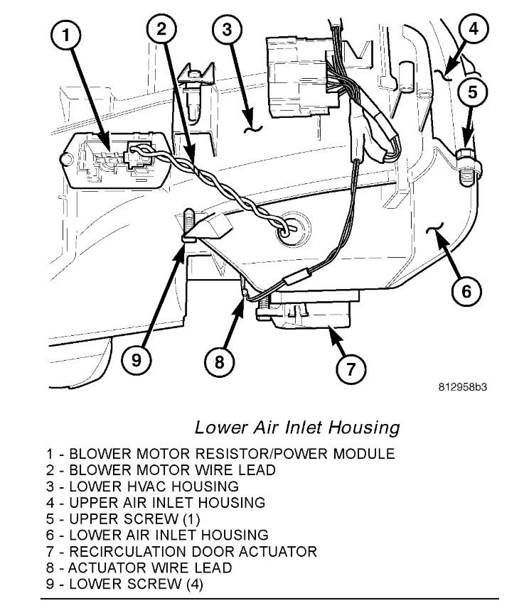

2006 Town and Country blower problem solved. My blower motor stopped working on all speeds. I found a $14.00 resister pack from Autozone. This pack is right in front of the blower motor behind the dashboard glove compartment. Presto! Two of the speeds had been out for months, then all speeds suddenly died. Try THIS part before you buy a blower motor.

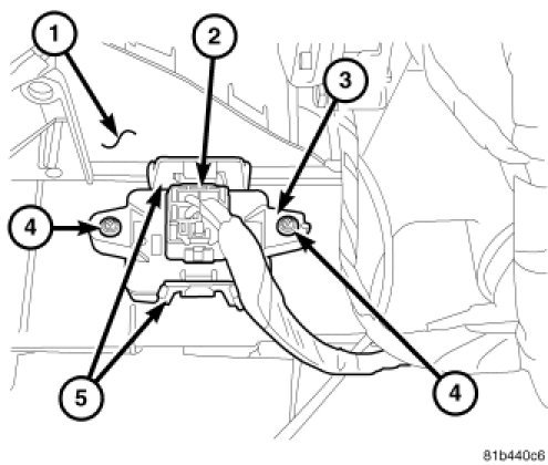

The front blower will not work the rear blower works fine. I swapped the relays and fuses between the two blowers with the same results. How do I check for power to the blower. please be very specific. ie where to connect the meter leads etc.
Feb 27, 2021 at 1:54 AM (Merged)
  • 75,988 POSTS

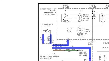

Hi there jmi65 and TY for the donation Find the front blower module on the HVAC unit disconnect the 2 wire connector that has these wires dark blue and dark blue and yellow-do you have this wires if so disconnect it and probe for power on either terminal of the front blower module-No power the module is gone To verify the motor if its operational again disconnect it, power it from the battery using 2 jumper wires don't worry about polarity if it turns on and fuse no.10 40amp is good replace the front blower module. See diagram below
https://images.2carpros.com/forum/automotive_pictures/12900_front_blower_module_1.jpg

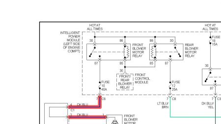

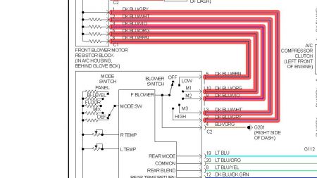

blower not working any speed. found shorted bug in resister. no power to dark blue wire connecting resister with switch at any speed. have power to large blue wire to resister. engine compartment front fan fuse and relay seem ok.
HELP
Charlie
Feb 27, 2021 at 1:57 AM (Merged)
BMRFIXIT
  • 19,053 POSTS
DK BLU wire no power is an indication of power failure check fuse # 10 its 40 A under hood if fuse OK and have power with key on suspect a short in the wire and need to check If you have power to the resister and not out from the resister check for ground if in and not out have to remove and replace resister as it is at fault place switch at high unplug the motor and check for power and for ground if have the two remove and replace the motor

Start by checking for power/ground at the blower motor when switch is on, in all different positions. You will need to use a voltmeter for this.
The blower motor is located on the HVAC unit, behind passenger side dash.
Read the guide below on using a volt meter, it will help
Attached below are the component locations and the wiring diagrams for you blower motor

Before you replace any parts, check your fuses and relays in the integrated power module under the hood.
Fuse #10 40A, fuse #12 25A, and two relays (depending on models with front and rear heat), if not just one relay.

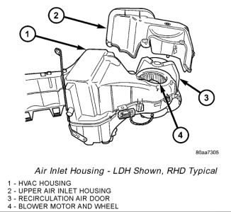

where is the front blower motor located in a 2002 chrysler town and country with dual air?
Feb 27, 2021 at 2:12 AM (Merged)
  • 75,988 POSTS
https://images.2carpros.com/forum/automotive_pictures/12900_bm_8.jpg
The front blower motor and wheel are located near the passenger side end of the heater-A/C unit within the two halves of the intake air housing in the passenger compartment below the instrument panel.

Check fuse no.10 40amp and front blower motor relay see below
https://images.2carpros.com/forum/automotive_pictures/12900_blower_relay_2.jpg
https://images.2carpros.com/forum/automotive_pictures/12900_blower2_2.jpg

replace the blower motor resistor approx $25.00 it's located behind the glove box ( open the glove box and push on the thin plastic sides and it'll fall wide open and then un clips) you need a 1/4 inch bold driver and you'll see a rectangled shaped plastice piece and two harnesses connected to it remove it and replace
if the motor is bad the new resistor will go again right away but it's the easiest and cheapest starting point
