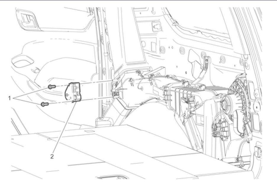

My rear ceiling vents only blow out heat when the temperature is set to 90 degrees. If it is not set to 90 degrees it blows out cold are bit only from the ceiling vents. All other vents including the rear floor vents work perfectly fine. I am assuming it might be heat door actuator? I’m a correct in assuming this and if so where would be the location of this particular actuator location? Any help or assistance is greatly appreciated
Nov 14, 2019 at 7:07 AM
DANNY L
  • 5,648 POSTS
Hello, I'm Danny.

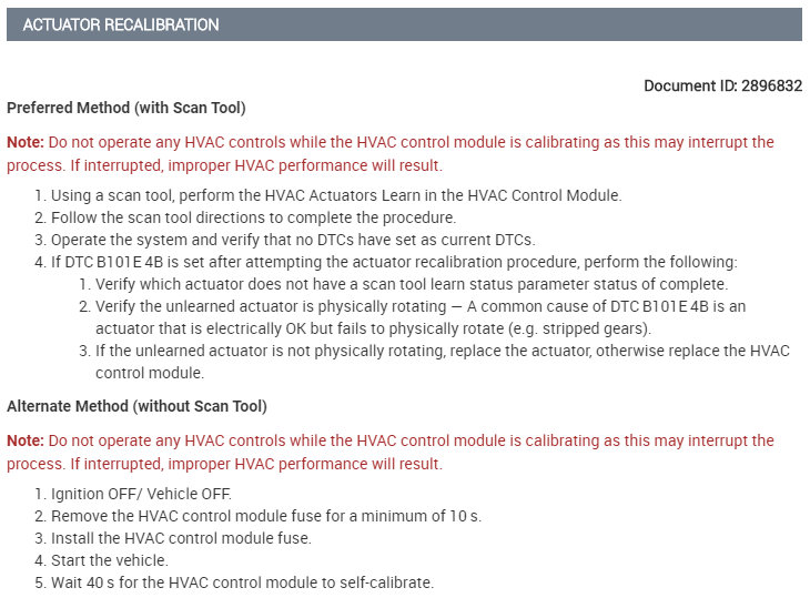

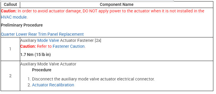

It sounds like you are having a problem with the auxiliary mode valve actuator.It's located on the right rear side HVAC box.Here is a basic tutorial showing how to replace blend/mode door actuators:
You will have to remove right rear trim panel to gain access.After valve replacement you will have to perform a re-calibration. I've attached pictures below with location and instructions.Hope this helps and thanks for using 2CarPros.

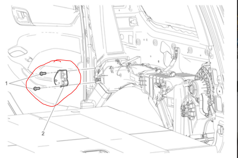

I pulled the panel and noticed there are two actuators back there I am waiting for the new one to come in. It should be the one closest to the passenger side door correct? What is the one most rear for?
Nov 14, 2019 at 9:10 AM
DANNY L
  • 5,648 POSTS
Hello again,
Yes, I've re-attached picture and circled in red. It is the closest to the front. The one in the rear near (tailgate/hatch) Is a temperature control actuator.Hope this helps and thanks again for using 2CarPros.

Okay, I'll find out if there might be a control panel reset.Did you happen to disconnect the battery while performing the repair?
Danny-
Nov 23, 2019 at 8:59 AM
LIPS3185
  • 12 POSTS
I disconnected the battery after the repair for about 5 minutes.
Nov 23, 2019 at 9:28 AM
DANNY L
  • 5,648 POSTS
Hello again.
It usually a good idea to leave battery disconnected for 10-15 minutes. If you want to try and get back to me after if problem persists we'll go from there. Thanks again for using 2CarPros.
