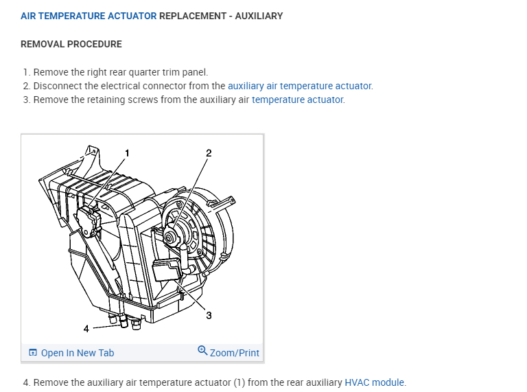

The rear heat blows cold air. I just changed the blower motor because it was going out. The front blows heat just fine but the rear only cold.

Good morning,
There is a blend door motor on the rear heater assembly. I attached a picture with the procedure for you to follow.
Let me know if you have any other questions.
