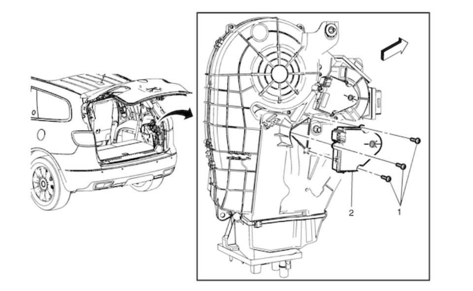

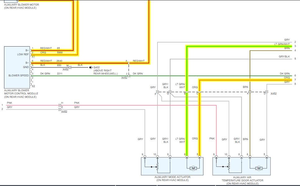

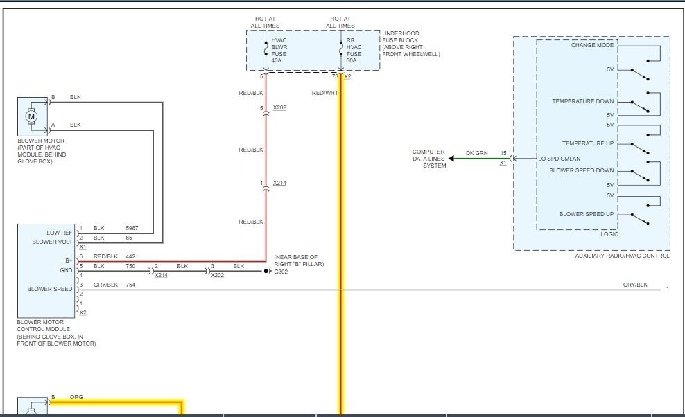

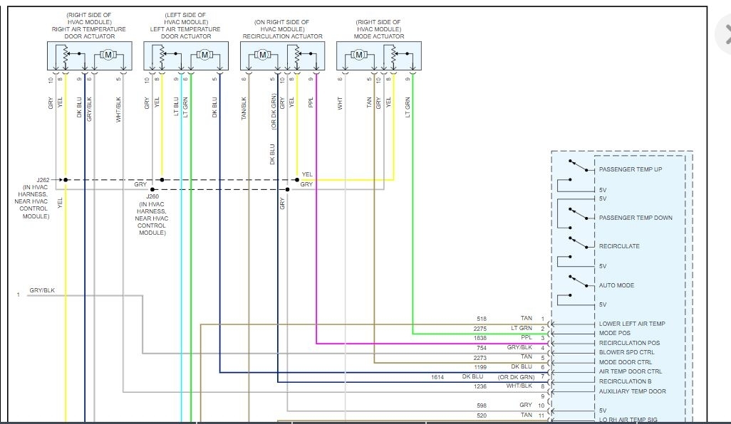

The front heating works fine. It has separate controls for rear heat and it will not get hot.
Feb 6, 2020 at 12:36 AM
Good morning,

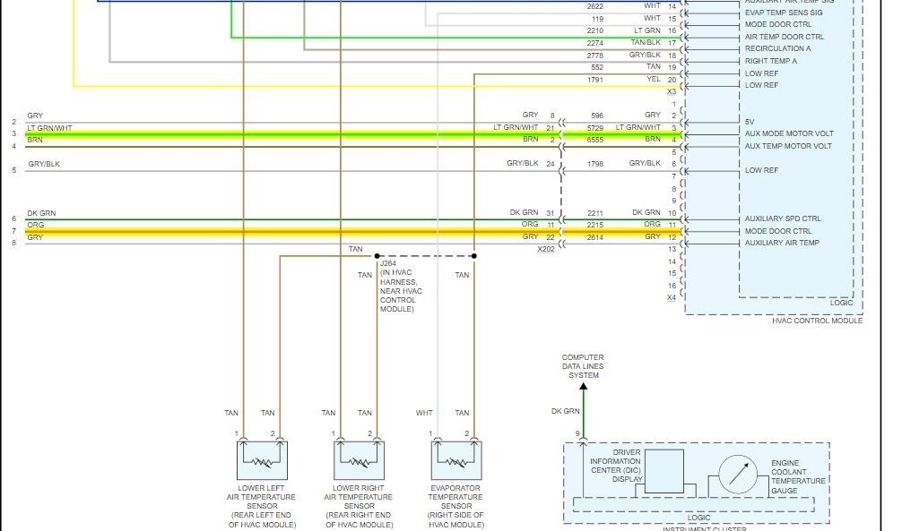

It sounds like the blend door actuator. I attached the procedure and a picture.
This is a common failure.
I would suggest replacing it.

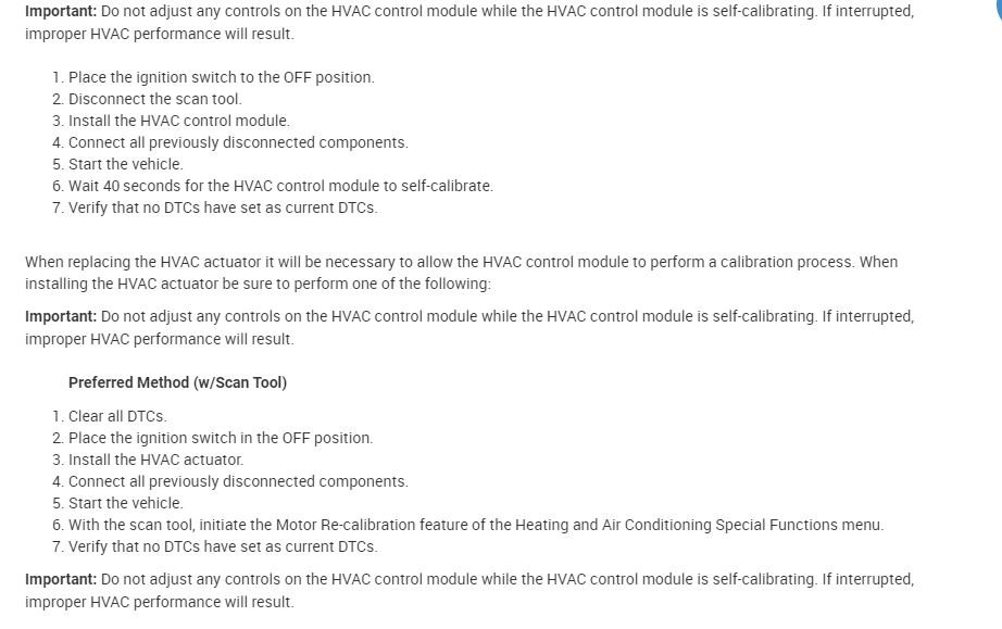

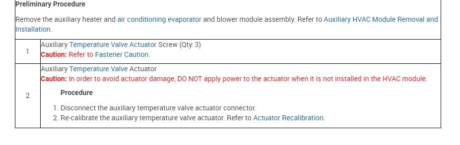

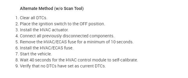

Thanks for your reply, I’ve priced them for $17.00 to $37.00. any particular brand you recommend? I’ve seen Dorman and Murray. Is the re-calibration necessary?
Feb 6, 2020 at 4:02 AM
Dorman is good.
Procedure attached.
Feb 6, 2020 at 4:06 AM
RLS8836
  • 5 POSTS
Yes it was, can I install it and not have to do the recalibration?
Feb 6, 2020 at 6:51 AM
No, it will not work correctly. It must be calibrated for it to work properly.
