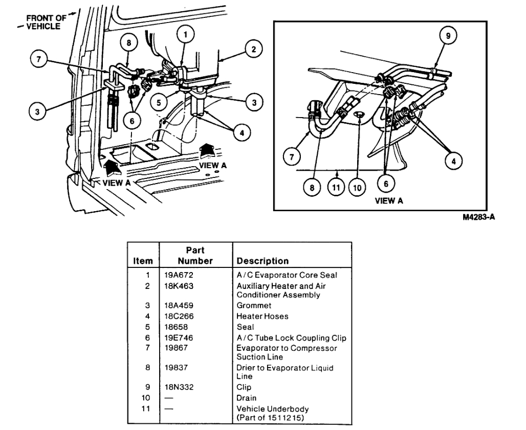

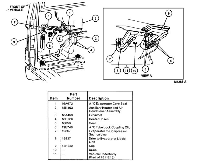

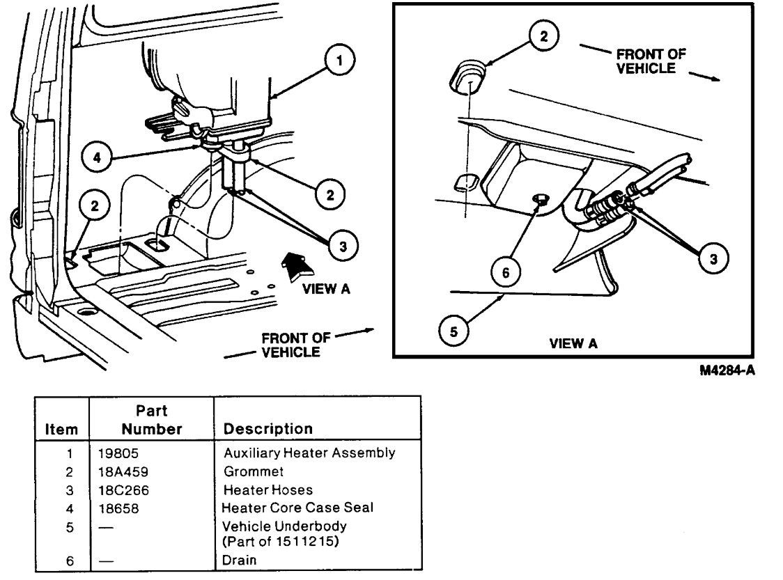

Someone has disconnected the rear heat and AC. Is it hard to fix? Can you just run hose to a good connection spot?
Oct 5, 2018 at 9:55 AM
Experienced Mechanic
55,746 POSTS
Yep, run new AC and heater hoses and the system should start working just make sure the rear evaporator and heater core are not leaking.
