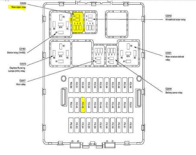

Hatch sensor stays on and wiper stopped working.
May 1, 2021 at 2:41 PM
  • 110,190 POSTS

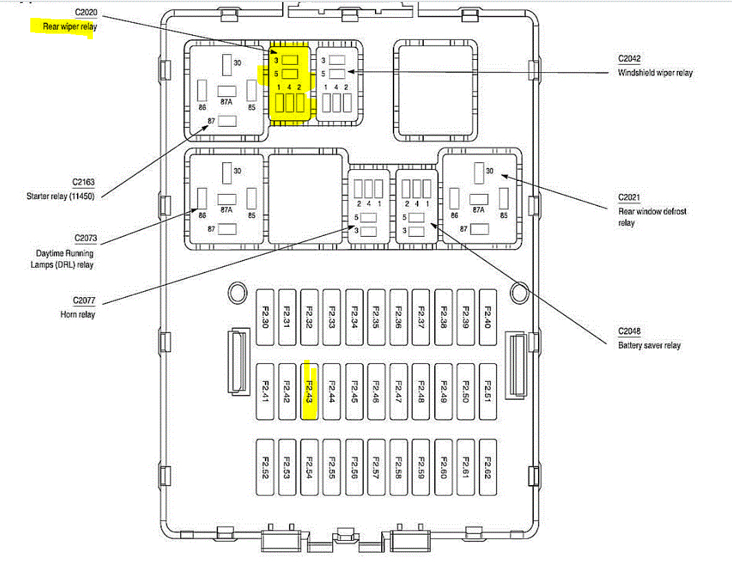

The first thing to check is the fuse in the central junction box. The rear wiper fuse is number 43. If you look at pic 1, I highlighted both the fuse and the rear wiper relay.
First, check the fuse. In addition to checking the fuse, confirm there is power to it. Here is a link you may find helpful:
If the fuse is good and has power, then we need to check the relay. If there is a different relay in the box with the same part number, switch them to see if it makes a difference. If there isn't one to switch, here is a link that explains how to test one:

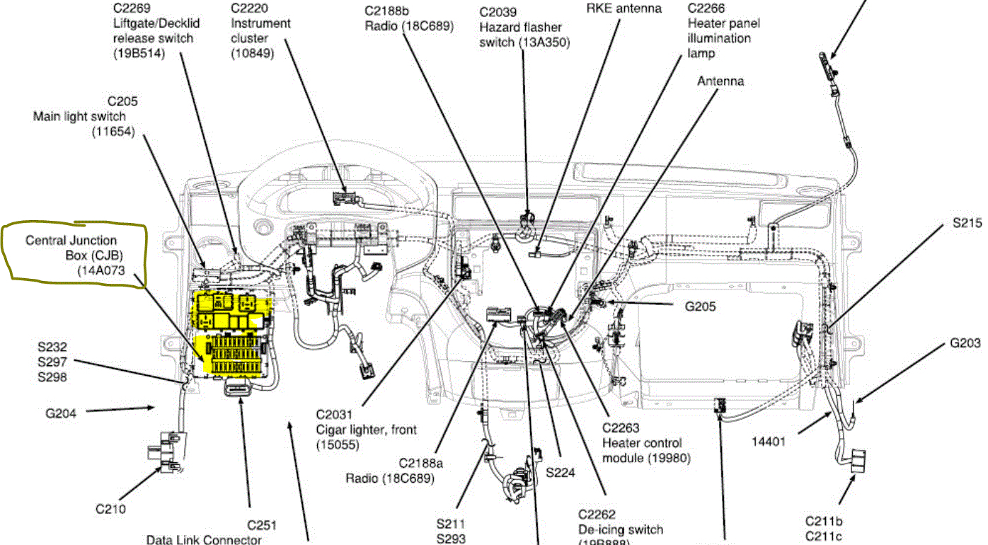

Pic 2 below shows the location of the central junction box.
