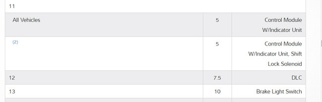

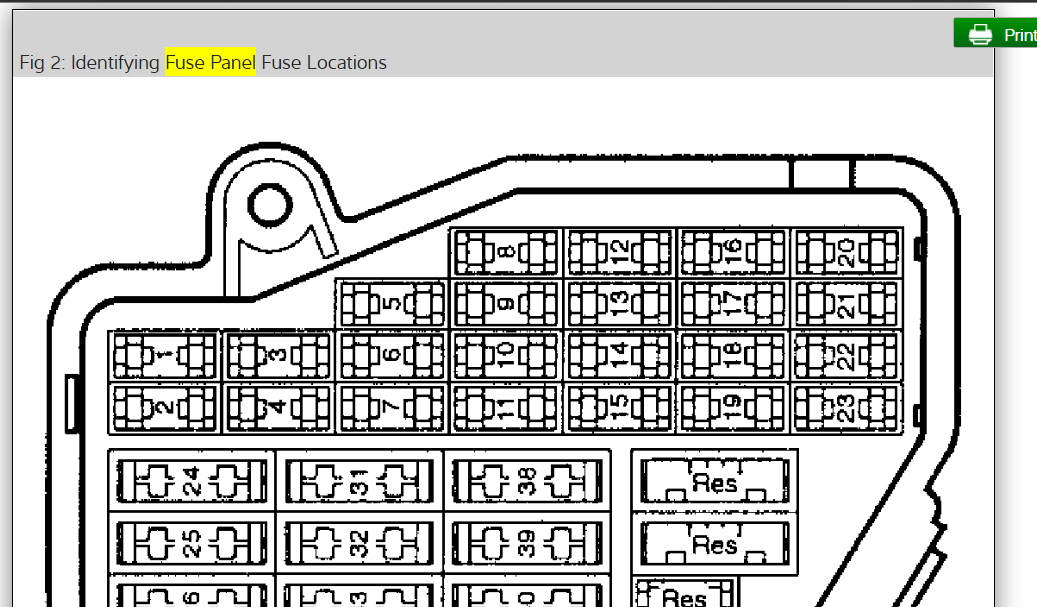

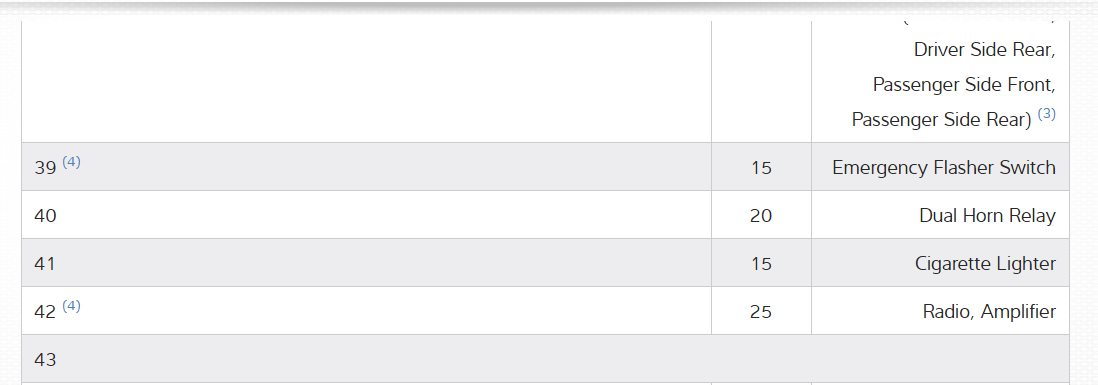

My rear hatch can't lock and I did replace the solenoid, and lubricated the whole mechanism. It still isn't locking.
May 10, 2019 at 1:41 AM
SCGRANTURISMO
  • 4,897 POSTS

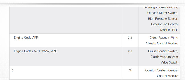

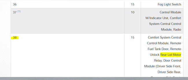

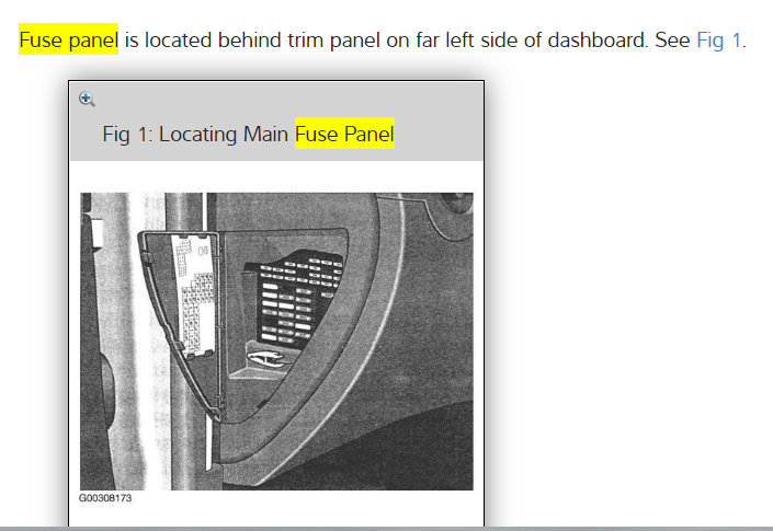

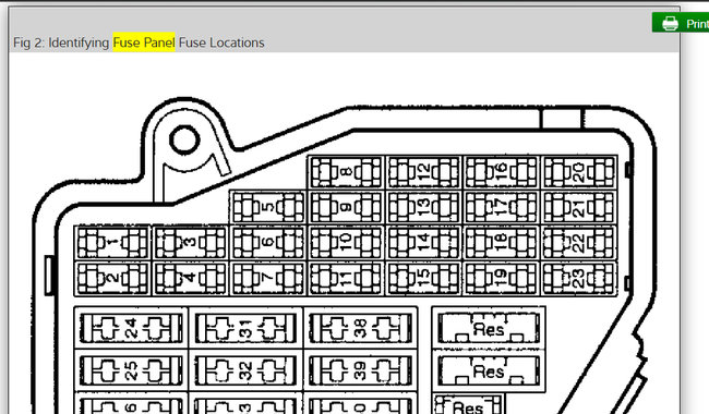

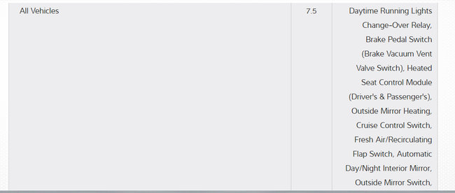

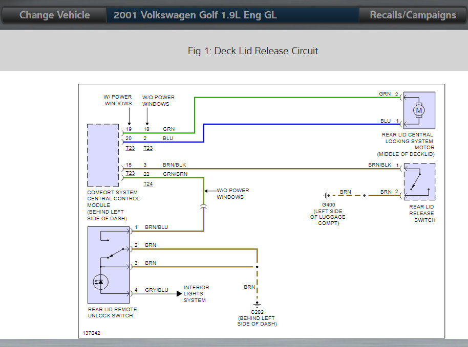

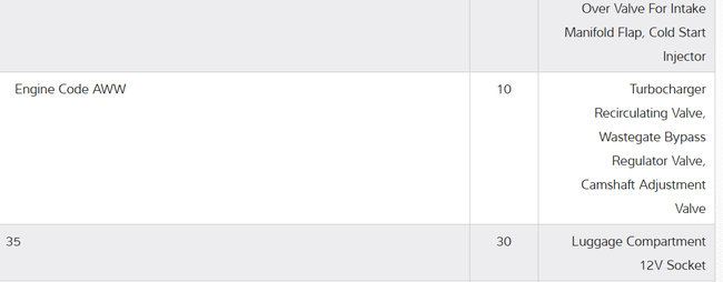

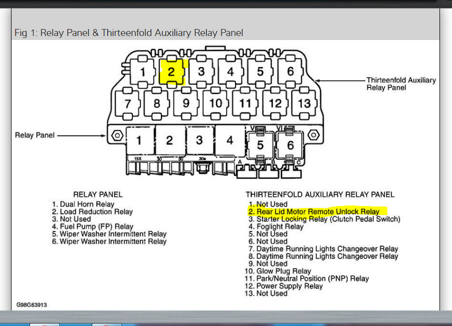

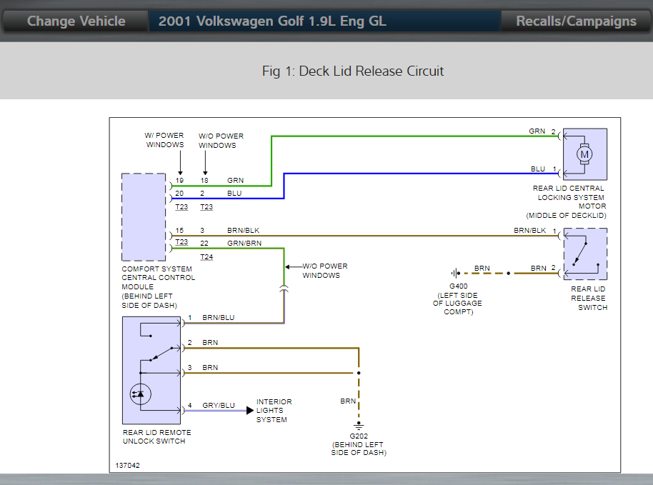

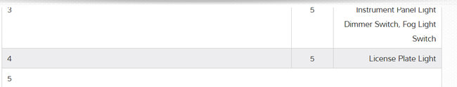

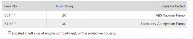

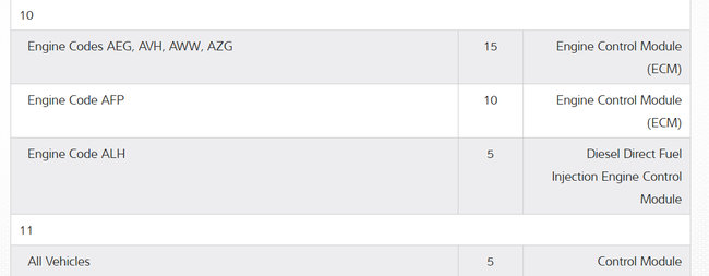

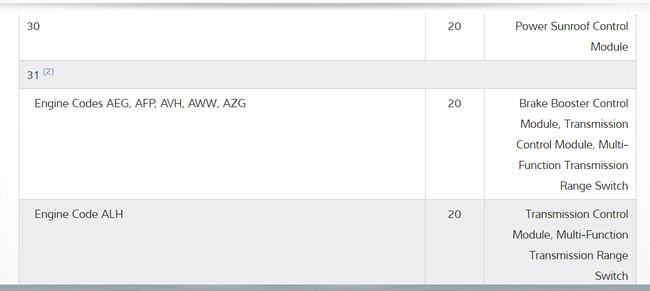

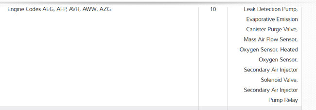

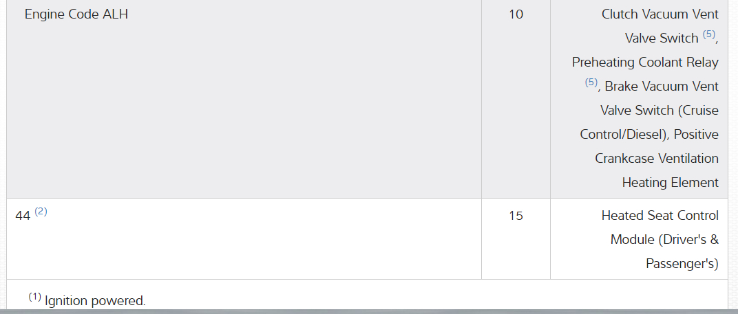

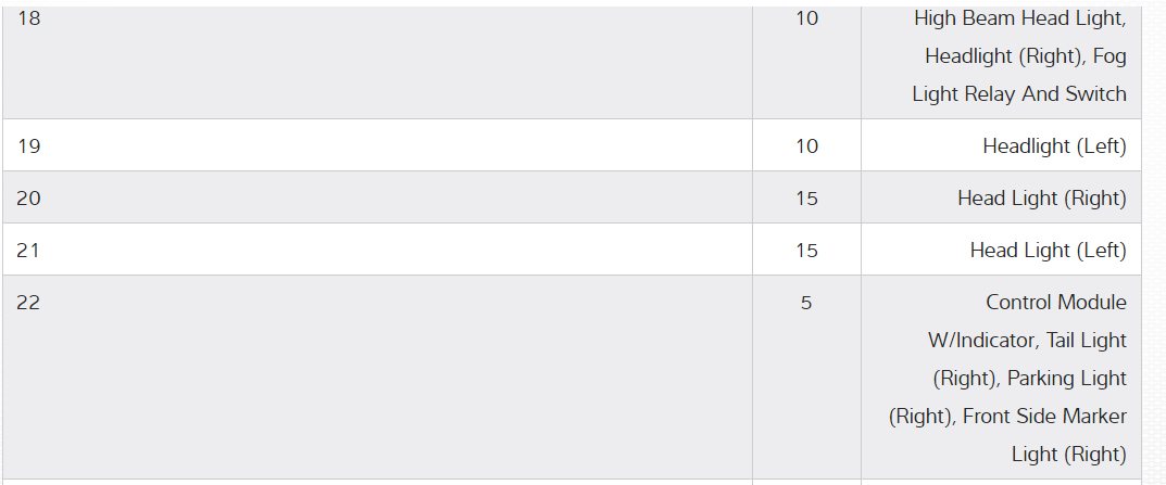

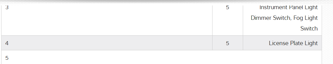

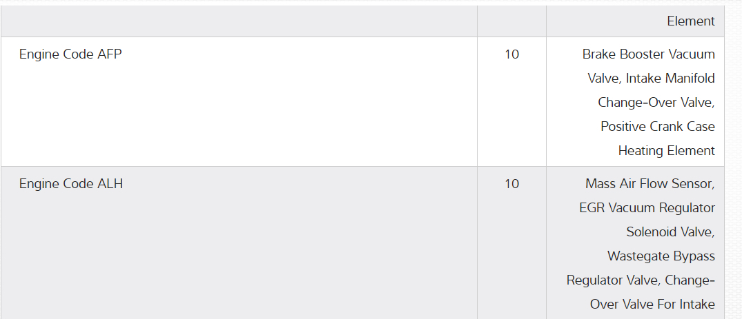

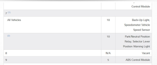

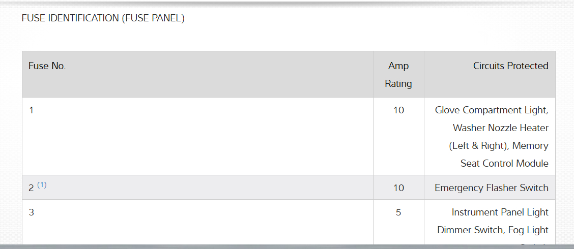

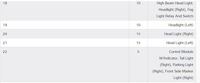

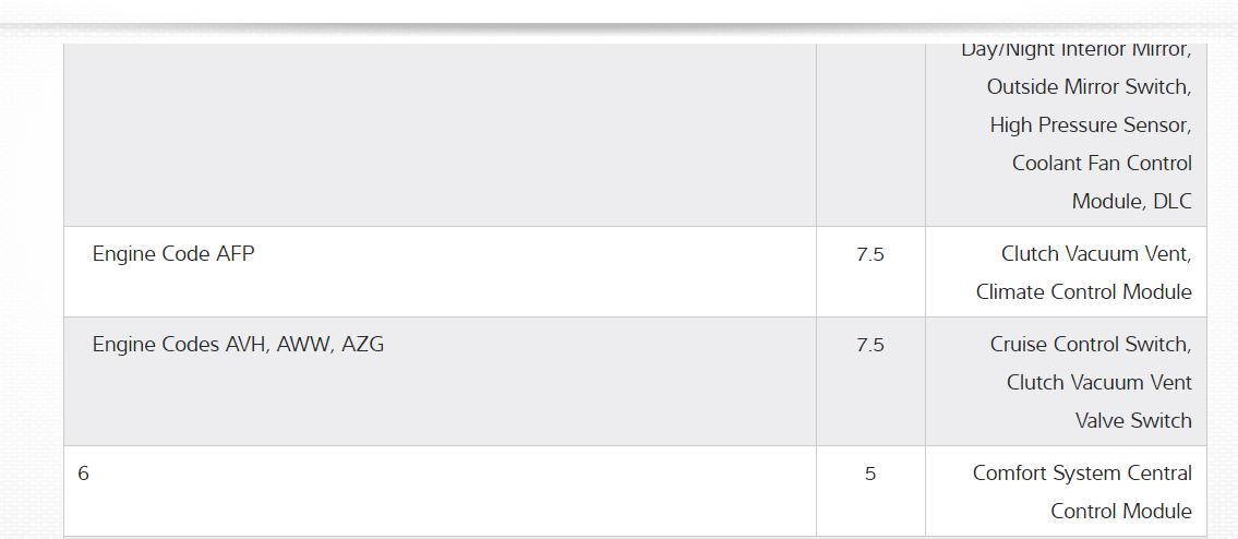

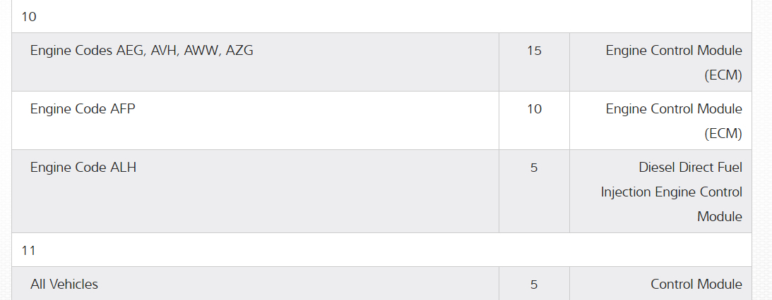

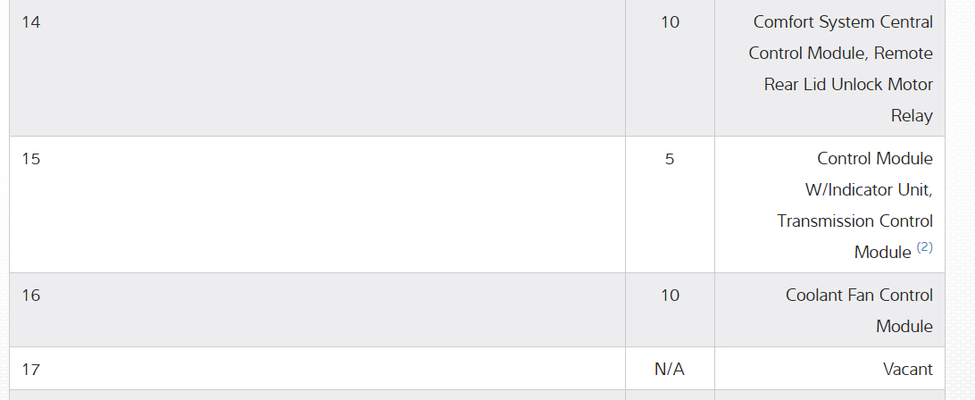

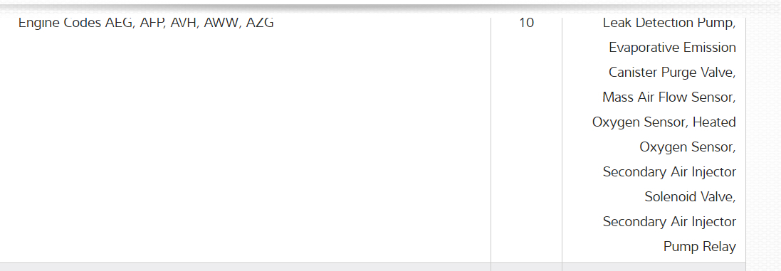

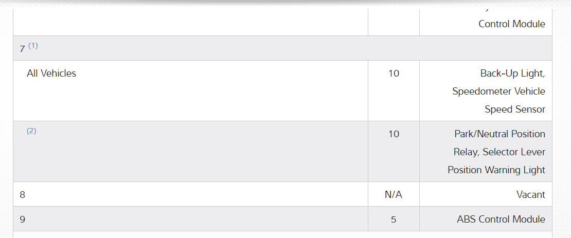

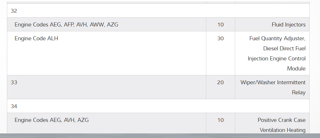

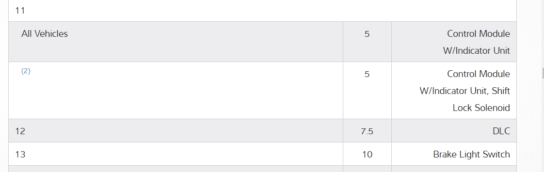

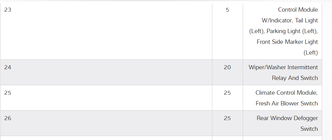

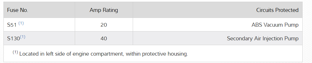

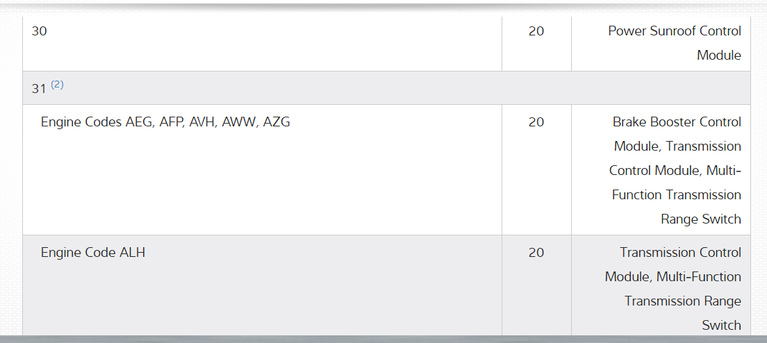

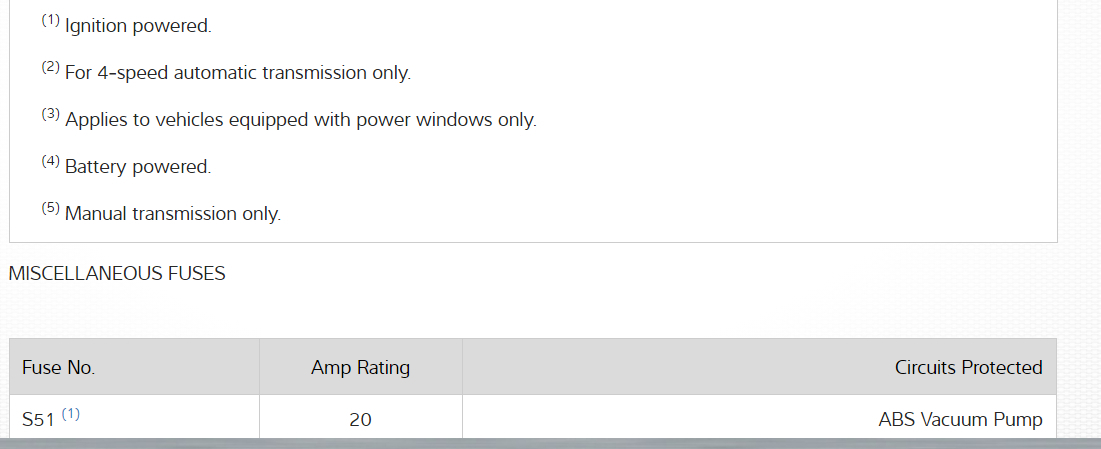

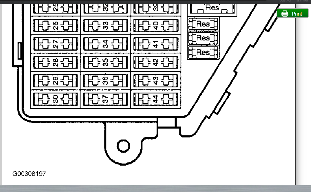

This could be a problem with fuse #38 in the main fuse panel on the left hand side of the dashboard. I have included in the diagrams down below a trunk lid wiring diagram, relay diagram, and completer main fuse panel diagrams for you. I have also included a link for you to go to below if you are unfamiliar with how to check a fuse.
Please go through these guides and get back to us with what you are able to find out.
