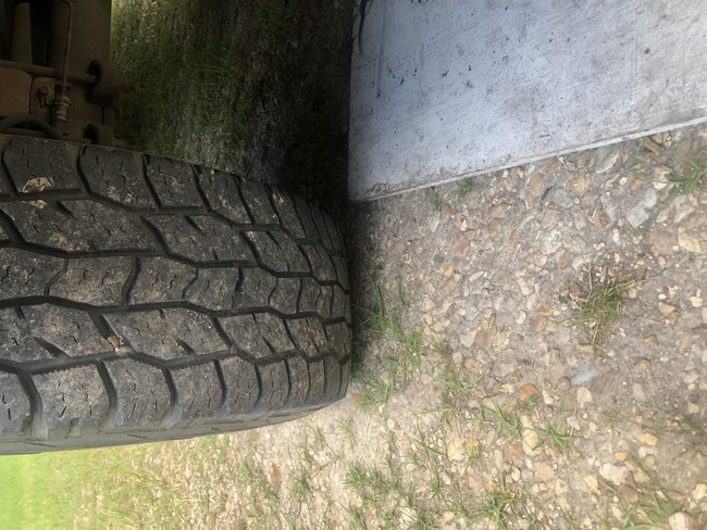

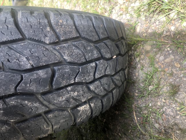

Does the shake and noise seem to be more prevalent at low speeds? Lets jack up the front and then the rear and spin the tires, we are looks for defects in the tires (cord separation). these guides can help:

No abnormal tire wear on the rear tires.

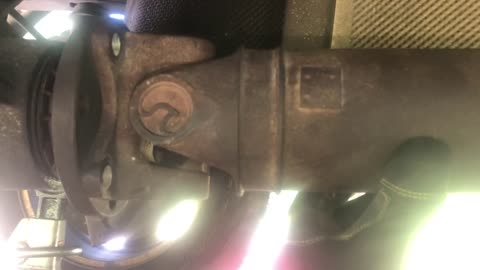

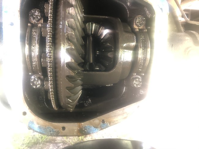

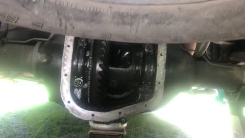

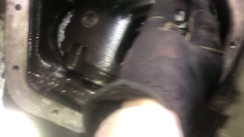

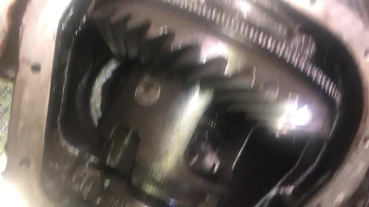

So far I am changing the fluids and here’s what a I did or videoed while the temperature cover was off...
May 29, 2021 at 12:39 AM
JAYYSN
  • 10 POSTS

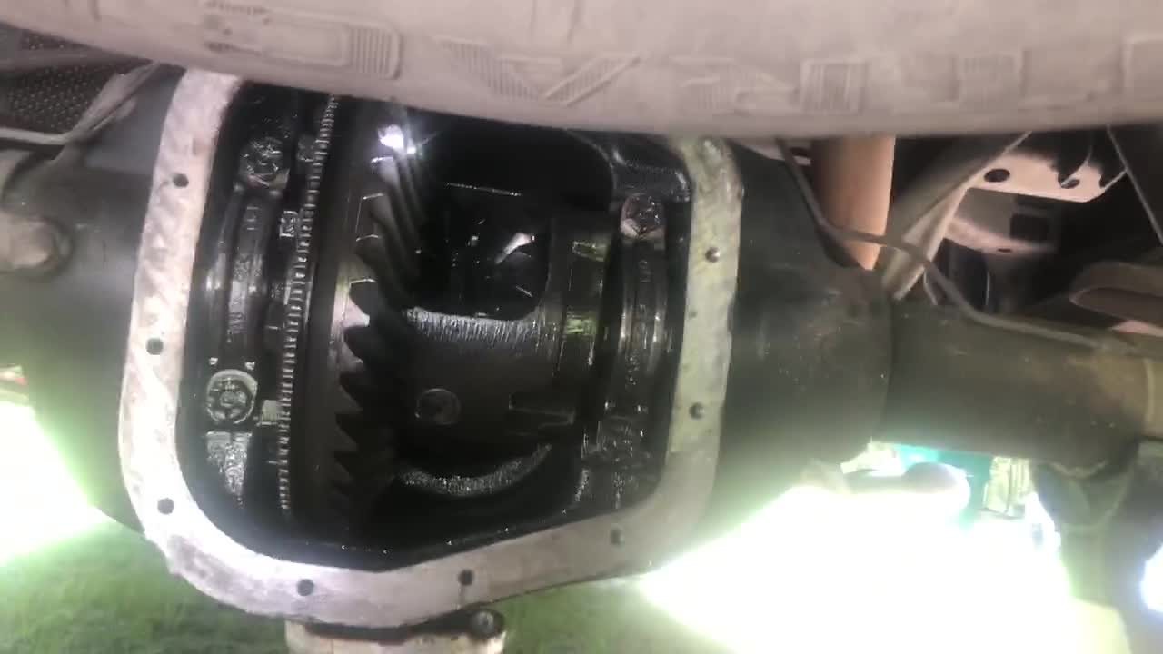

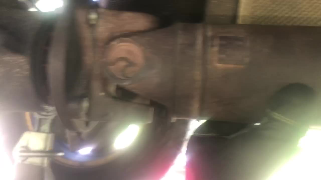

Videos with temperature cover off.

Right now the gasket maker is still curing so waiting on it’s final 24 hours to cure. When finished I will add the correct friction modifier and fill the rest with Amsoil rear temperature fluid. If this doesn’t fix will look into maybe changing the temperature clutches.

thanks for the videos. to remove the drive shaft you are on the right track, you must shock the driveshaft yoke to break it loose, it will not come off the transmission end. The play is normal in the gears for the mileage (little loose) can you tell if there is metal in the fluid? take a sample from the bottom off the diff housing. The tires look aggressive so they can be making noise even though nothing sticks out. Can you grab the rear wheels and see if one moves excessively up and down? It could be a axle bearing causing the issues. This video shows the job being done on a similar car but the process is the same:
https://youtu.be/zarxKsspr3s

Rewinding a week earlier. Also, the person who had the vehicle before me said they “replaced the rear end seals”. Prior to do doing the drain and refill job I noticed the diff was a quart low on fluid. Added the 1 quart 75w-140 it calls for (Valvoline Synthetic) until poured out fill hole. After there was no change in shuddering and rolling resistance. This weekend after I drained everything out and resealed the gasket I added 4 oz bottle of friction modifier and almost 3 quarts of Amsoil Synthetic 75w-140. I did notice as I was pouring in over a quart some of the fluid shot back out a couple times and I had to be careful until I noticed it was a steady stream pouring out down the side of differential to let me know it was full. So I assume the person who had the vehicle before me didn’t use friction modifier and didn’t add the correct amount of fluid. So far still has a light shudder but not as noticeable and rolling resistance at takeoff seems to be lessened. If it stays like this and doesn’t get any worse then I’ll leave it alone but if not then I’ll replace the clutch plates.
