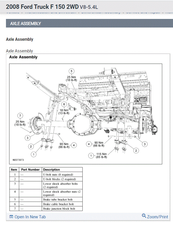

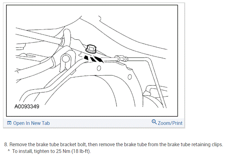

I'm trying to figure change out the rear end?
2008 FORD F-150
190,000 MILES • V8 • 2WD
MRSKETCH71
Jun 20, 2019 at 4:54 PM
  • 110,244 POSTS

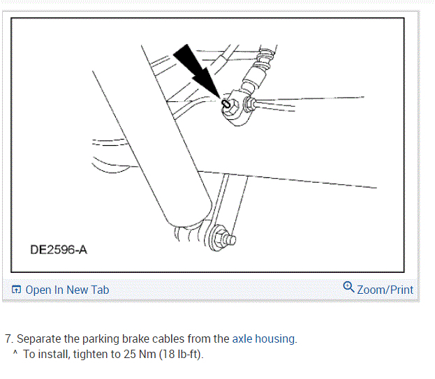

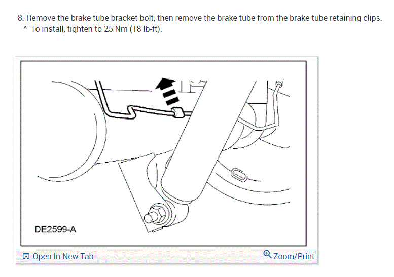

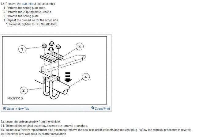

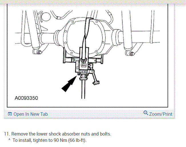

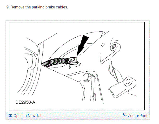

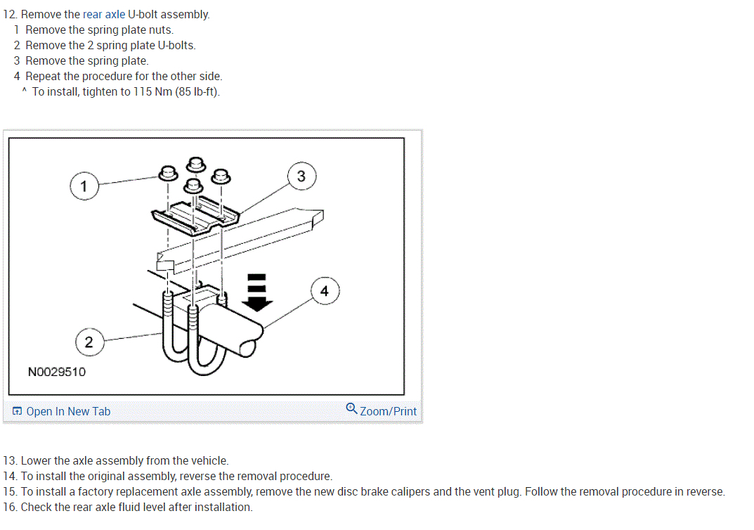

This is a somewhat big job. However, if you take your time, you should be fine.
The rear axle/differential assembly could be one of three different assemblies. I attached the directions below for the 9.75" differential which is the most common.
Take a look through the directions and let me know if they help. Also, if you know that the differential is other than the one I mentioned, let me know.
