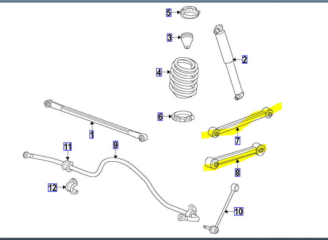

And back when letting off gas. like I’m sliding on ice. just had new tires put on yesterday. never felt this before.

That is odd. Do me a favor, check the control arms in the rear. They function as tracking arms. If one is bent or damaged in some way, the rear will not track properly. See if something is loose, bent, has a damaged bushing or anything is out of the ordinary.
I attached a pic below. Note there are two on each side. One is below the other.
