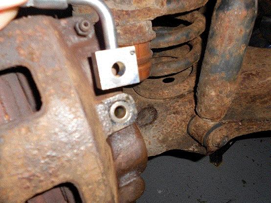

A rusted brake line gave way that went from drivers side brake hose to passenger side brake hose on a 2wd rear wheel abs 2001 Dodge Ram. The Service associate at Advanced gave me the wrong brake line at the store and I ended up trying to put the wrong fittings into my old brake hoses and stripped them. Now I am about to replace both front brake hoses after purchasing the correct parts.
However I see a pin (possibly a set pin) on the fitting of each new hose where it attaches to the caliper. I took off the drivers side old brake hose and it seems like there is only a round bump where the pin was on the old hose, but then I realized that there is no hole for a set pin on the caliper. So I looked at the passenger side and see that this pin is sticking up into the air from the old brake hose and doesn't even
touch the caliper.

I can't see a pin. If there is one on the banjo fitting, I don't believe it fits into anything. There should be, however, brass washers. This video should help you with the job which is done on a similar truck.

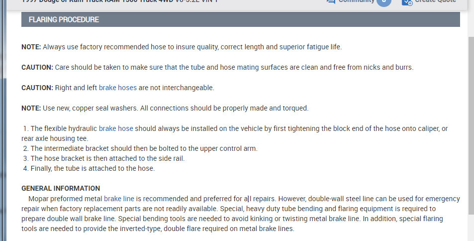

SHSGEEZER
My rear brake line rusted out right in front of the gas tank. I see that it's routed inside the frame rail next to the tank. Do you have to drop the tank to replace it? If you don't have flaring and bending tools, is it worth doing the job yourself? Is it a single line to the rear? Looks like it splits at a junction on the rear axle then goes to each wheel. How many hours labor would it be to have someone else do this?
Feb 27, 2021 at 3:51 AM (Merged)
  • 55,423 POSTS

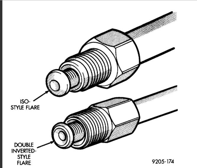

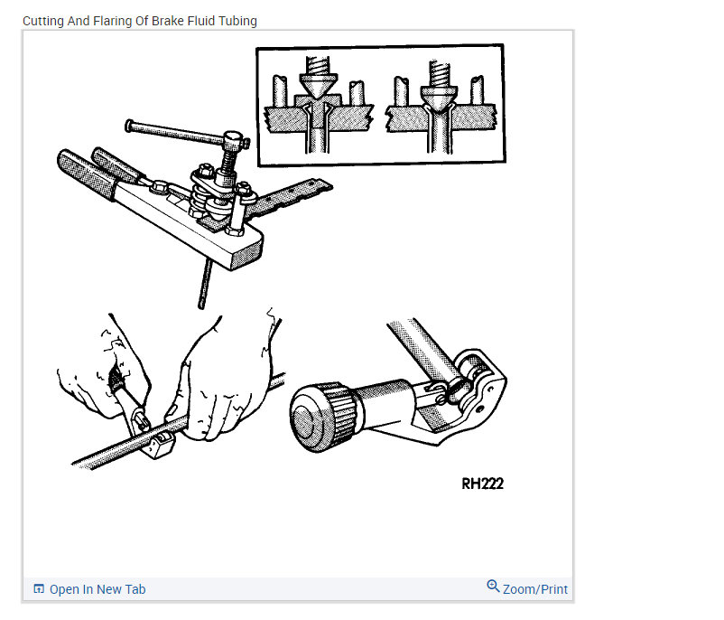

You do not need to remove the fuel tank, check the diagram below.

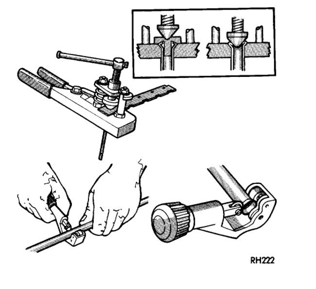

Special bending tools are needed to avoid kinking or twisting of metal brake tubes. Special flaring tools are needed to make a double inverted flare or ISO flare.

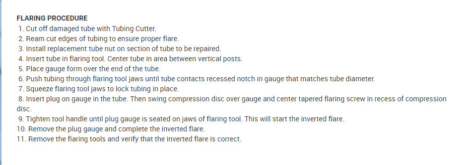

DOUBLE INVERTED FLARING
Cut off damaged tube with Tubing Cutter.
Ream cut edges of tubing to ensure proper flare.
Install replacement tube nut on the tube.
Insert tube in flaring tool.
Place gauge form over the end of the tube.
Push tubing through flaring tool jaws until tube contacts recessed notch in gauge that matches tube diameter.
Tighten the tool bar on the tube.
Cutting And Flaring Of Brake Fluid Tubing
Insert plug on gauge in the tube. Then swing compression disc over gauge and center tapered flaring screw in recess of compression disc.
Tighten tool handle until plug gauge is squarely seated on jaws of flaring tool. This will start the inverted flare.
Remove the plug gauge and complete the inverted flare.

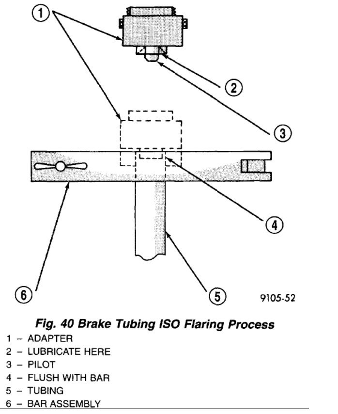

IS0 FLARING
To make a ISO flare use Snap-On Flaring Tool TFM-428 or equivalent.
Remove any burrs from the inside of the tube.
Install tube nut on the tube.
Position the tube in the flaring tool flush with the top of the tool bar. Then tighten the tool bar on the tube.
Install the correct size adapter on the flaring tool yoke screw.
Lubricate the adapter.
Align the adapter and yoke screw over the tube.
Turn the yoke screw in until the adapter is squarely seated on the tool bar.
