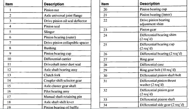

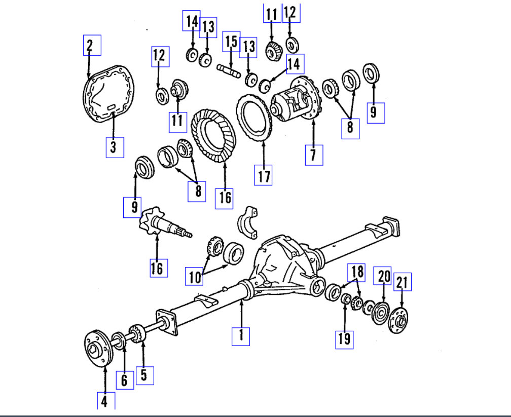

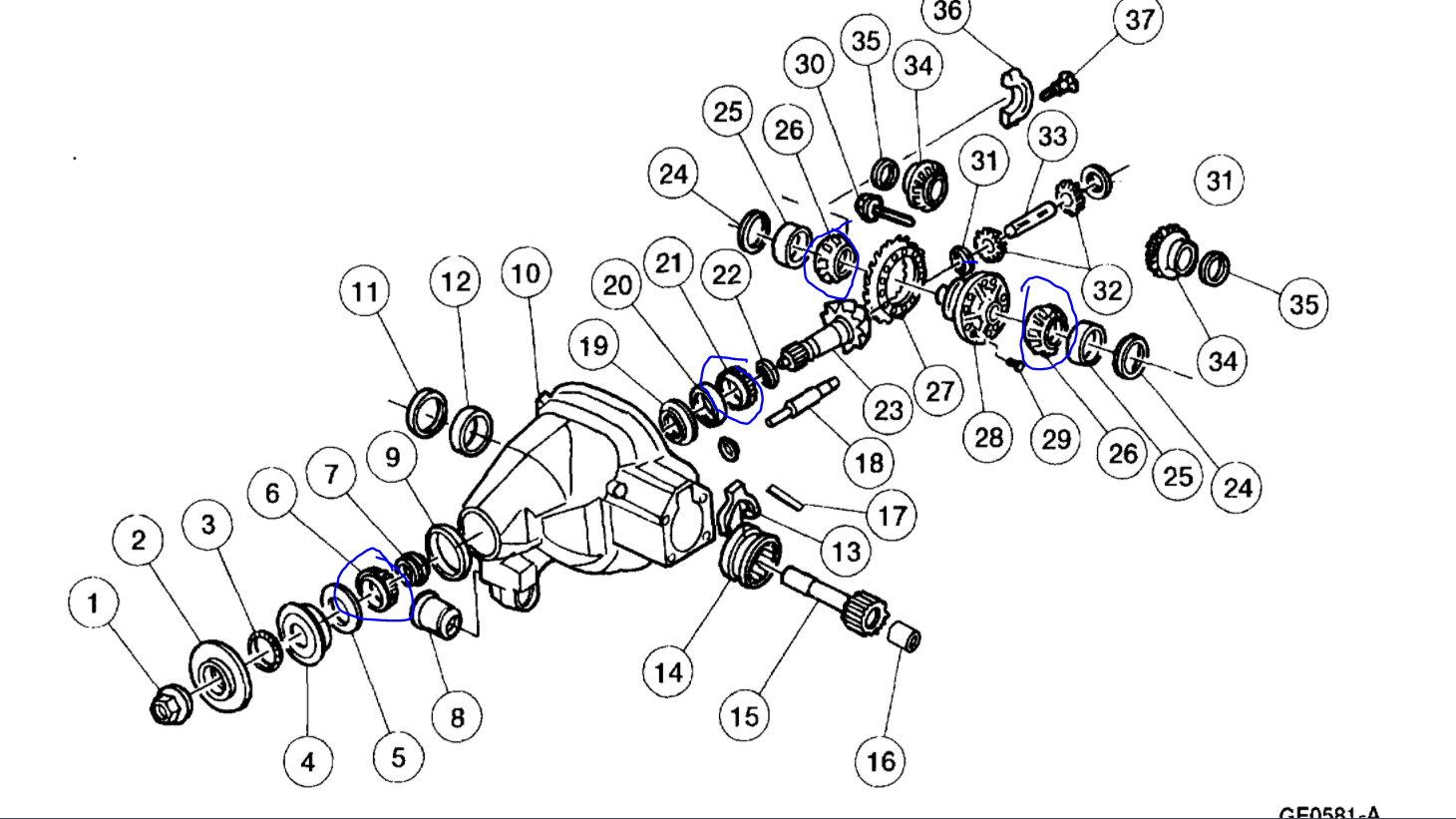

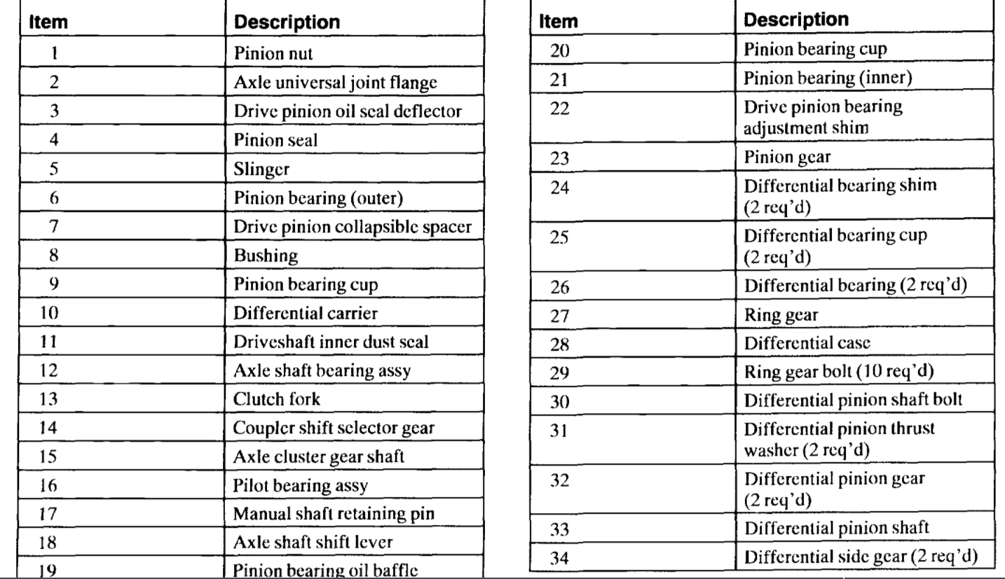

As far as the rear end, the bearing are worn and must be replaced. Basically, you will be replacing the carrier and pinion bearings in the differential.
https://www.2carpros.com/articles/how-a-differential-works
I attached diagrams of the bearings below. I also attached a YouTube video on the replacement.

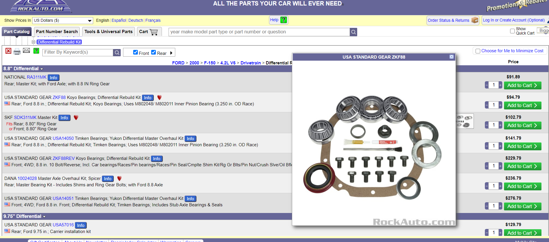

I have another question.. I'm trying to find out rear end size. Code on door says axle 18. Ratio 7. I looked it up the best I could. Got all different sizes. Need to know so I can get the 3 bearings for the pinion gear to stop howling. thanks
May 17, 2021 at 7:32 AM

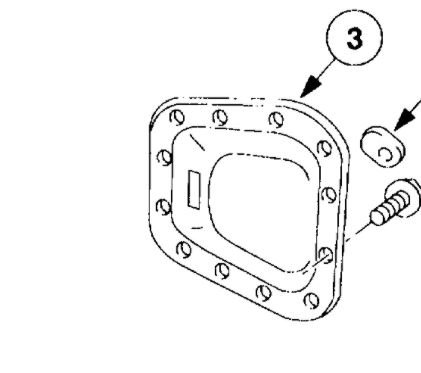

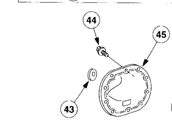

If you drop the rear cover, it will have the ratio on the back of the pinion.
No, you need 4 bearings and 4 races, not 3.
I attached 2 pictures of the rear differential cover. One is 8.8 and the other is 9.25. That is how you tell what differential.

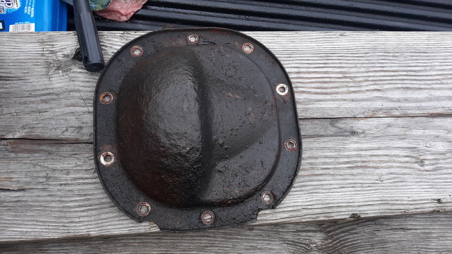

Neither pic looks like my cover. it's also 10 bolt with 2 notches on it.
Can you post a picture of the cover?

This is the cover.

Thanks.
That is the first picture I attached. You have the 10 bolt rear, that is the small rear.

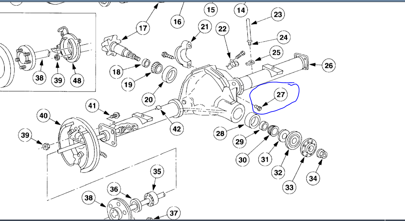

The fill plug is not on the cover, it is in the housing.

I could not find a fill plug anywhere. I figured you pull the sensor out and fill it there. It's a good size hole.
No, the fill plug is at the rear.
I attached a picture for you to view.
JACKNUT
  • 65 POSTS
I saw the pic. there is no explanation for the numbers, lol. And still, what rear end do i have and will the 1991 be the same?
The part I circled is the fill plug in the picture.
You have an 8.8 differential in your truck. It is a 10 bolt rear.
The parts I attached are the correct parts for your truck.
