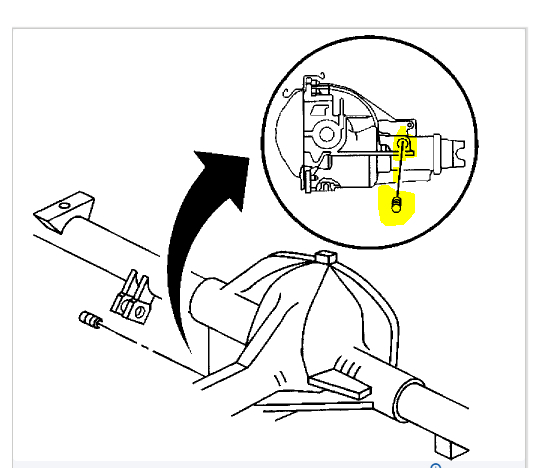

When driving, do you ever notice the sound (to some degree) when making turns? I ask because it could be an axle bearing going bad. However, they usually will make a howling noise to some degree when turning or driving.
If possible, record the sound and upload it for me to hear. Hopefully, I will be able to identify it.
Also, have you checked to make sure the fluid is full in the differential? There is a fill port on it. It's on the passenger side inner portion of the differential housing. Usually, all you need is a 3.8" ratchet to open it. The gear oil should be to the bottom of the opening when the fill plug is removed. If you haven't, check that. See pic below
