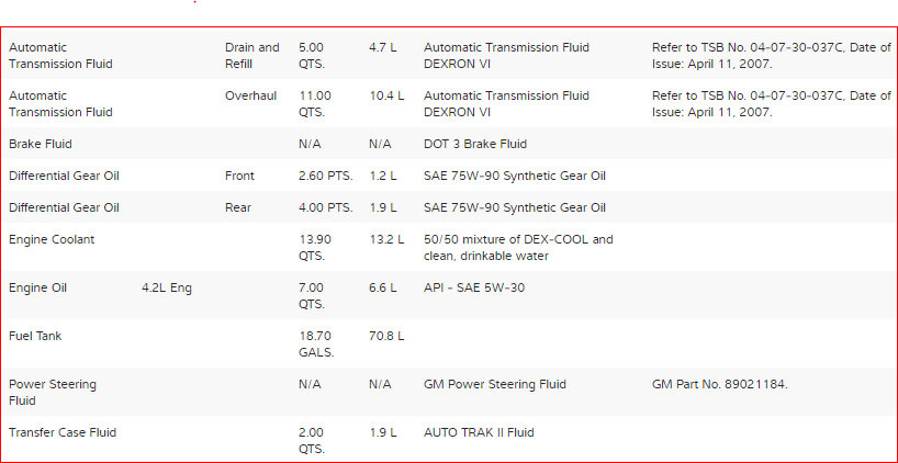

I have a howling sound in rear end louded when slowing down sometimes when I’m driving it feels like someone is pulling me the other direction when I go to a complete stop the gears like somebody would be jamming them in like a clunk clunk but not extremely loud I dive in auto-aim I supppose to drive in 2wd can that be problem

To be honest the howling sound in a rear differential with 200K miles is usually the gearset just being worn out.The clunking is also related to just being high mileage or possible worn u-joints in the driveshaft.These are both easily repairable.You should go to a repair shop the specializes in drivelines and have them take a listen to the sound and inspect the u-joints.Here is a tutorial showing how a differential works.

One more thing I drove my truck today put it in 4wd sound was louder the howling then put it in 2wd and drove it didn’t make the sound and I drove it for a few hours do you know anything about that

The 4x4 transfer case requires oil changes as well.That is what couples the front and rear differentials together when the 4 wheel drive is engaged.Have you performed routine service on the differentials as well as the transfer case? Your cars specifications are below.Hope this helps and thanks again for using 2CarPros.
