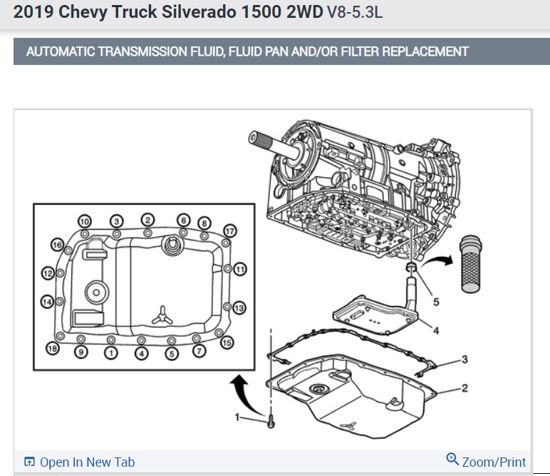

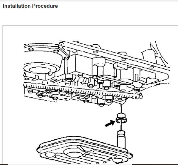

Leaving the house, 150' down the road it felt as if I was hit from behind (only going about 15 mph). No one behind me I thought it weird. Made a left, drove about 160', made another left, then backed into a drive on the right side of the road. Helped a neighbor for about an hour. I think a transmission service will help me can you tell me how?
May 5, 2019 at 5:41 PM
This video shows the job being done on a similar car but the process is the same with diagrams below for your car.
https://youtu.be/NUOBl4bqtss
Here is a guide to help you step by step with instructions in the diagrams below to show you how on your car.

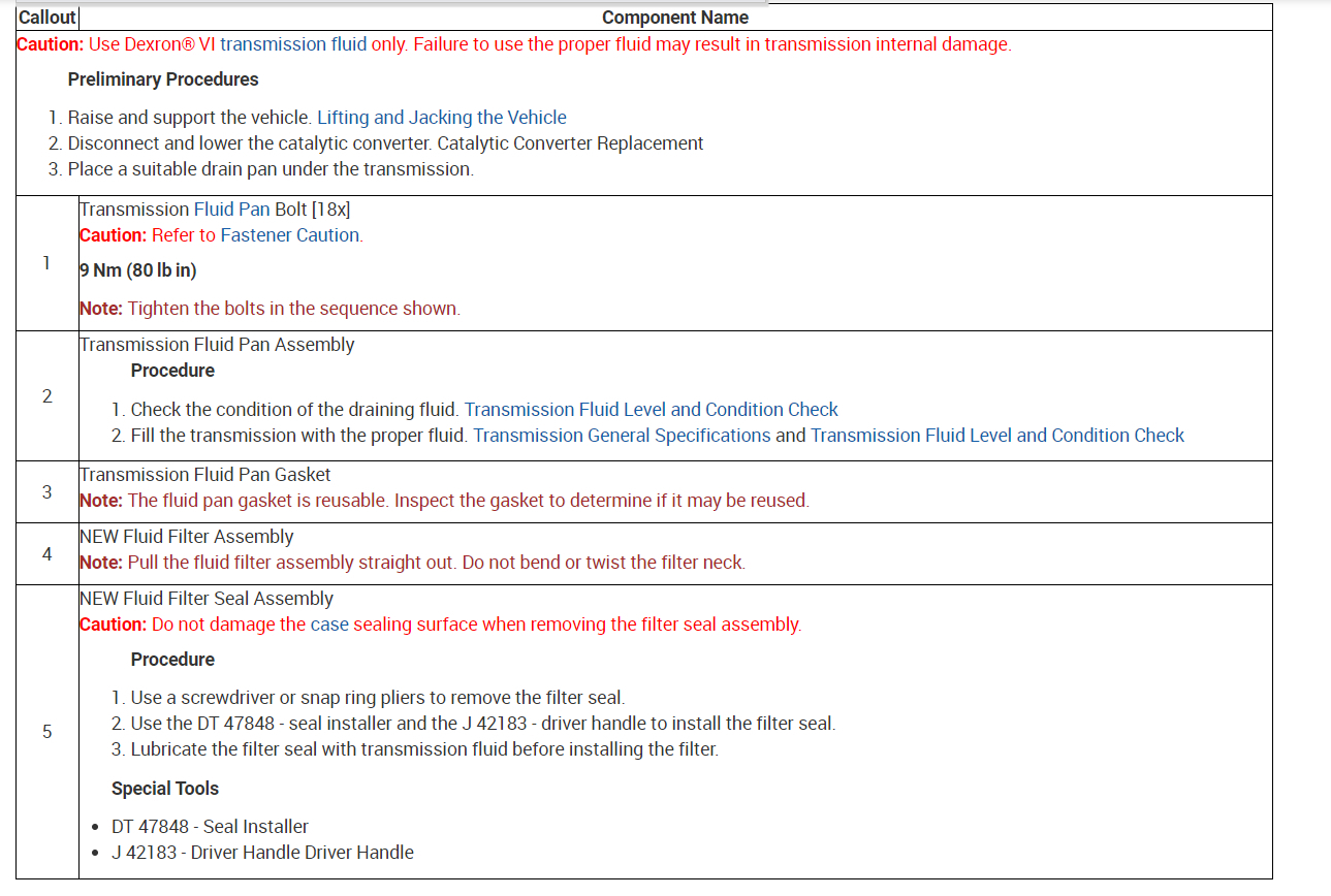

what are the repercussions for putting dex III when it calls for dexVI only in a silverado transmission? Had the transmission flushed today and checked after what they put in it by their paperwork against what the dipstick says. Apparently they put the wrong fluid in. What should I do?
May 6, 2021 at 10:06 AM (Merged)
  • 110,194 POSTS
Have it removed and the proper fluid replaced. If you do it right away, it won't hurt anything. However, they need to flush the system and not just drop the trans pan to get all the wrong fluid out. This guide can help you step by step.

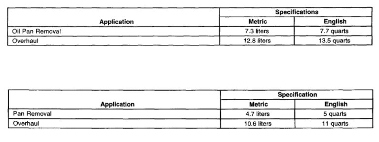

BRODIE1666
some of the pages of my manual were torn out,,,what is the capacity of the transmission for a 5.3L V8 when u do a simple pan drop and filter change ? thanks jim
May 6, 2021 at 10:07 AM (Merged)
  • 75,992 POSTS
Transmission Fluid
4L60-E
Pan Removal 4.7L (5.0 Qt)
Overhaul 10.6L (11.0 Qt)
4L80-E
Overhaul 12.8L (13.5 Qt)
Pan Removal 7.3L (7.7 Qt)
Allison
Overhaul 12.0L (12.7 Qt)
Fluid and Filter Change 7.0L (7.4 Qt)

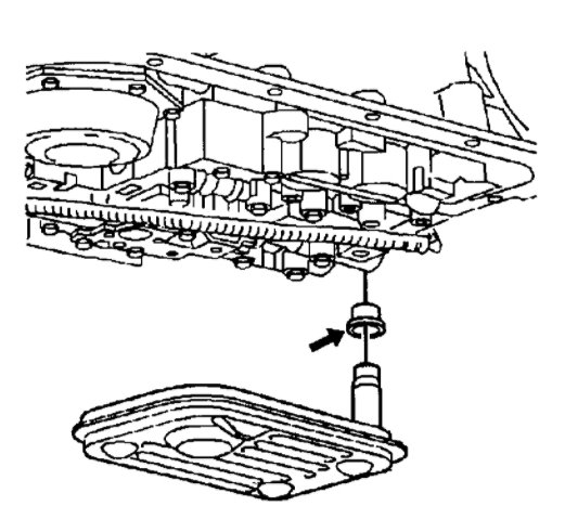

Good evening,
Waiting to change it can harm the transmission. I would definitely change the oil/filter.

DOCFIXIT
  • 18,828 POSTS
The transmission holds
4L60-E
Pan Removal .................... 4.7L (5.0 Qt)
Overhaul .................... 10.6L (11.2 Qt)
4L80-E
Pan Removal .................... 7.3L (7.7 Qt)
Overhaul .................... 12.8L (13.5 Qt)
This guide will show you how to service the unit.

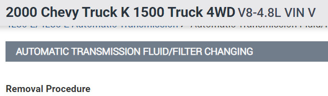

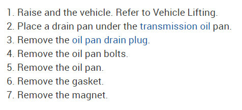

DANNY L
  • 5,648 POSTS
Hello, I'm Danny
Here is a tutorial to show you how to service an automatic transmission.
I've attached picture steps below for transmission service below for your truck. It states what type of fluid to use and I've also attached a capacity picture. Hope this helps and thanks for using 2CarPros.

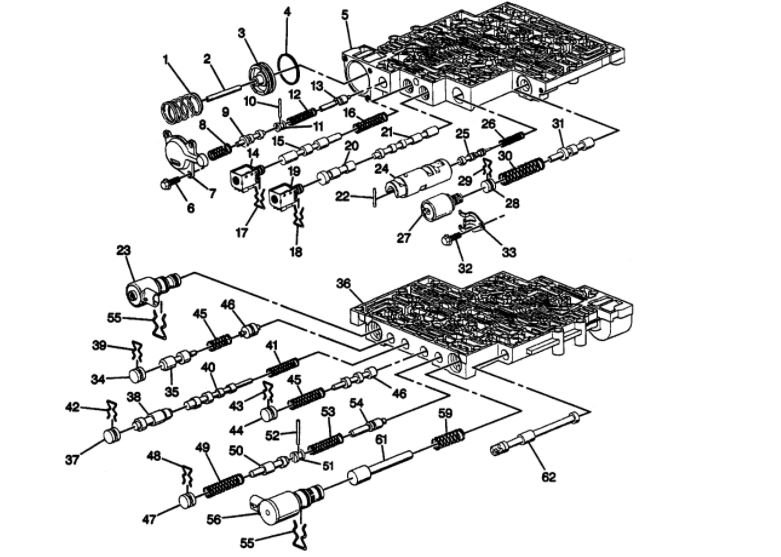

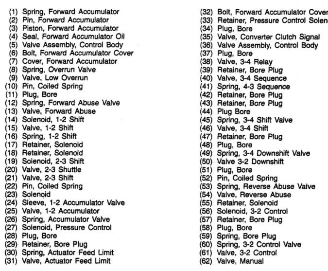

SWEETIE1965
  • 181 POSTS
I recently purchased this truck and everything was fine with it until about a week ago. When I come to a complete stop, the truck tries to lunge forward. Idle is normal, brakes are fine. I was driving the other day, then the on dash temperature gauge shot up to extremely hot. So I changed the thermostat and the temperature sensor. The gauge is stuck on hot. I check the coolant on a daily basis along with all other fluids. I pulled the two front tires off to inspect the brakes. They are fine and seems to work as they should. The rear brakes are drum style brakes. To my knowledge the emergency/parking brake does not work properly. I've checked for vacuum leaks. Didn't find any. What could cause this problem and how to I repair it? Thanks for your help in advance
May 6, 2021 at 10:08 AM (Merged)
Good morning,
This sounds like the transmission is downshifting into low gear too late causing it to surge forward.
I would change the fluid and filter in the transmission to start as it may be the downshift valve as the issue.
SWEETIE1965
  • 181 POSTS
There is no DTC'S for the transmission. The only DTC is crank/cam correlation.
There will be no dtc for the valve body. There are solenoids but if they were the issue, it would code.
Your issue is mechanical, not electrical. I think you have sticking valves in the valve body itself.

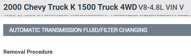

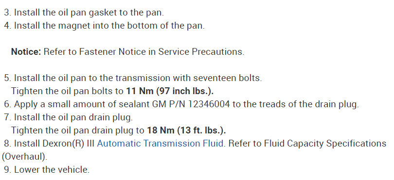

SEAN0308
  • 23 POSTS
Hi, I have the k1500 model. I am getting ready to change the transmission fluid. I tried tightening the bolts and wiped the pan down but it still leaks slowly. I am also going to change the filter and pan gasket. How much transmission fluid do I need? Also, should I use Dexron 3 or dexron 5 or dexron 6. Also, is is Castrol fine to use or should I get a different brand? Thanks.
May 6, 2021 at 10:09 AM (Merged)
HMAC300
  • 48,601 POSTS
for the transmission gasket wipe some RTV on one sides , if you can check pan because bolts may have been over tightened at one time and are bent that also causes leaks. for fluid for trans you need five quarts and DextronIIe any band with that rating if not use DextronIII.

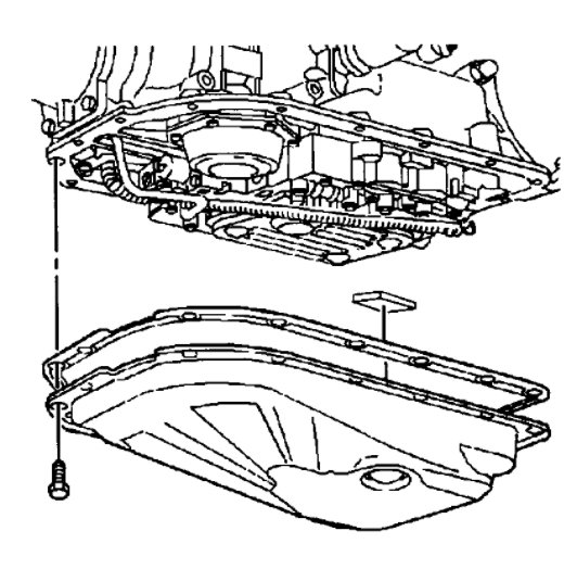

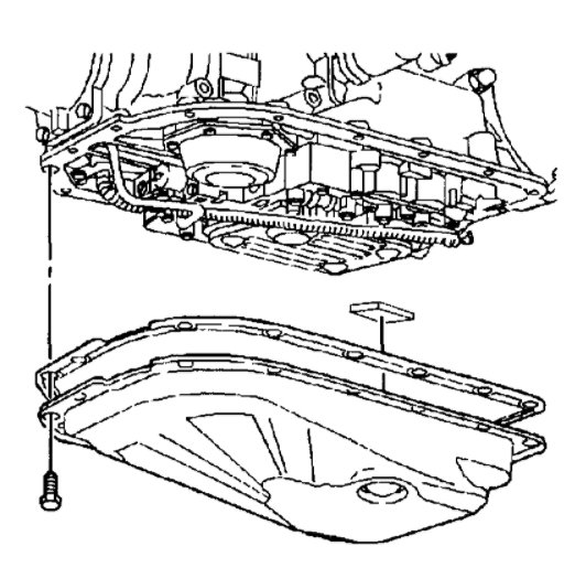

DDEBRU01

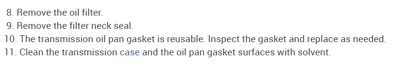

I started to remove the tranny fluid pan only to discover that there are two bolts I cannot get at. The back two bolts are under the tranny cross bar(?). How do I get to these bolts so I can replace the filter? Help I'm stranded without my truck.
Thanks
HANDYRANDY1027
  • 8 POSTS
1st if the filter and fluid have not been changed regularly then dont change it or you will mess up your trans but the best way I can think of is to put a jack under the trans. Then take the bolt out of the cross member going into the trans and then there should be four bolts 2 on each side of the cross member, remove those and the cross member should come out then you will be able to get to those bolts. good luck.
