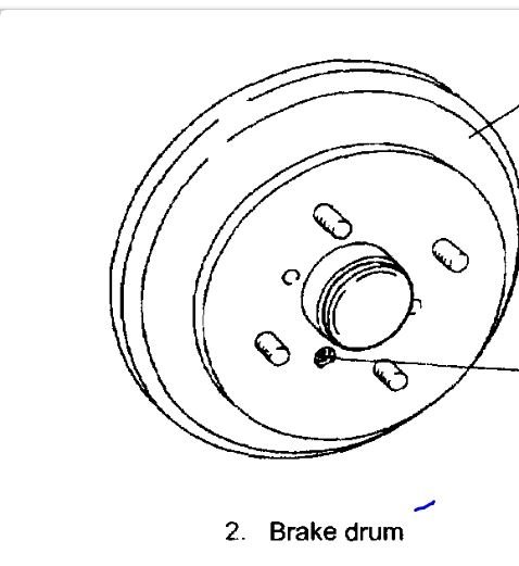

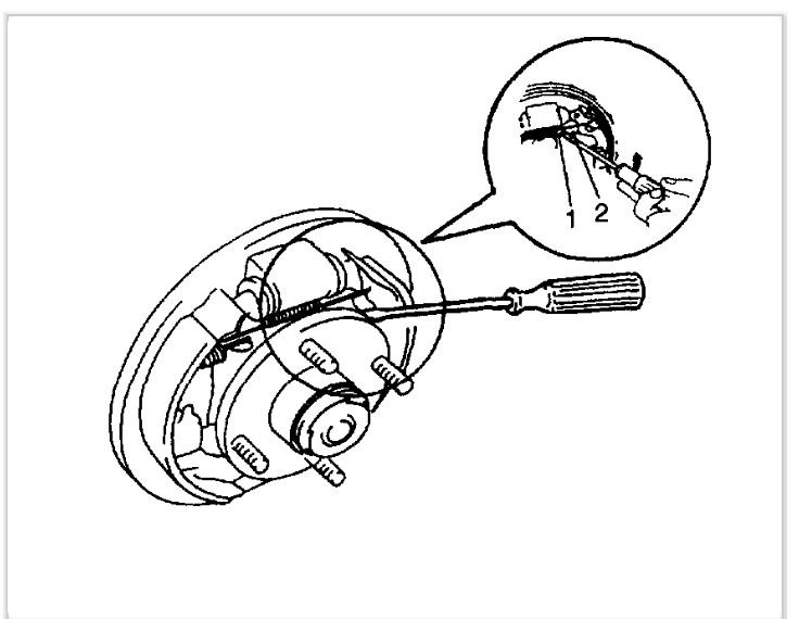

I cannot locate the removal screw. I guess there is one that needs to be removed prior to removing the drum. How to do the rear brakes on this specific car would be helpful.

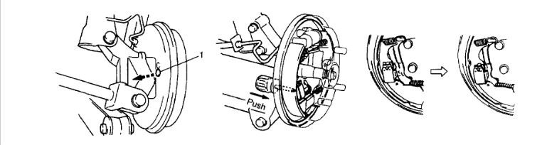

The parking brake release will give you clearance then the drum presses off with two 8mm bolts. I'll post the procedure below.

2. Remove brake drum screw (1).

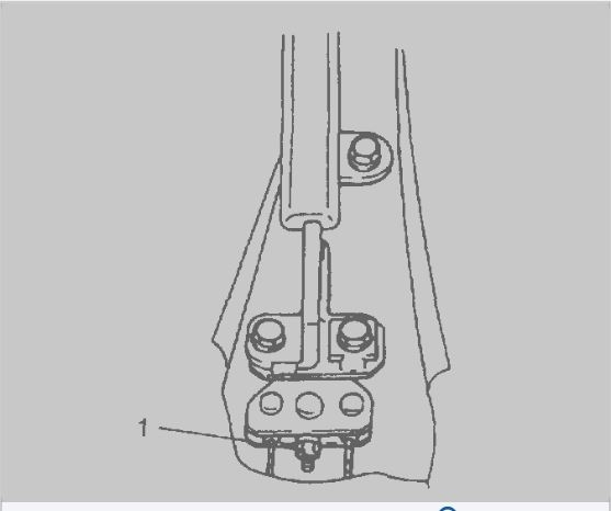

4. Remove console box and loosen parking brake cable locking nut (1).

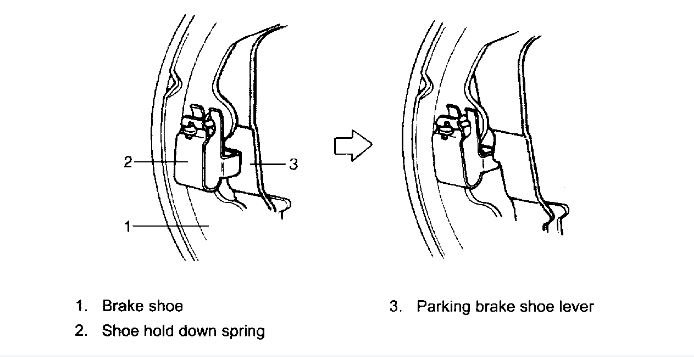

5. Remove back plate plug (1) attached to the back side of brake back plate so as to increase clearance between brake shoe and brake drum.
Insert a screwdriver into plug hole till its tip contacts shoe hold down spring and push screwdriver in the arrow direction.
With this push, hold down spring is pushed up and releases parking shoe lever from hold down spring, resulting in larger clearance.

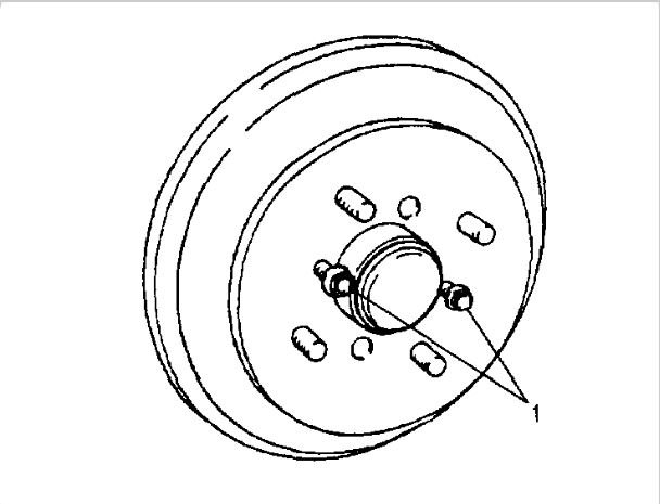

6. Pull brake drum off by using 8 mm bolts (1) (2 pieces).

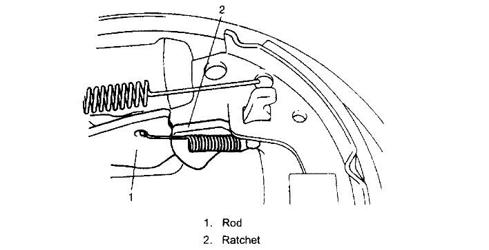

1. Before installing brake drum, to maximize brake shoe-to-drum clearance, put screwdriver between rod (1) and ratchet(2) and push down ratchet as shown in figure.
NOTE: The figure show ratchet position where brake shoe-to-drum clearance is maximum.
2. Put brake shoe hold down spring back to its original position as shown. (Put shoe hold down spring in place by moving shoe lever so that shoe lever comes to the side of shoe hold down spring.)
