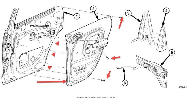

rear drivers side door stuck closed?
2006 CHRYSLER PT CRUISER
125,000 MILES • 2.4L • 4 CYL • 2WD • AUTOMATIC
ROGER D 1
rear drivers side door is stuck closed. I cannot get the door panel off to look at the latch mechanism.
Nov 17, 2016 at 11:27 PM
HMAC300
  • 48,601 POSTS
yes you can, it is just a pain to do. remove the screws and then pull door panel or put a screwdriver or small pry tool behind to pull it off then disconnect door handle then check for broken clips inside where door rods connect. see picture.
