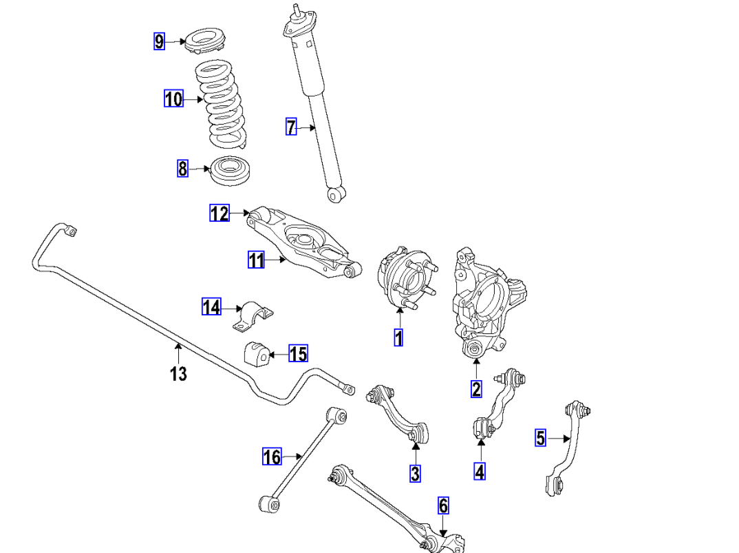

I was driving one day and a person honked behind me and pulled into the gas station and pulled in and told me that my back driver side tire was leaning out words like it has negative camber, but it's only the driver side left tire. but in within a week it progressively got worse and lot more noticeable. what could be causing this? I'm on a budget and I cannot afford all the parts that I've researched that may be causing this. I need help diagnosing.

Good evening,
I attached a picture of the rear suspension for you.
You will need a shop to look at this and see which component is bent. Most likely you hit something and one of the arms is bent.
Keep us updated.
