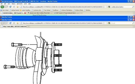

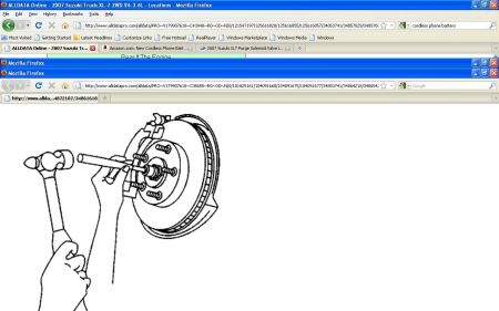

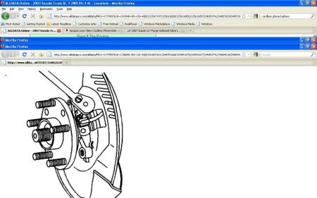

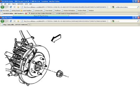

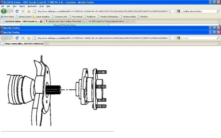

The cheapest i saw one was for 117 for a duralast at auto zone there timken one was 200 which is a good brand but they have a timken for 160 and a acdelco one for 248 at www.rockauto.com plus i have a 5 percent off discount code for them.I have gotten a lot of part's from them there pretty price's on most of there stuff.I would go with timken.It's not a bad price at 160 and it's good quality if you decide to get it from rock auto let me know and i will give you the 5 percent discount code.Or if you find it cheaper somewhere else that's great too.It's not that hard to do they only charge 1.5hrs labor i posted the instruction's on how to replace it for you.
https://images.2carpros.com/forum/automotive_pictures/416332_2004_gmc_envoy_front_wheel_hub_assembley_part1_1.jpg
https://images.2carpros.com/forum/automotive_pictures/416332_2004_gmc_envoy_front_wheel_hub_assembley_part2_1.jpg
https://images.2carpros.com/forum/automotive_pictures/416332_2004_gmc_envoy_front_wheel_hub_assembley_part3_1.jpg
https://images.2carpros.com/forum/automotive_pictures/416332_2004_gmc_envoy_front_wheel_hub_assembley_part4_1.jpg
https://images.2carpros.com/forum/automotive_pictures/416332_2004_gmc_envoy_front_wheel_hub_assembley_part5_1.jpg
2004 GMC Truck Envoy 4WD L6-4.2L VIN S Front Wheel Hub, Bearing, and Seal Replacement Removal Procedure 1. Remove the tire and wheel center cap. 2. Remove the drive axle nut. 3. Raise and support the vehicle. Refer to Vehicle Lifting. 4. Remove the tire and wheel. 5. Remove the brake rotor. 6. Disengage the wheel drive shaft from the wheel hub and bearing. Place a brass drift against the outer end of the wheel drive shaft in order to protect the wheel drive shaft threads. Sharply strike the brass drift with the hammer. Do not attempt to remove the wheel drive shaft from the wheel hub and bearing at this time. 7. Remove the ABS sensor mounting bolt from the wheel hub and bearing. 8. Remove the ABS sensor from the wheel hub and bearing. 9. Remove the wheel hub and bearing to the steering knuckle mounting bolts. 10. Remove the wheel hub and bearing from the steering knuckle. 11. Remove the splash shield from the steering knuckle. Installation Procedure 1. Install the splash shield to the steering knuckle. Align the splash shield to the steering knuckle threaded holes. 2. Install the wheel hub and bearing to the steering knuckle. Align the threaded holes. 3. Install the wheel hub and bearing to the steering knuckle mounting bolts. Tighten the wheel hub and bearing mounting bolts to 105 Nm (77 ft. lbs.). 4. Install the ABS sensor to the wheel hub and bearing. 5. Install the ABS sensor mounting bolt to the wheel hub and bearing. Tighten the ABS sensor to the wheel hub and bearing mounting bolt to 18 Nm (13 ft. lbs.). 6. Install the brake rotor. 7. Install the tire and wheel. 8. Lower the vehicle. 9. Install the drive axle nut. Tighten the drive axle nut to 140 Nm (103 ft. lbs.). 10. Install the tire and wheel center cap.
