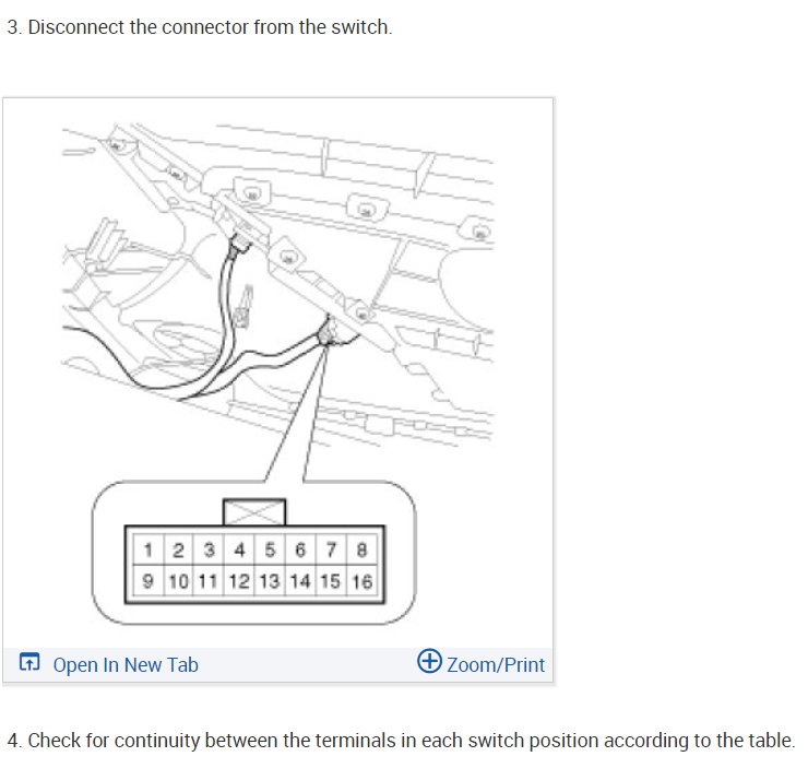

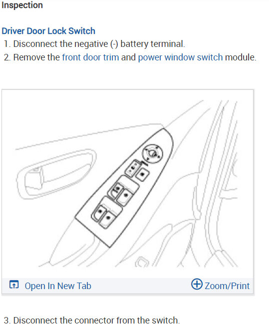

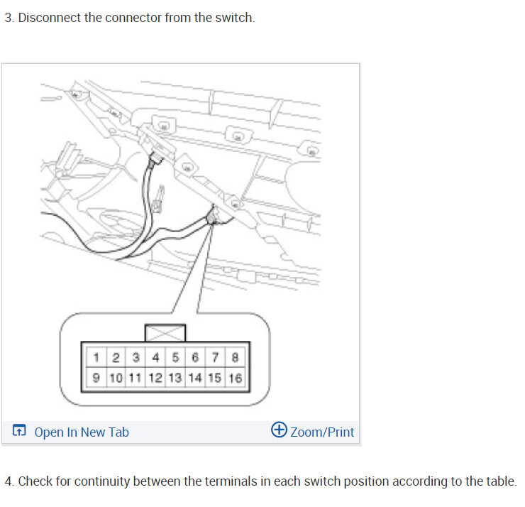

The back doors locked and cannot be opened manually or by the key.
Aug 28, 2024 at 11:40 AM
  • 55,721 POSTS
I have seen the main door lock switch go bad and hold the rear door locks on, let's unplug the switch to see if the problem goes away. Here is how, check out the images (below). Let us know what you find.
