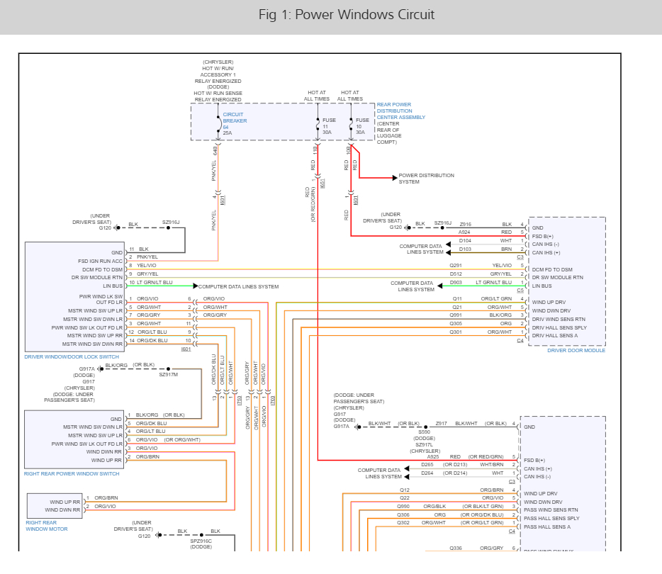

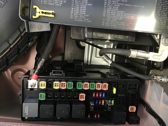

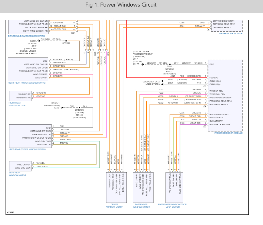

Windows used to go up and down, but now they do not move. I thought there might be a fuse for the two window motors but could not find. According to the drivers manual Fuse #64 is labeled Rear Window (Charger/300), a 25 amp breaker mini-fuse. That space is empty. This is in the Rear Power distribution box in the trunk.
Jul 13, 2019 at 10:47 AM
SCGRANTURISMO
  • 4,897 POSTS

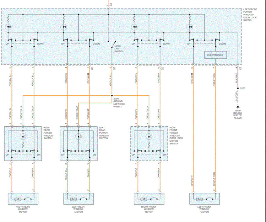

That is correct. Replace this circuit breaker and see if it works there is a drivers door module that goes out as well here are the window wiring diagram so you can see how the system works. Check out the diagrams (Below). Let us know what happens and please upload pictures or videos of the problem.

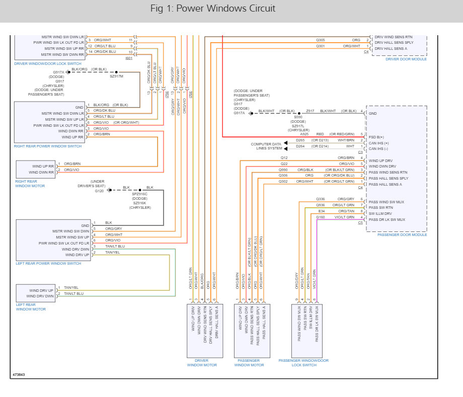

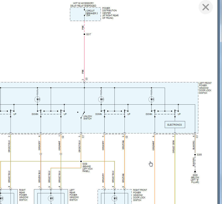

If the window is working at all, then chances are the main switch on the driver's door is bad. If you look at the attached picture, you will see that all the power to all windows goes through the main switch. That leads me to believe there is an issue with the switch itself (main switch).
Take a look at the attached wiring schematic. You will see what i am referring to.
Let me know if you have questions.
May 21, 2021 at 4:43 PM (Merged)
EBERTO BRANDO
The back windows open when I control them with my driver switch. Do you think I should get it replaced? Or could it possibly be a fuse?
  • 110,194 POSTS
Since some of them do work, that tells me fuse is good. All power is directed through the main switch and provided from one place. Did both window problems start at the same time?

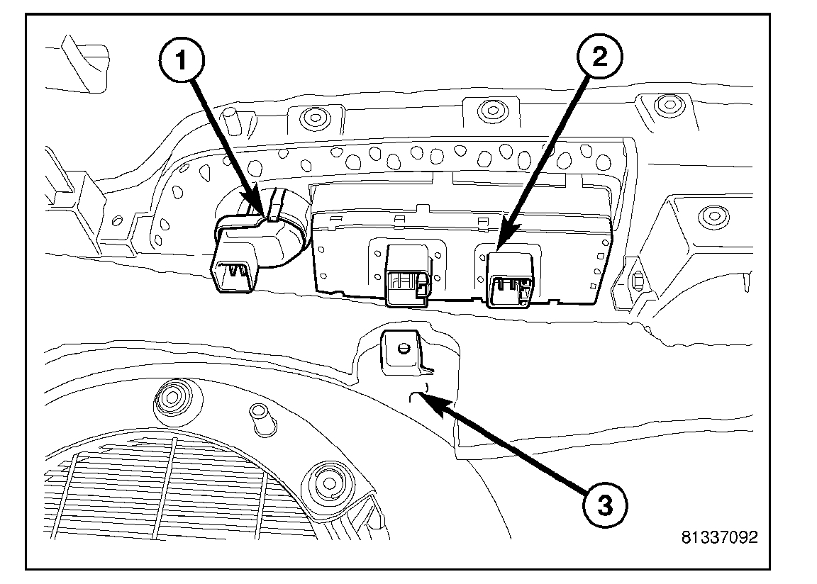

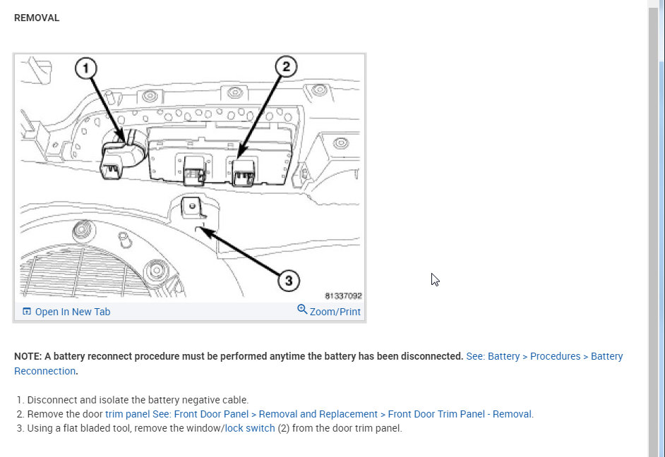

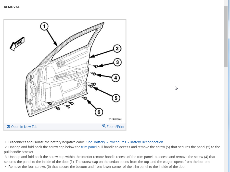

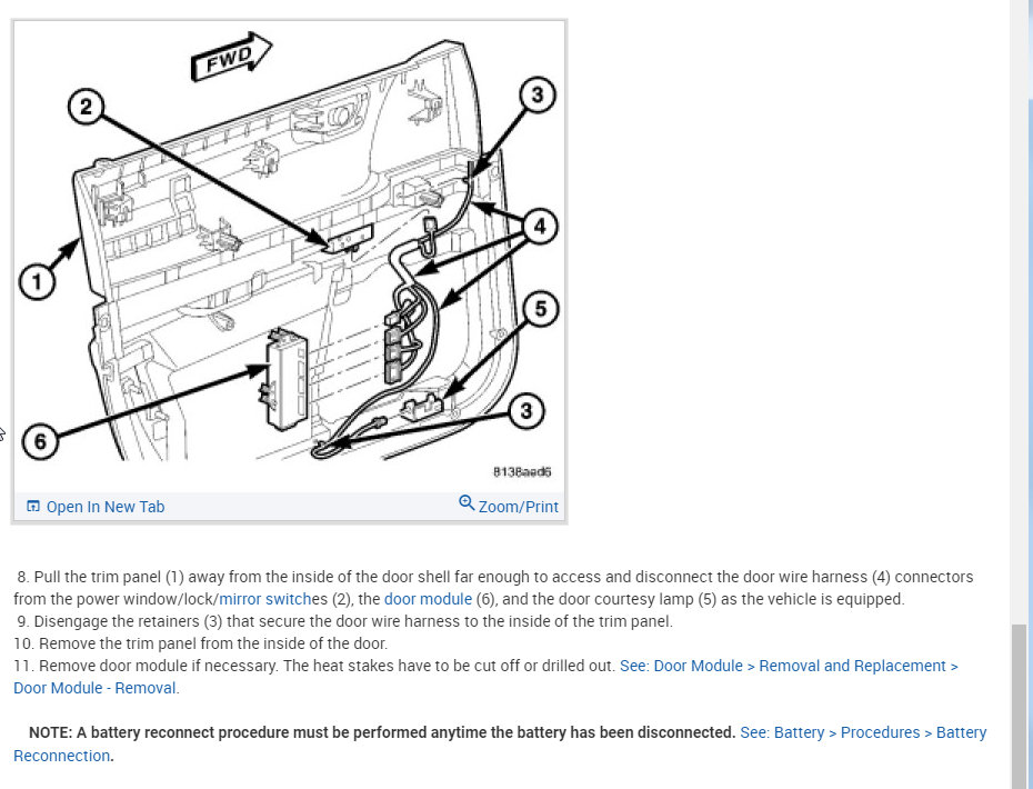

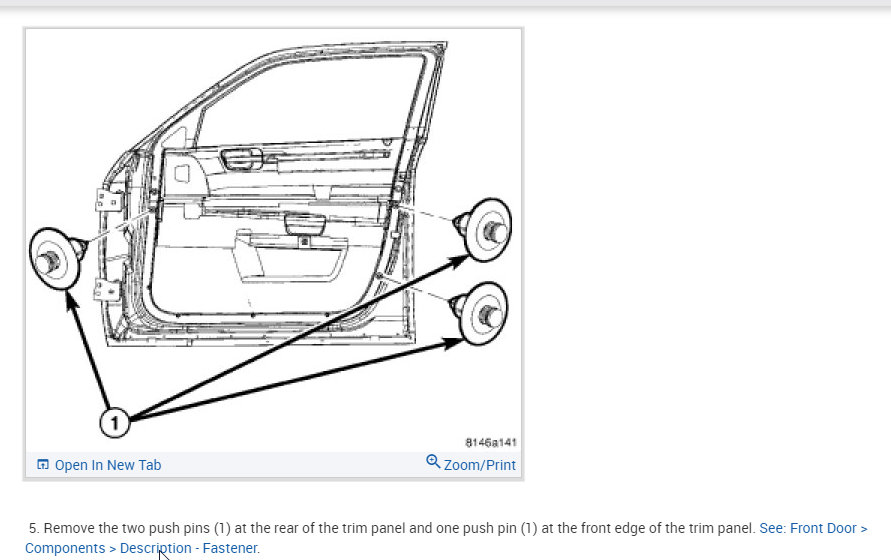

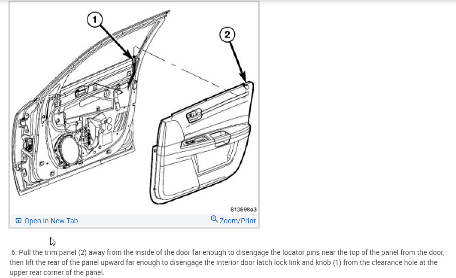

I suspect that is the problem. Here are directions for removal and replacement:
____________________
2005 Chrysler 300 V8-5.7L VIN H
Switch-Window/Door Lock
Vehicle Sensors and Switches Sensors and Switches - Windows and Glass Power Window Switch Service and Repair Procedures Switch-Window/Door Lock
SWITCH-WINDOW/DOOR LOCK
NOTE: A battery reconnect procedure must be performed anytime the battery has been disconnected.
REMOVAL
pic 1
1. Disconnect and isolate the battery negative cable.
2. Remove the door trim panel.
3. Using a flat bladed tool, remove the window/lock switch (2) from the door trim panel.
INSTALLATION
pic 2
1. Install window/lock switch (2) to door trim panel and snap into place.
2. Install door trim panel.
3. Connect battery negative cable.
__________________________

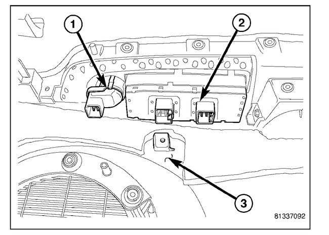

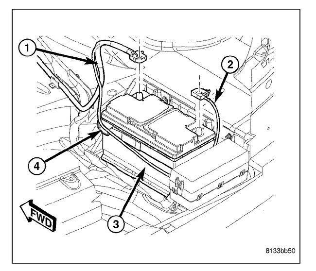

Here is the battery reconnect procedure.
Battery System
Vehicle Starting and Charging Battery Service and Repair Procedures Battery System
BATTERY SYSTEM
BATTERY RECONNECTION
NOTE: This reconnection procedure is to be performed anytime the battery has been disconnected.
pic 3
1. Connect the battery negative cable (2) to the battery post and tighten the clamp nut.
2. Install the rear compartment floor trim panel.
CAUTION: Once the battery has been connected, review and perform the following information as applicable.
AUTO UP FRONT WINDOW
If the vehicle is equipped with the auto-up front window feature, once the battery is reconnected the door module needs to be calibrated. The door module requires calibration anytime the battery or door module has been disconnected for any length of time. To calibrate, perform the following:
1. Turn the Ignition to the Run position.
2. Regardless of current window position, move the driver side front window upward until the window stalls in the full up position. Allow the window motor to stall for at least 2 seconds before releasing the switch.
3. Move the driver side front window downward until the window stalls in the full down position. Allow the window motor to stall for at least 2 seconds before releasing the switch.
4. Move the driver side front window upward until the window stalls in the full up position. Allow the window motor to stall for at least 2 second before releasing the switch.
5. Repeat steps 2, 3 and 4 for the passenger side front window.
6. Verify the windows are properly calibrated by operating the express down and up features on the windows. Repeat this procedure if the calibration failed. If unable to properly calibrate after the second attempt, check the Driver's Door Module (DDM) and Passenger's Door Module (PDM) for Diagnostic Trouble Codes (DTCs) and correct as required.
