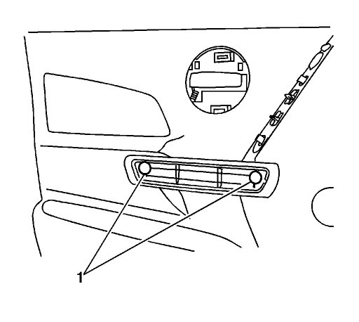

need to put in a new window regulator motor.

Removal procedure:
Insert a flat-bladed tool at the front edge of the door handle bezel. Pull the bezel away from the door to disengage the retaining clips.
Use a flat-bladed tool to remove the cover plate from the armrest pull handle (first image).
Using a thin walled socket, remove the screws (1) from the pull handle (second image).
Beginning at the lower rear of the door, use J 38778 to disengage the trim panel from the rear door inner panel.
Lift the trim panel to disengage the channel at the top edge and to clear the door lock button.
If equipped, disconnect the electrical connector for the power window switch.
Remove the rear door trim panel from the vehicle.
Third image just for panel view on clips. Good luck and hope instructions help.
