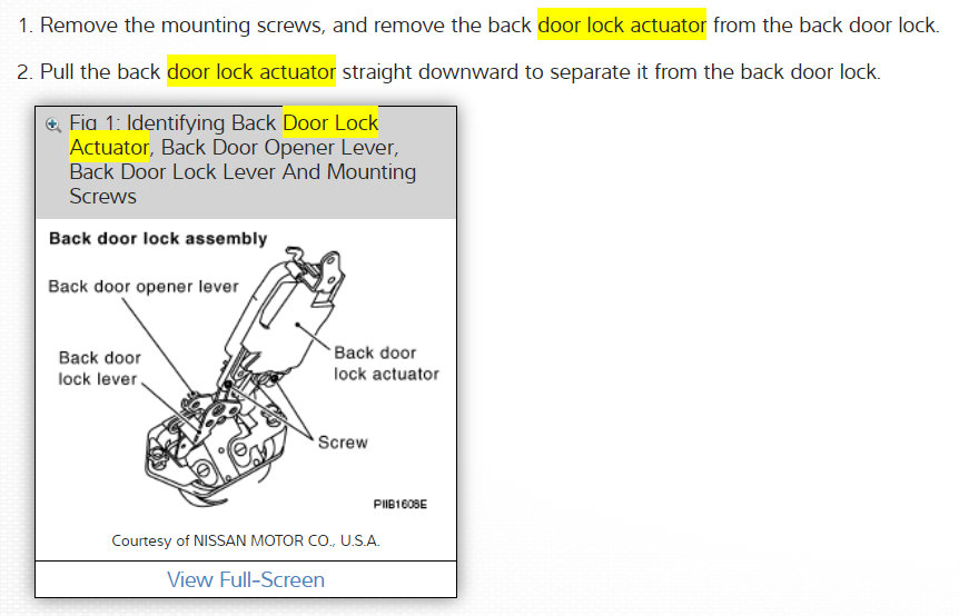

Hello!
As described in the subject line, the problem is the tailgate actuator not responding. However, when i picked it out and tested it with current directly onto the upper contact, the actuator worked just fine.. i have checked all the connections i can find in the rear door, and they all seems to be ok for dirt and corrotion. It is a complete mystery to me -does the rear tailgate actuator have its own fuse?
Furthermore i cannot find any fuse for the centrallocking system at all.
What can the problem be?

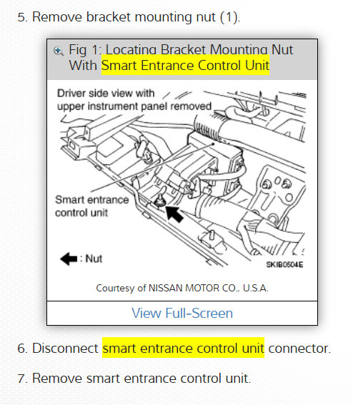

It sound like the smart entry control module is not working. Here is its location I would check the electrical connectors for corrosion and make sure the unit does not have water damage. The module is behind the instrument cluster and can get rain from the windshield on it.

Thanks for this post I had this problem and the shop replaced the smart key module cost me $340.00 but at least it works!

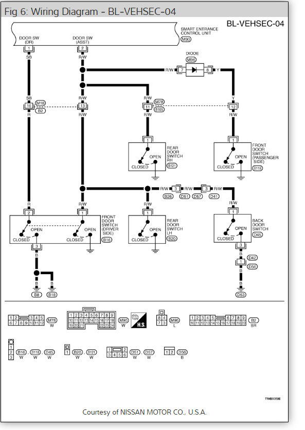

pic attached,for fuses. fix the harness in back as that may effect all lights as well as h orn and check for bad fuses. isn't there a key for driver's door? not real familiar with nissan. the keyless receiver is behind right side of dash also try replacing battery or use a different key fob. check ground on engine an dbattery to body to try tocorrect other problems otherwise have apro look at it.
