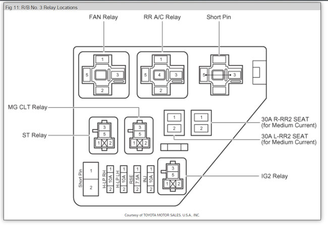

I just replaced the rear door actuator for the rear heat would not work while the front heat would. Once replaced, the actuator is not working. Is there a step that I am missing?

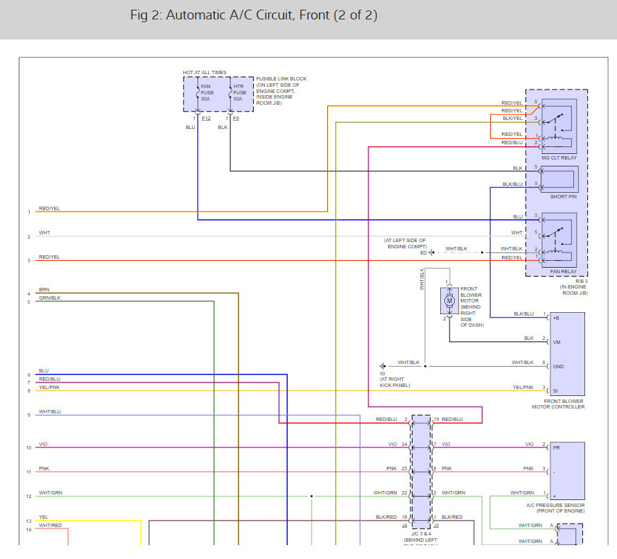

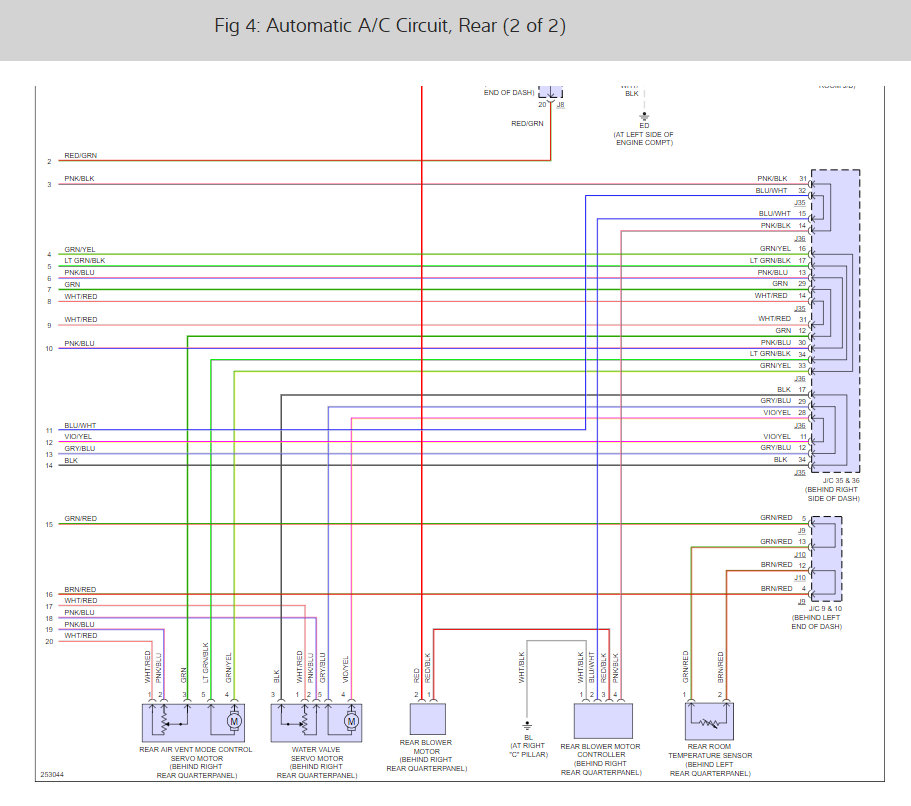

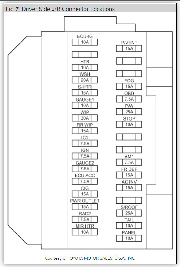

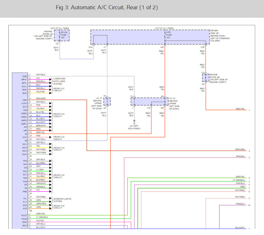

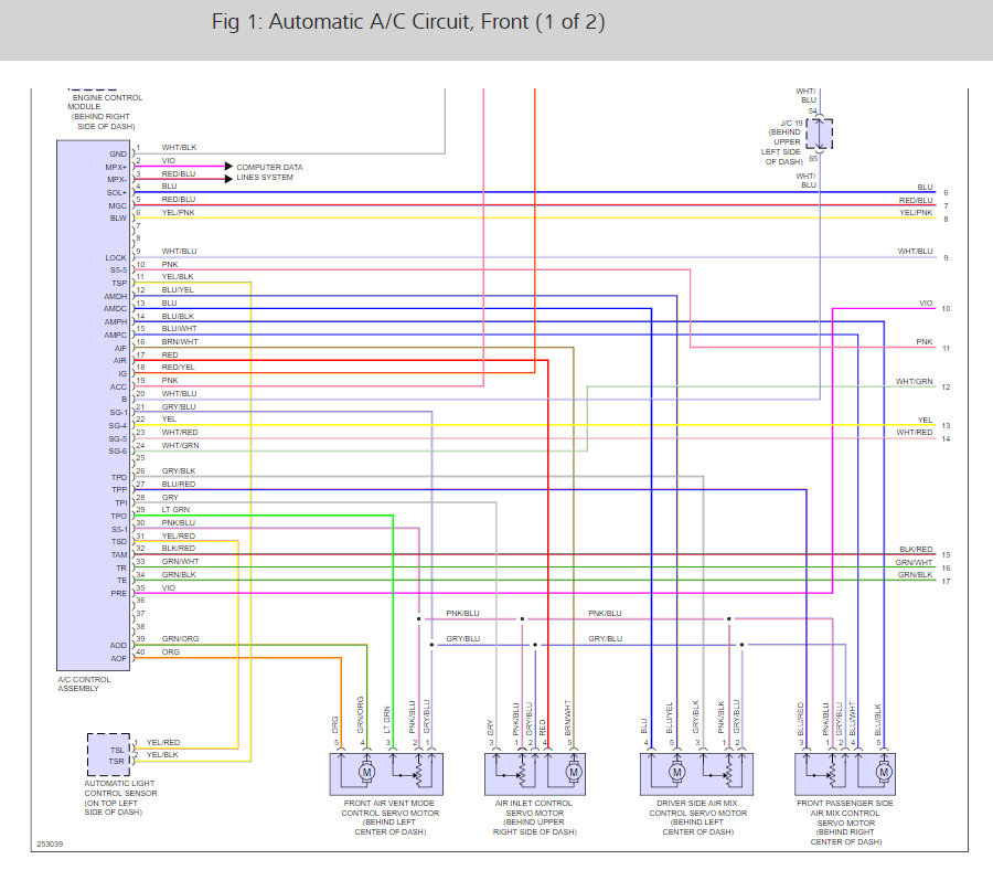

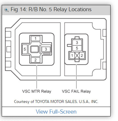

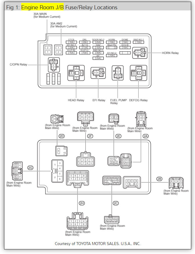

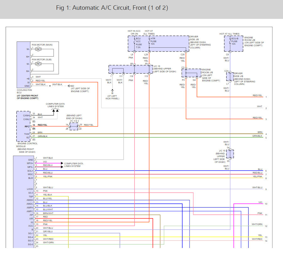

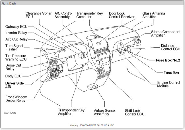

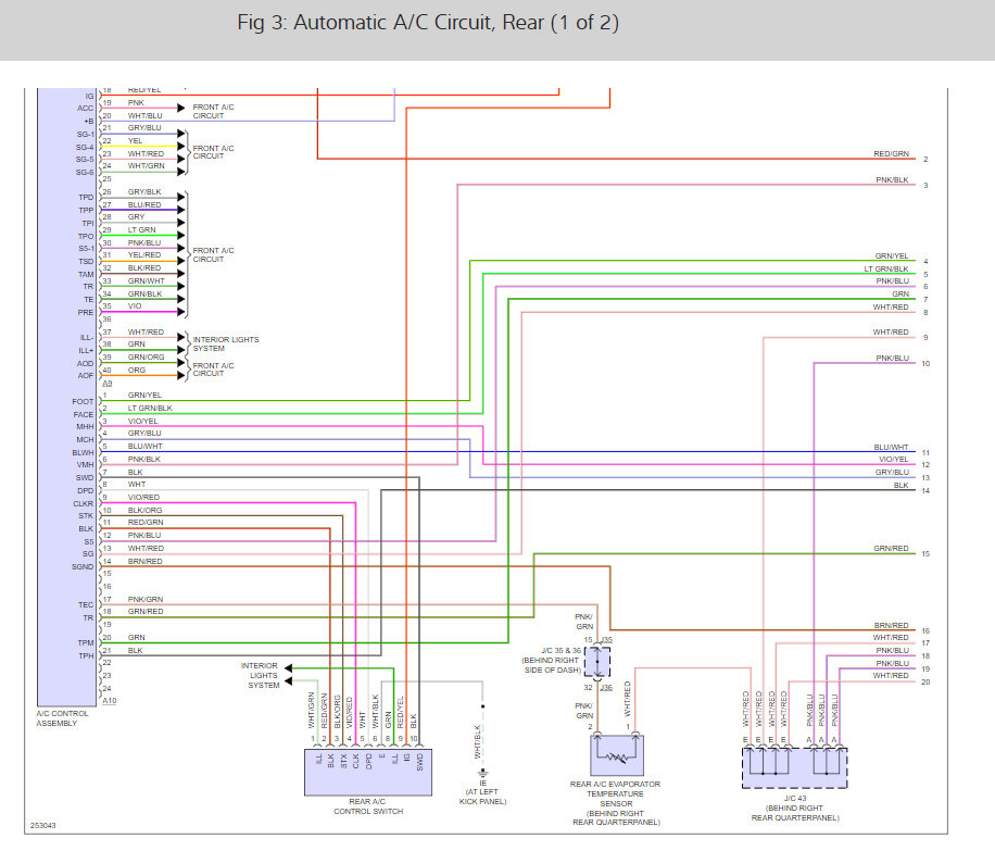

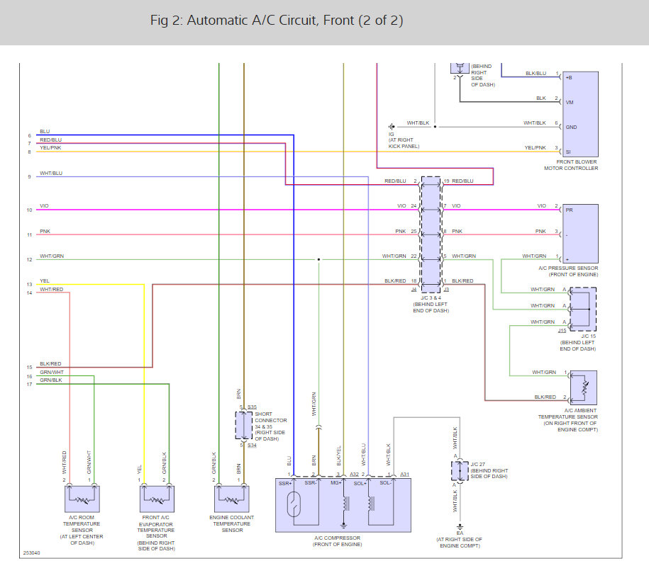

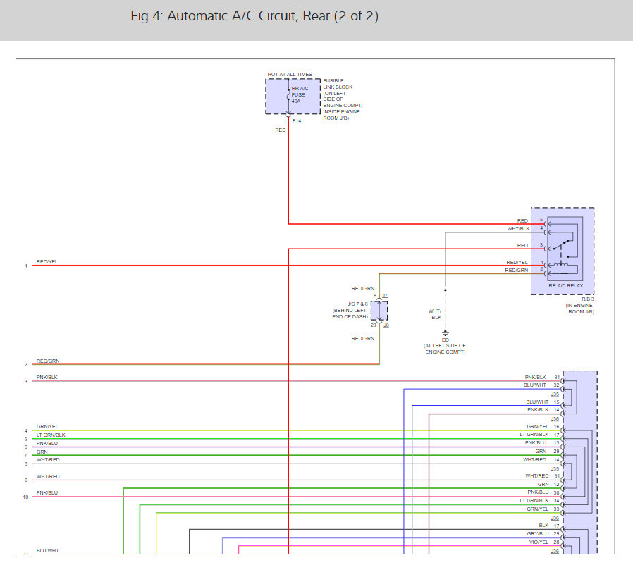

All this started when you replace the actuator can I ask if it is an OEM (factory) part? Here are the HVAC wiring diagrams and fuse locations so we can see how the system works and let's check the HTR, ECU/ACC fuses to see if we had a voltage surge when connecting the battery.
Here is a guide to help us check for power at the fuses.
