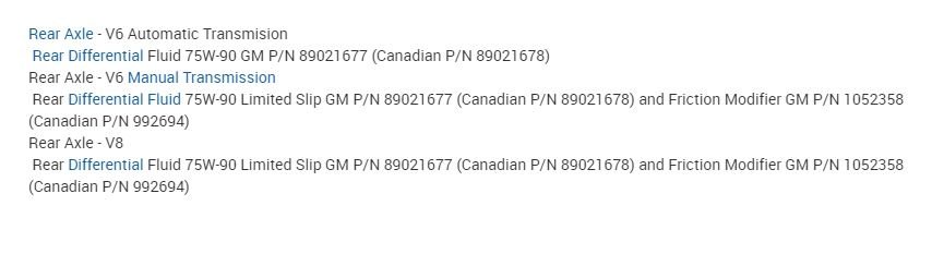

I recently had my car's rear differential fluid changed by a mechanic. After about a week and a half the differential started to produce a whining sound whenever I go through a slow tight turn. I found out from the mechanic that they didn’t add a friction modifier for my LSD. Could not adding this friction modifier produce this problem? Any response would be greatly appreciated.

The mechanic is now saying they used Car Quest full synthetic gear oil 685-32 that comes with a limited slip additive pre-mixed. Is a limited slip additive the same as a friction modifier?

Thank you for the responses, I found out from the parts department that the gear oil they used is actually a top off oil only and is not supposed to be used as the replacement oil, it turns out the oil is too thick for my LSD and the sound I’m hearing is from the clutch plates not being properly lubricated and why I only hear a whine whenever I do a slow tight turn and not when I’m driving normally down the road.

Okay, I would start by changing the oil out of the differential and replacing it with the correct oil. Then add the additive for the clutches as well.
I attached the fluid required for you and the GM part number for the fluid as well as the additive.
