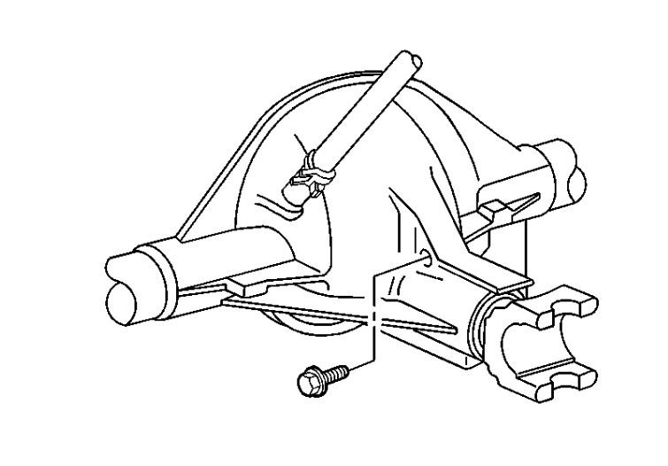

Does the vehicle listed above LT model have a rear differential drain plug?

Good morning,
There is a fill plug but no drain plug.
I attached a picture for you to view.
The back cover has to be removed to drain the fluid.
https://www.2carpros.com/articles/differential-service
